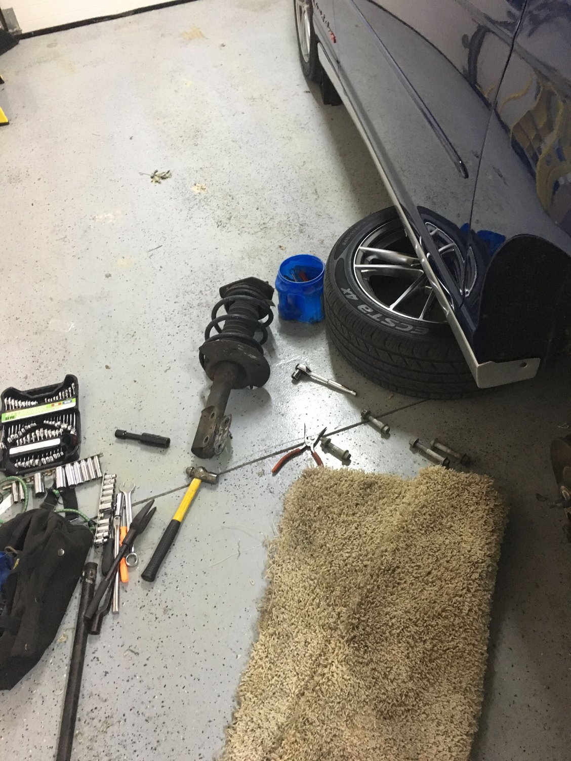

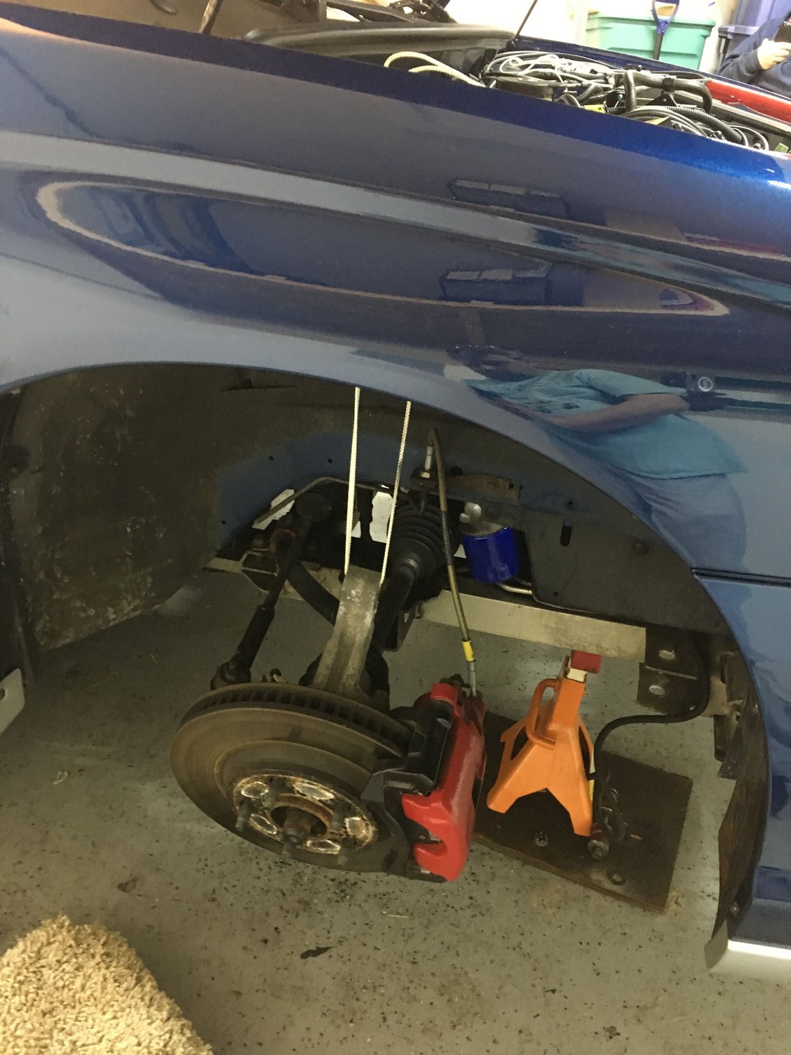

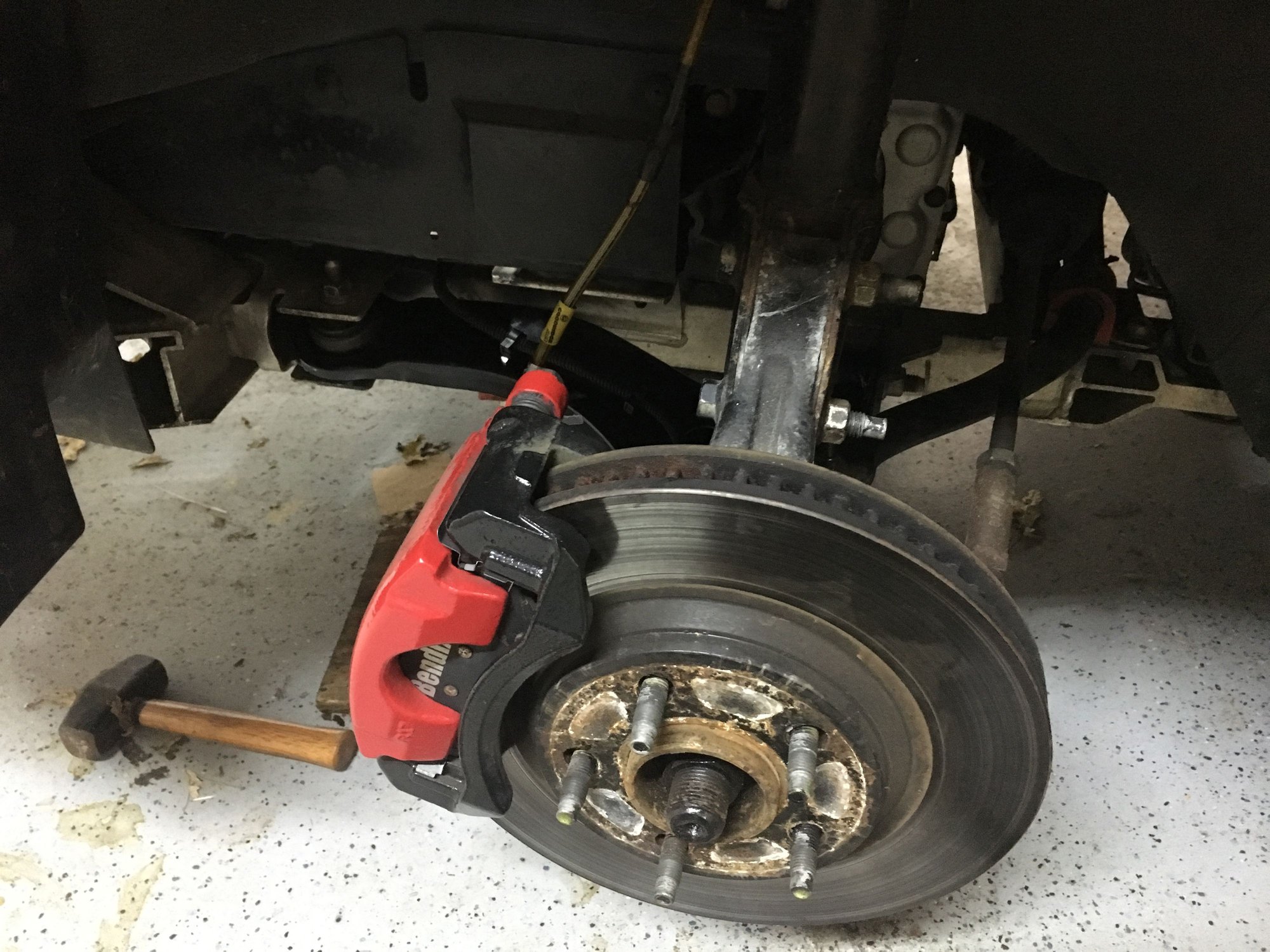

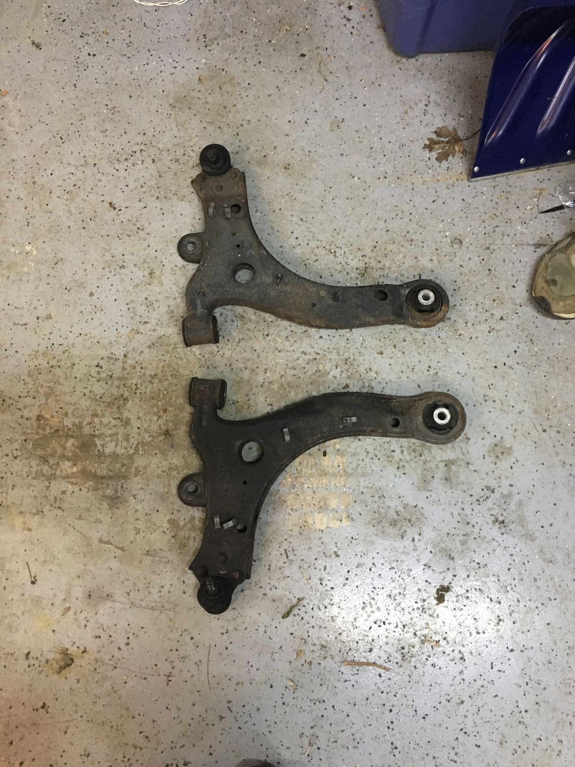

Admittedly, after getting the car back together, going 4 hours to the Michigan meet and 4 hours back, all was fine. Now that I am home... I have a noise from the front passenger side wheel to to research and resolve (I am hoping it is a matter if I need to tighten something, but I need time to get under with some wrenches).
But, all that aside.... I ended up with:

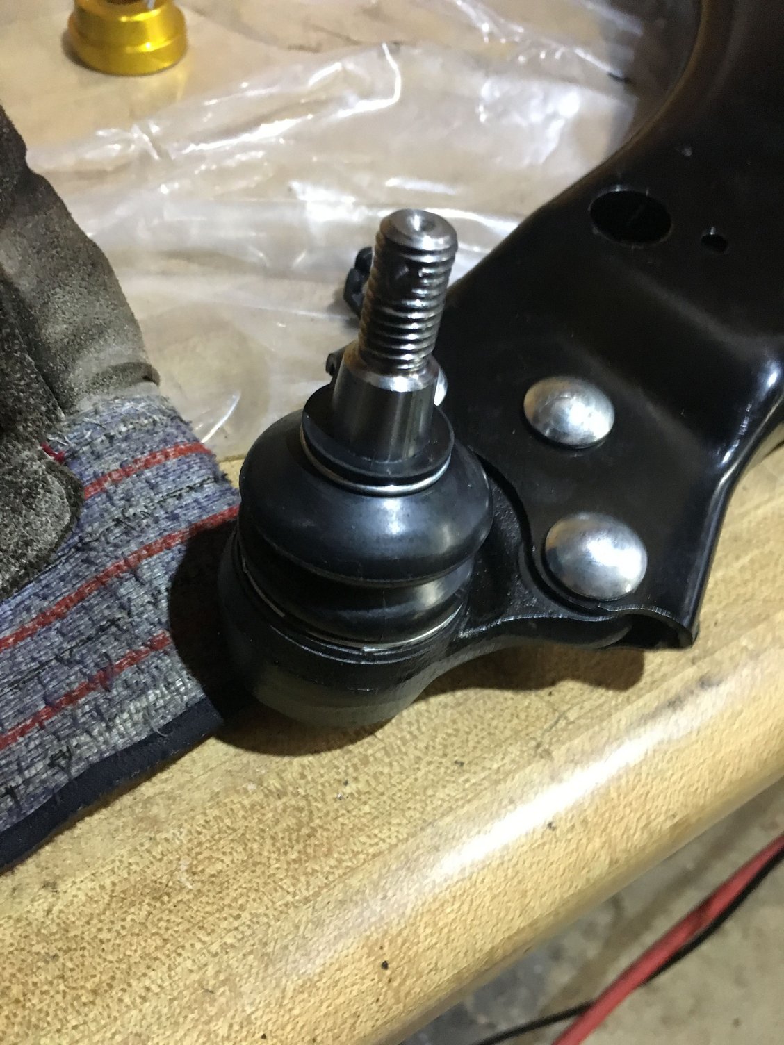

- Dorman control arms
- Moog ball joints (as I don't know how good Dorman ball joints are).

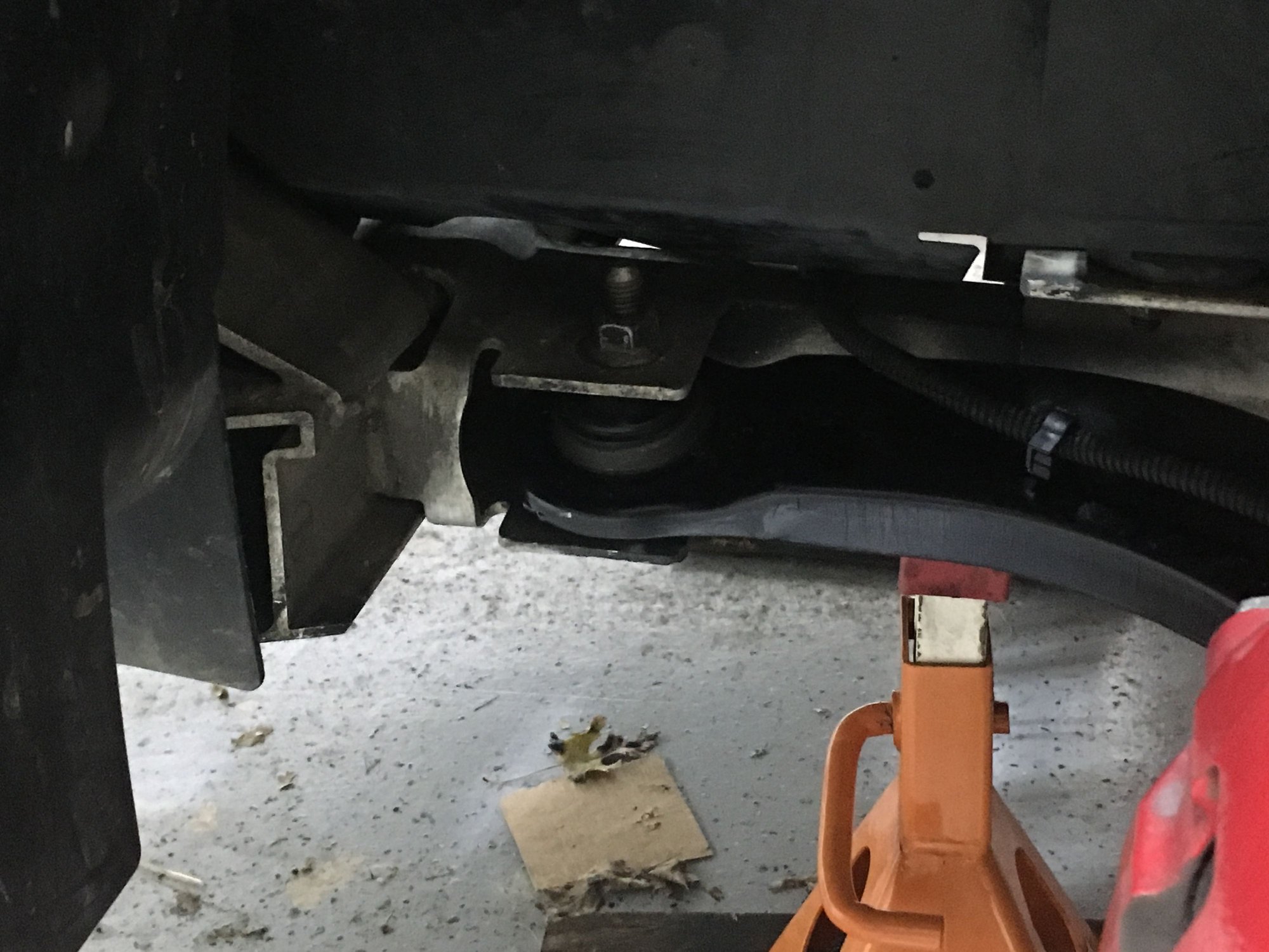

- Moog vertical bushing K200787 (this is NOT a rubber bushing, it's a ball and socket design).
- I stuck with the Dorman horizontal bushing as I did not like the fit of the MOOG poly bushing.

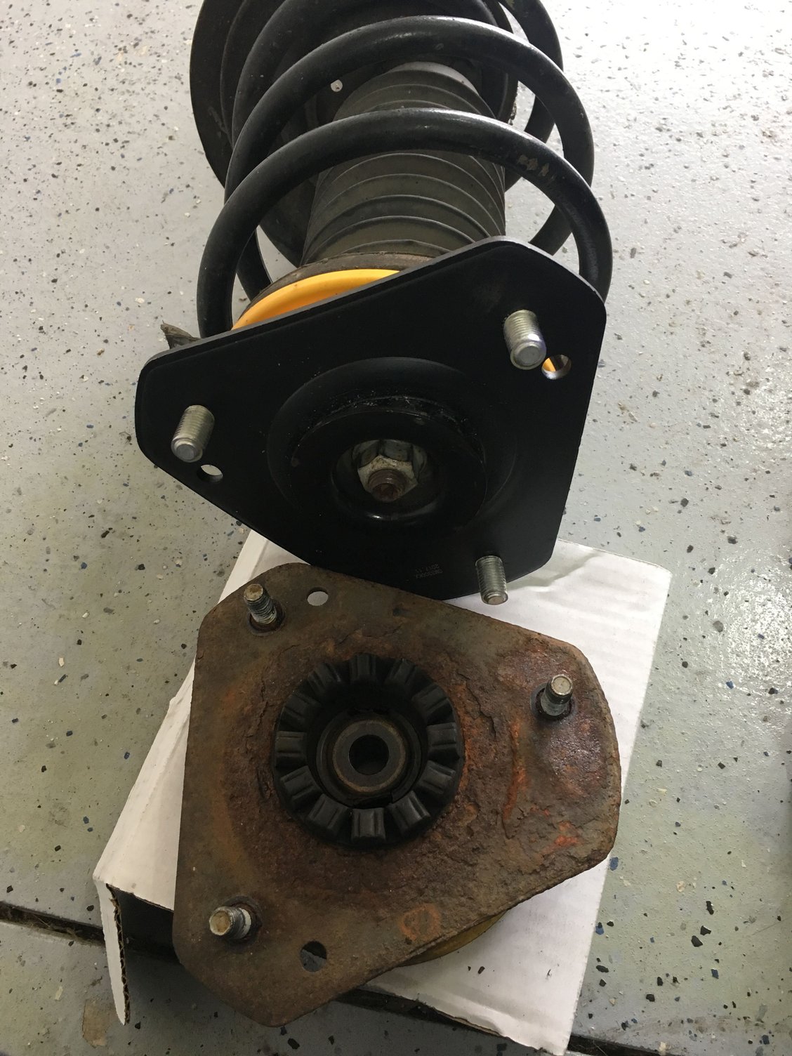

- I also pulled the front struts to change the front bearing plates (tired of popping the hood and seeing some rusty strut plates, now, nice new and black).
Something I want to point out about the Dorman arms vs my factory original arms. On the opening for the vertical bushing, Dorman has 4 small welds to hold the two pieces of steel together. The factory ones do not have any of those welds. I believe that simple change actually adds strength to that stamped steel design.
And drilling out the rivets without a drill press and using a ball joint press to get the bushings in, you get quite the work out!!
I admit, for the strut plate swapped, I took the struts and new plates to a friend's shop and let his guys do that (they have a better and safer compression tool to do the job than I have access to).
And below are some pics.
