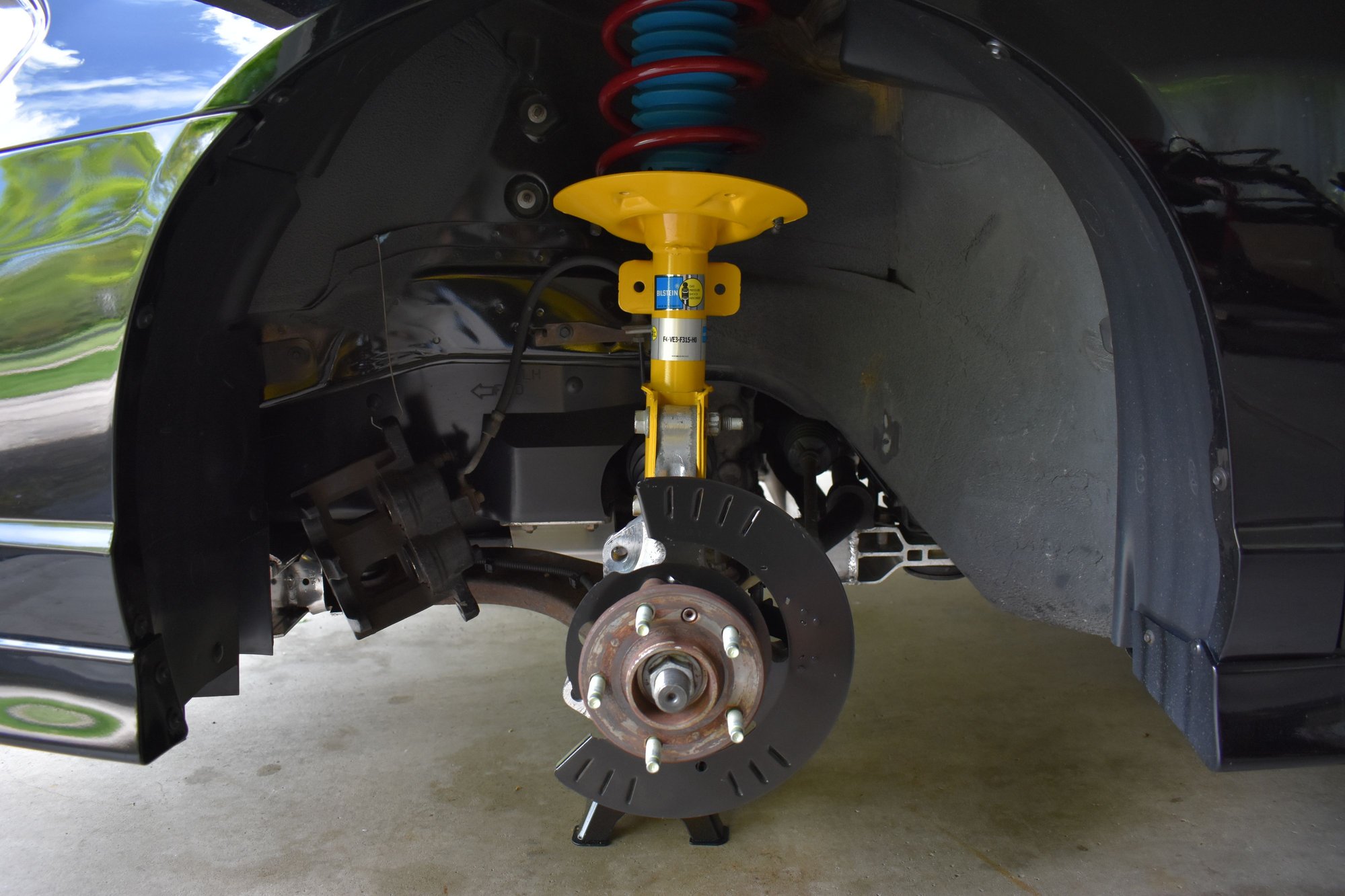

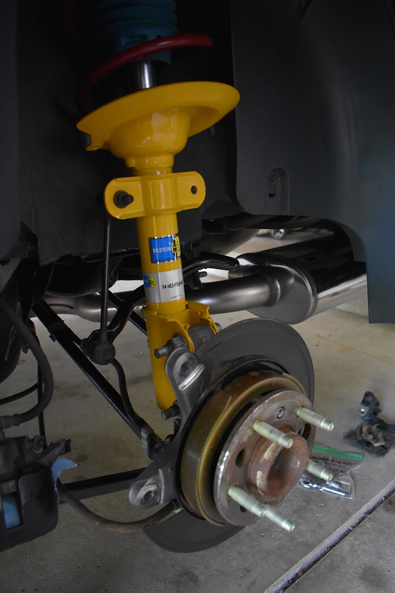

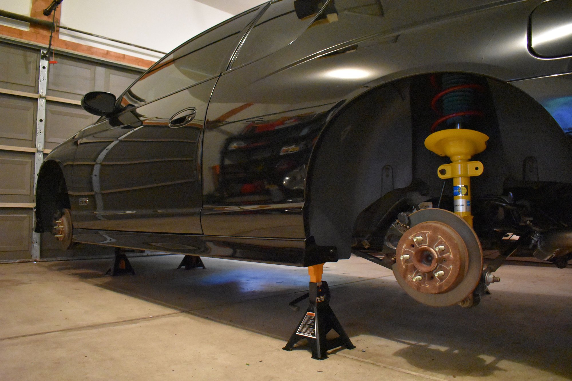

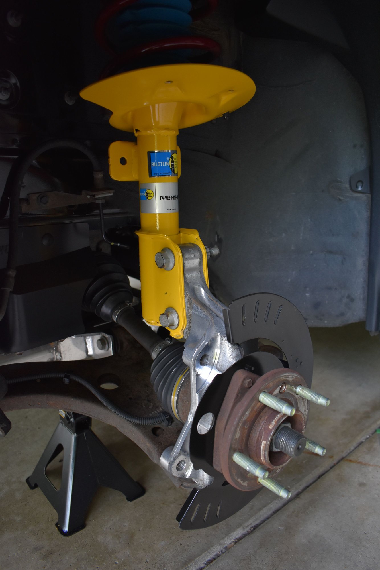

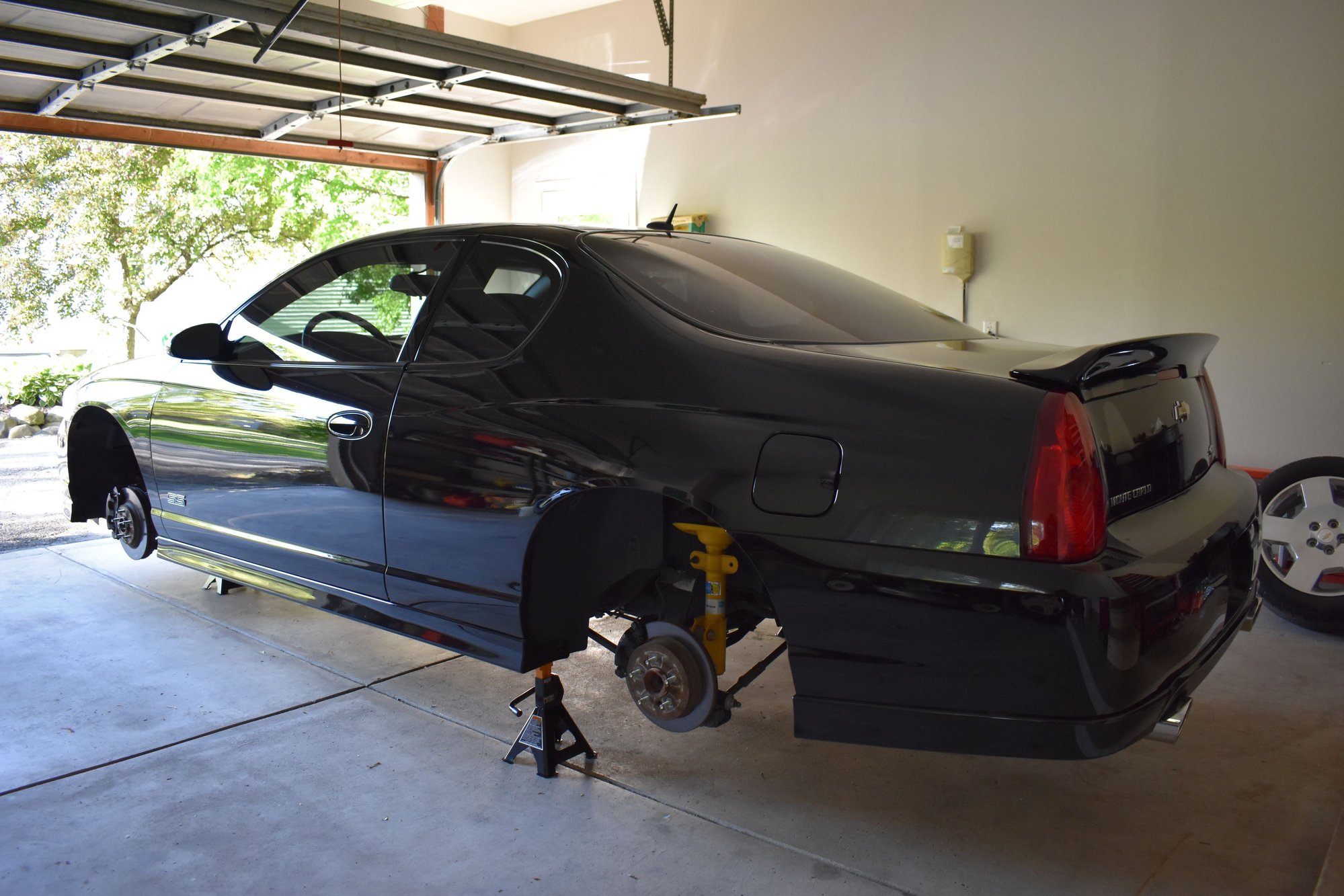

Here’s a few shots pre-disassembly.
And a few shots post-disassembly. Driver side rotors came off relatively easy, passenger side were a pita especially the front but eventually were off after some Liquid Wrench, taps and persuasion. Everything here is factory original except the strut assemblies and exhaust - those have roughly 15k miles on them. I took the time to clean up and detail as much as I could in and around the wheel wells which will also make for a clean environment for painting the calipers since I’m not removing them from the lines. Once the brake work is finished, I’ll be continuing under the car with a full undercarriage detail.

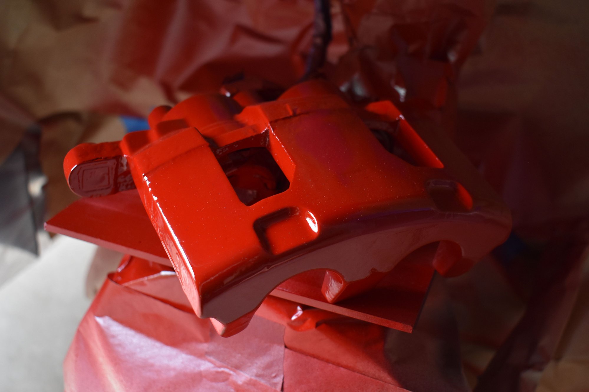

I will be starting reinstall today. For now, here's some progress up til yesterday.
I realize it’d be a lot easier to paint the calipers off the car but, going into this project, I did not want to remove them from the car and deal with brake fluid. So I masked off the entire car, the wheels sitting off to the side and as much of the garage floor and other stuff as I could. The overspray with this aerosol is ridiculous but I prefer it over brush-on because it applies a lot faster and IMO covers better and gives a better finish.

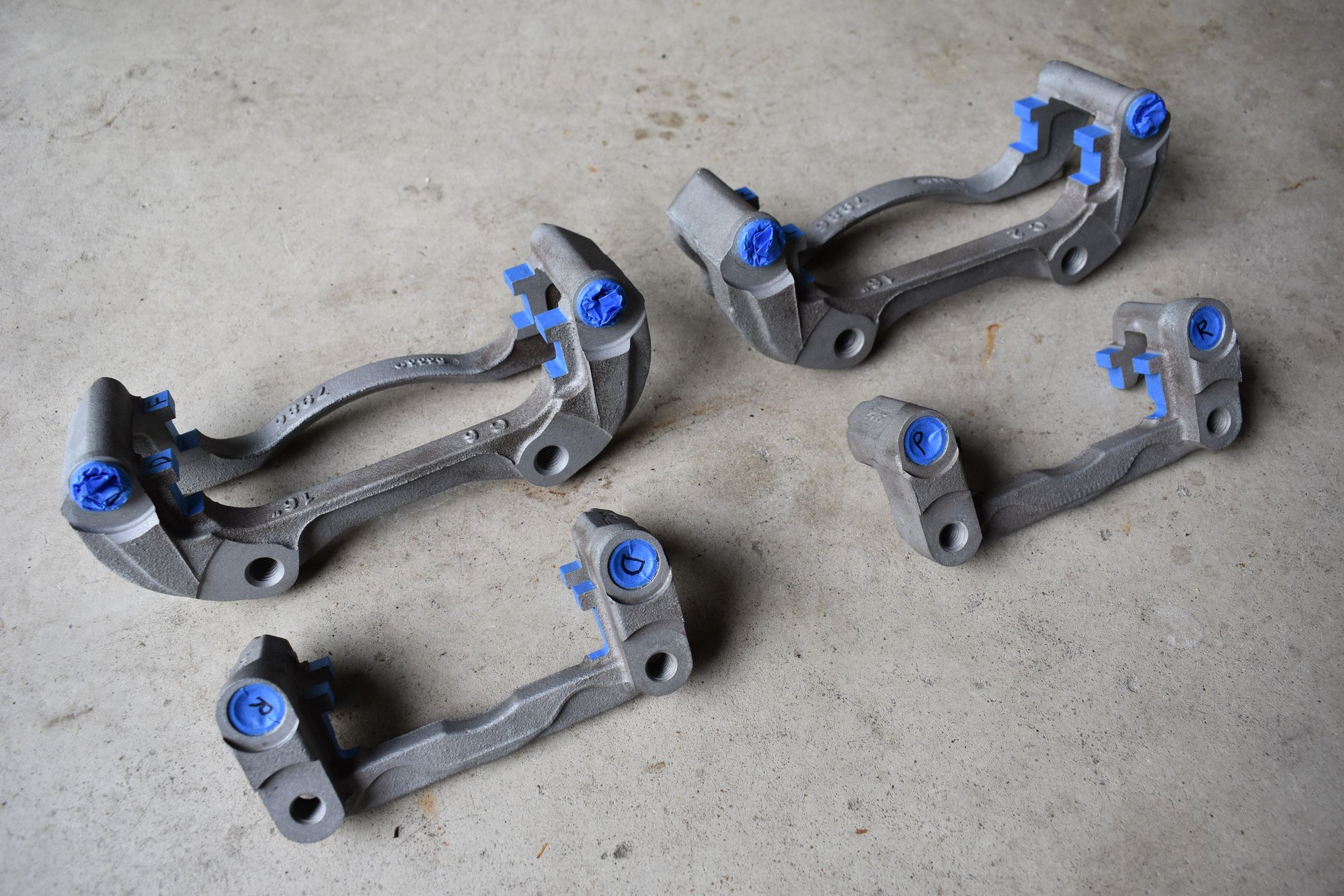

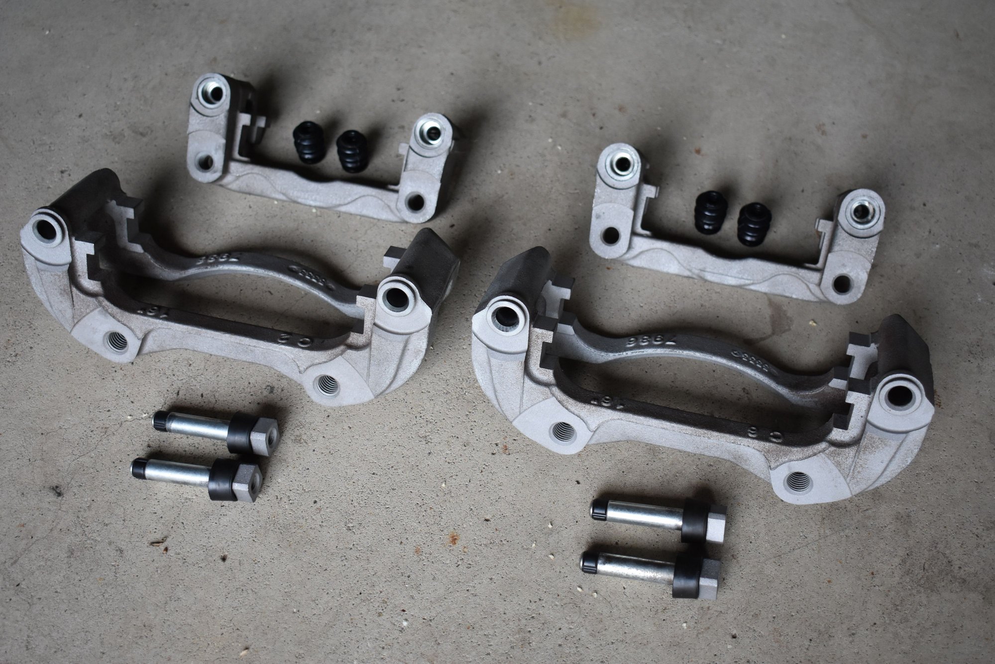

I had a friend of mine sandblast the caliper brackets back down to bare metal and also did the exposed head of the pins for the fronts. Once back I cleaned and masked the pin holes and where the pad retainers seat.
I fully sanded the calipers with 220 grit, cleaned and masked where needed. I shot some Eastwood rust encapsulator on them where needed before the finish coats. Red paint tends to not cover well, especially over lighter colors, so the brackets took 5-6 light coats to adequately cover the bare metal. The calipers took 3-4 coats. Exactly two cans of the Duplicolor red caliper paint was what I needed to do everything.
