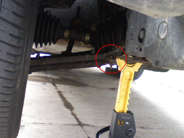

It depends on price of a new control arm and condition of your control arm if you want to full replace it. The pics below are from my old '94 Grand Am in 2009. My control arm rotted around the vertical bushing and when making a left turn, allowed the car to turn into the steering wheel. I had to replace the arm, the CV joint (it was over extended and pulled the boots apart, making a grease mess), and the car pushed the fender into the wheel (note the damage at the lower fender). I never replaced the fender (car was too old and rotting bad at that point, granted a month prior I changed the head gaskets on it at 180K). Wish I had seen that one coming to prevent it.
