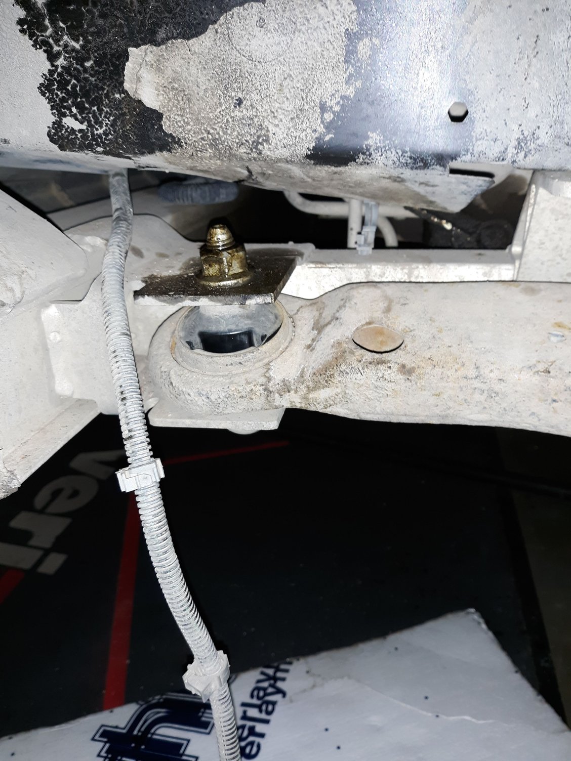

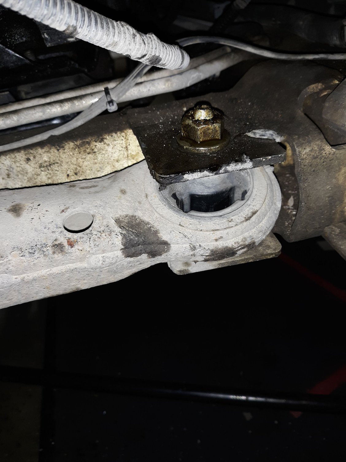

I replaced my control arms last summer. I bought Dorman arms (and I like some of the construction better than the original arms and some other after market arms, such as some extra welds in places). But I replaced the ball joints with Moog (which also had grease fittings). I replaced that vertical bushing with an updated design from Moog (a non-rubber one, this type works much like a ball joint). Drove the car half the summer with that and all is good. Then parked for the winter.

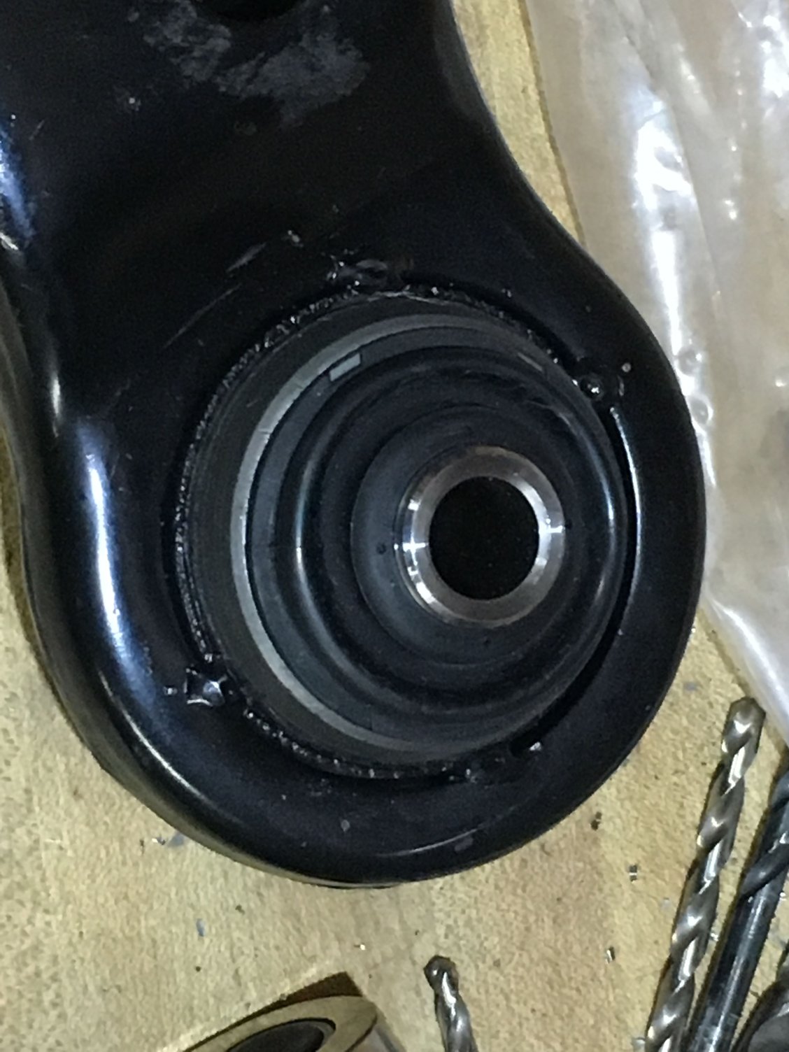

Old Jan 21, 2020 | 09:06 PM
Here are some pics from what I did. And pics of the Moog bushing that I said is "like" a ball joint.
