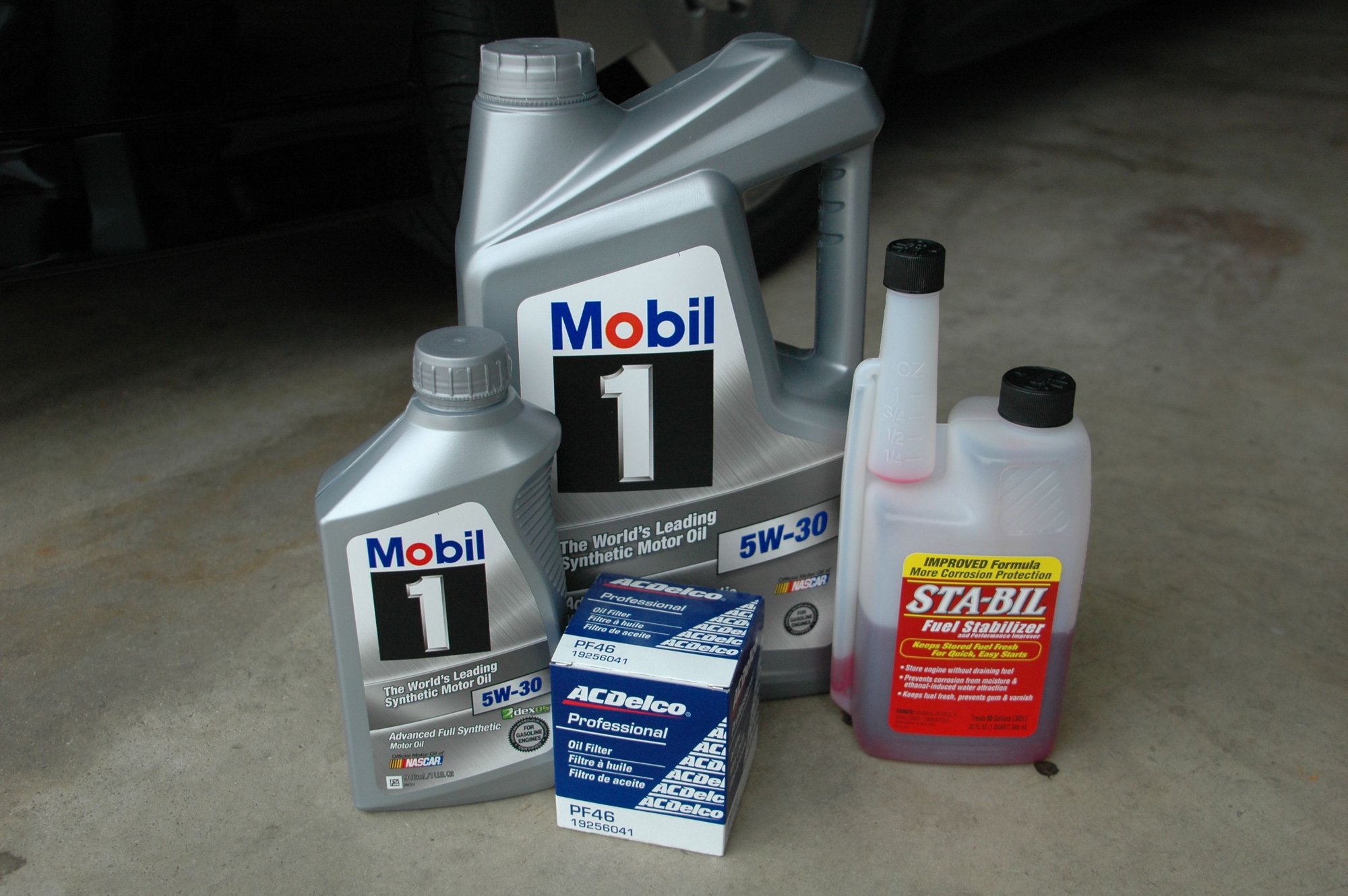

3. Change Oil – I always do my oil change BEFORE storage so the old oil isn’t sitting in the engine for an extended period of time. Old used oil contains acids, moisture, etc. which can be harmful to certain engine components. The new oil will be okay sitting over the winter and there is no need to change the oil after putting the car back into service in the spring. The other pro to this is I can just roll out and go in the spring without needing to do anything – easy peasy.

5. Add Fuel stabilizer – Mine takes about 6-7 ounces of Sta-Bil to treat the full tank. I add my stabilizer AT the gas station before I fuel up. This allows the stabilizer to mix with the gas and then circulate through the entire fuel system (fuel filter, lines, injectors etc.) while driving home.

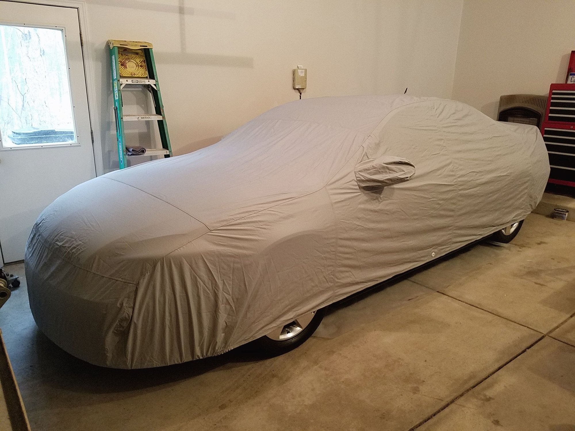

12. Cover – Once washed and in its spot, I typically allow 72+ hours for the car to air dry. I don’t like to cover immediately after washing because that lingering moisture then gets trapped under the cover. Specifically, the spoilers on these 6th gens hold a LOT of water under them - pic 12a shows remaining moisture still trapped under spoiler after six days of sitting with trunk lid fully open (I hit this area one last time by sliding a paper towel under it a few times). Once dry and before the cover goes on, I do a final dusting over the car to remove any debris that’s landed on the car while sitting. Never cover a dirty car as it can significantly scratch the paint. And I recommend not removing and recovering the car more than necessary as that can also scratch the paint.
