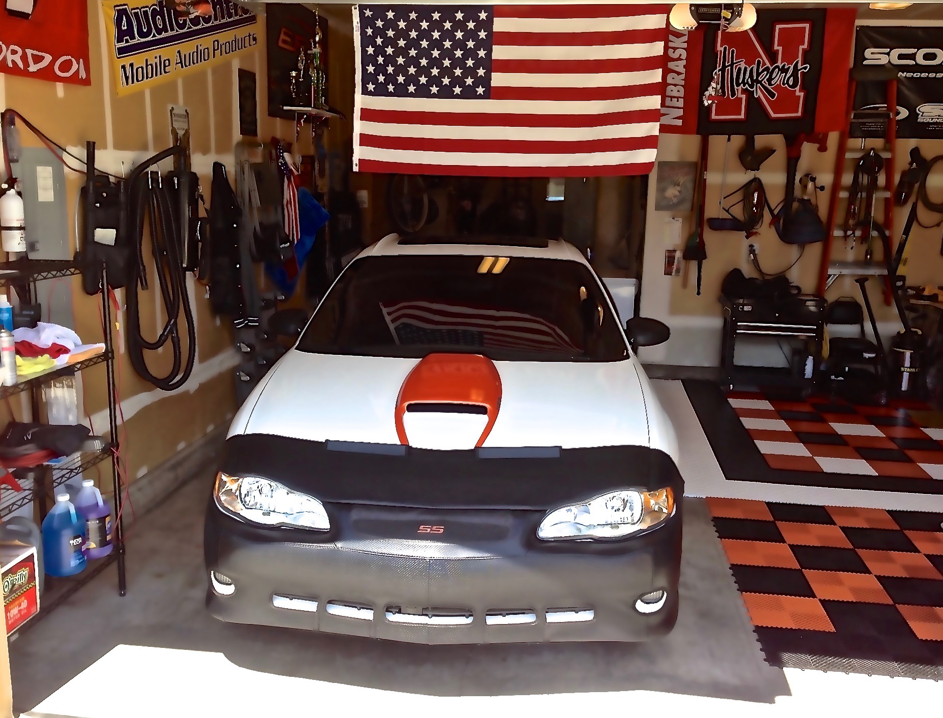

Okay with mine wax the car do the christmas parade while I am in town I change the oil, fill that tank put fuel stabilizer in and then drive it 30 miles home. I do that to get it the stabilizer in the system. Once I get home I wipe the car down I put the bra on (we don't salt or sand here we use Red cinder on the roads so small Rocks) I put the bra on so its already ready for the first show of the year drive in April. Next hook it up to my CDE battery tender put a car cover and she is down for the next 4 months
