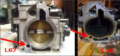

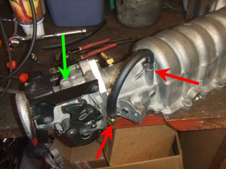

Now, below is a pic from the Bonneville thread. He adapted the spacer plate to use that vac port I pointed to above and direct it out to where he can then connect it to the nipple on the L26 UIM (as seen with the red lines in the below picture), thus, solving the problem with the vacuum issue.
If you look at my green line in the on the throttle body, I cannot CONFIRM this (as I have not studied this specific problem), I suspect Hitachi designed that as a vac port for a different application (yes, our T-bodies are made by Hitachi). I speculate (again, it requires verification) that you could drill that, put a fitting on it and it might be a HECK of a lot easier to remedy the PCV vac issue. But again, some research that I have not done would be required.
Hope the pics help
Posts: 12,607
FYI - I know it's late, and I'm about to go to bed, but I was just in the garage. I have an extra L67 T-body (in pieces) laying around my garage. And I looked where I pointed a green arrow as a possible connection for the PCV system, that *should* work. That is in fact a plug for an opening right before the throttle plate and after the MAF!! I can see the hole on the inside of the T-body for it, so you can probably drill the plug that is in there, pull it out and I'd be tempted to fill the old one with epoxy or JB Weld.
And even though I looked at an L67, the L36 should be enough identical that you should see the same findings I did!! I could confirm it, but I don't want to go digging through boxes to find my original L36 T-body.....

And I now see what yall are saying on the top UIM nipple. Where do the GP's originally have that vac line running from? Cus I was thinking I could just get a hose on that top nipple and maybe connect it on my air intake elbow somehow, that should give it enough breathing air I'm guessin
Or Maybe I can come up with something else like that pic Jason posted. Where it's ported on the adapter plate
