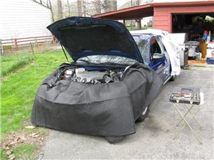

I bought three of them when I did all my mods in spring of 2011 to protect the paint as I leaned into the car to do my work. As seen below:
You can tuck those blankets into the crevices around the engine compartment to "hold in". I think better then any "fender" bib type thing I've seen. Covers LOTS surface area.
Also add to the list new Fel-Pro aluminum LIM gaskets, a new UIM gasket.... Heck, I'd really consider doing the head gaskets (the replacement motor is out of the car, give it as clean a bill of health as you can). With the heads off, you could easily replace the valve seals too (something I wish I did on the Grand Am, but did not think about).
