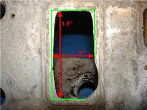

BTW - looking at your dremel kit, the grinding stones will NOT work on the LIM (they will cake up with aluminum). I used a variety of bits to get the correct angles and such. If you expand the ports on the LIM, DO NOT match them to the gaskets unless you are porting the heads! Otherwise, you will over do it and create a "step" you don't want. That pic I sent you is what you want to change (and of course follow that change into the runner). But do not change the corner at the injector boss (check my web page link at the bottom if you want to know more, I explained a LOT of this and more).
What I used was a bunch of different carbide bur bits (and NOT the little engravers). The ones I used for the ports were cylinder and cone shaped. But the runners I buzzed with spherical ones and bullet shaped ones.
I not just port matched my LIM, I plugged the holes for feeding coolant to the t-body AND I expanded the coolant bypass. I have a bunch of pics and explanations. My dad plugged the holes on his '98 Grand Prix (to avoid buying a new UIM), but did not expand the by pass, no problems seen.
