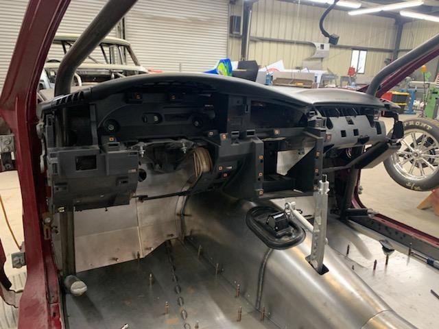

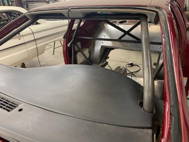

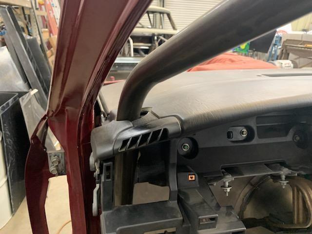

Old Mar 19, 2021 | 07:48 PM
  #168
Monte SSV's Avatar
Posts: 535
From: Southeast MI
Default New pix
A little dash work
