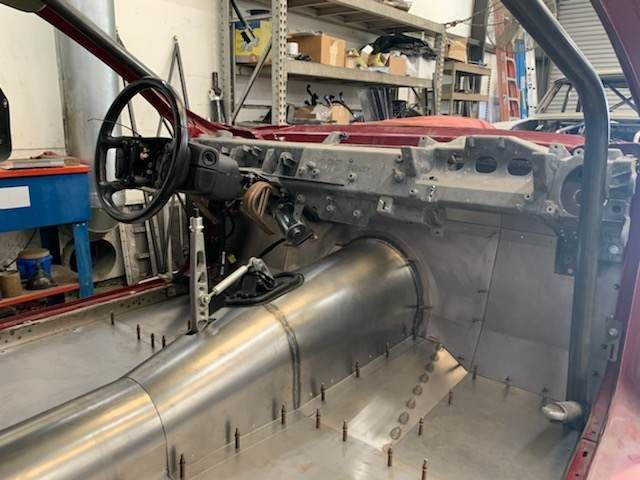

Default More
These are the most recent but not the best. Phone to phone to here. Best I could do for now
Long way to go there bud. You going to run a 4 link? Glide? Chute? Super Gas? Or just have fun.....
Post #87 has some good pics of the rear suspension if you wanted to see the suspension layout. Looks like a really nice setup.
Glide?
Its a 6 speed manual (T56/TR6060/T56 magnum?) with a sequential shifter on it. Pretty cool looking setup. I could've swore he'd previously posted some pics of it but I couldn't seem to find them up there for some reason.

The rear suspension is a triangular four link, The tranny is a 6 spd Tremec with a sequential shifter - Bumping96monte is correct and all those pictures should be somewhere in this thread.. The car will have a removable chute and wheelie bar(s) - removable because I do want to have fun and driving it on the street with that equipment will draw way too much attention. The intent is to have all that bolted to adapters under the car and out of sight.
And I do have a long way to go, but I am in no hurry - it will be done right and the way I want and it is a wonderful contender for the top of my bucket list!!

Not sure about your tranny choice. Most with very fast cars run Lencos, but maybe it will work
You can weld up a bracket on your rear end that accepts a bolt dropped in front the top. Gives you a place to attach the chute. Just drop a bolt in. You can use detent pins on your wheelie bars with pull rings. Makes like really easy getting them on and off.
