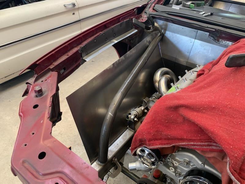

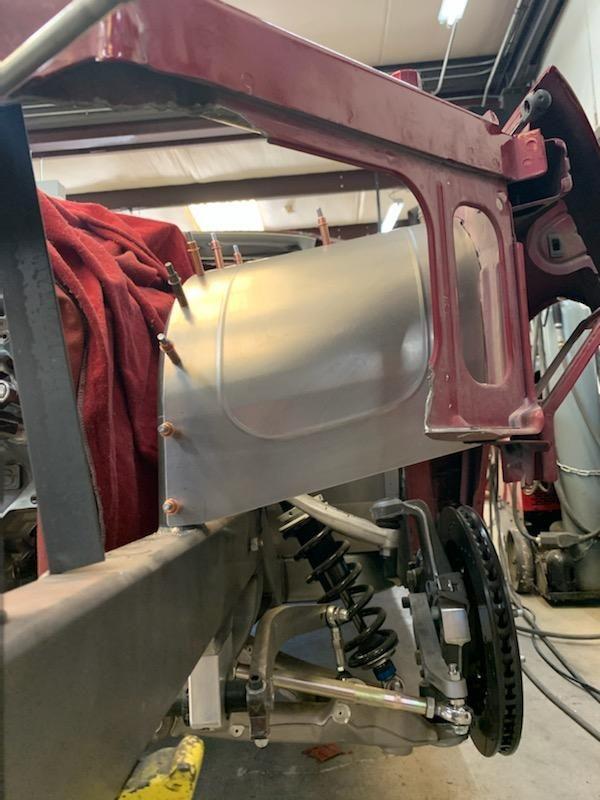

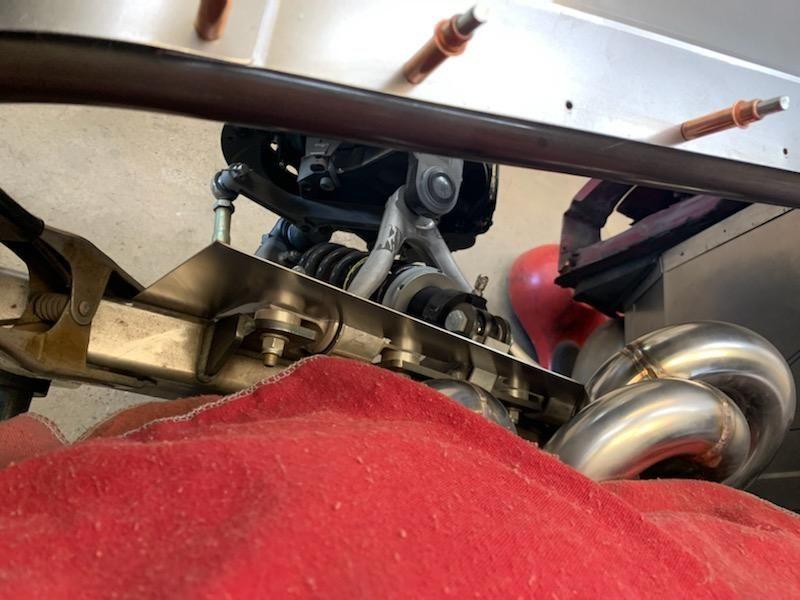

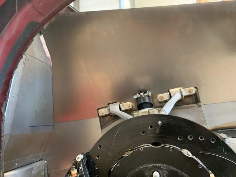

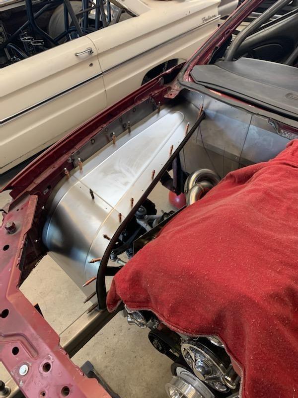

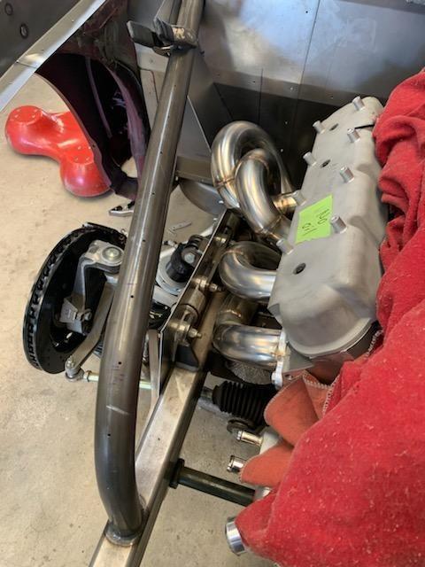

Well my fabricator is back at work. Half speed but nonetheless progress is being made. Gray ghost. Yes Orings still standard issue with blowers.
