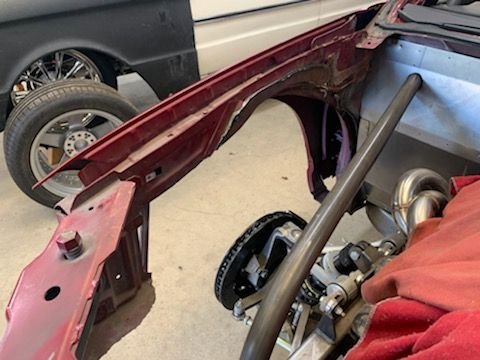

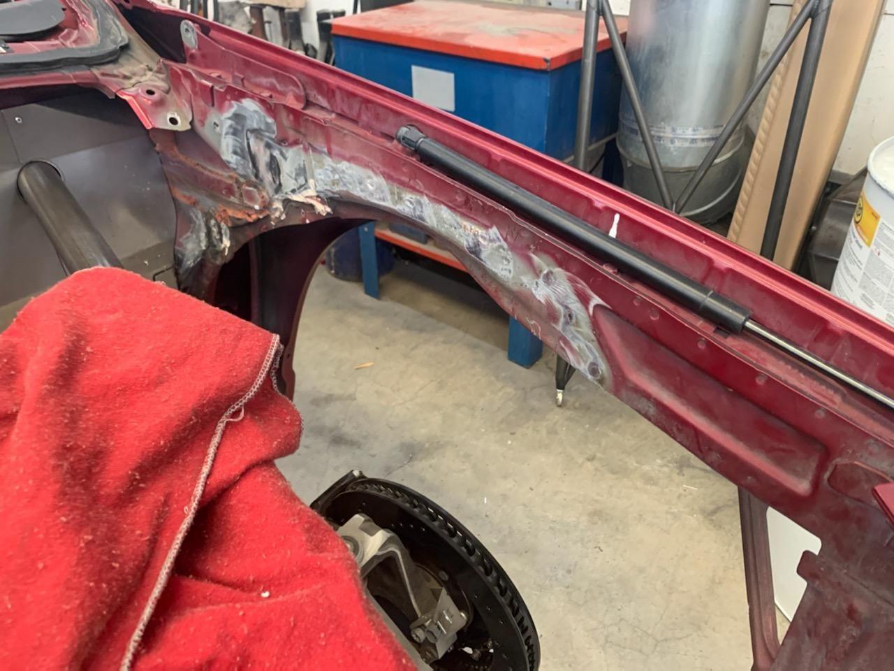

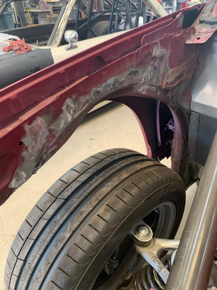

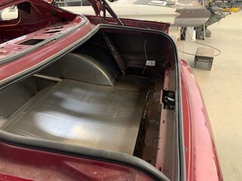

More tin work And fender clean up

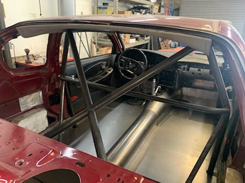

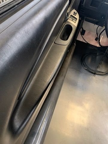

Old Apr 1, 2021 | 11:14 PM
  #173
Posts: 6,471
Sure aren't going to get a nicer fit than you've got on those door bars. Looks like they're doing an excellent job!
