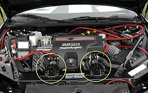

Engine Strut mounts is good I just replaced mine. They attach to the Front radiator support and the engine. 4 pieces if you do both of them.

Welcome to the forums , the engine struts are a wearing part. Basically a rubber and steel mount that absorbs engine torque, rubber gets detererated and allows excessive engine movement.

I attached a photo and circled the Strut mount in yellow. get them at Rock Auto dot com and put them on yourself for about $50.00 all 4 items.
