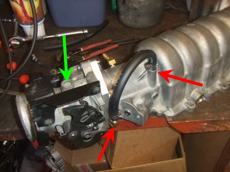

On the top of the L67 and L36 TB is a port that is plugged and just like the port the current PCV system uses, this port is PRE throttle plate both after the MAF. Just open it, tap it, put a 90 degree connector on it and you can go then hook up to the nipple on the UIM. Should be REAL easy (coming from the guy who has NOT worked with an L26 UIM).
No need to mod the adaptor plate. BTW - I don't think your plan to drill through and join the port on the TB to the UIM the way you mentioned will work. The "plumbing" for the PCV system on the L26 UIM is not there like it is on the L36 UIM. That will probably result in a messed up/uncontrolled idle.
Here's the pic from post 144:
Take the green arrow, join it to the nipple on the UIM. PCV system should be solved.
