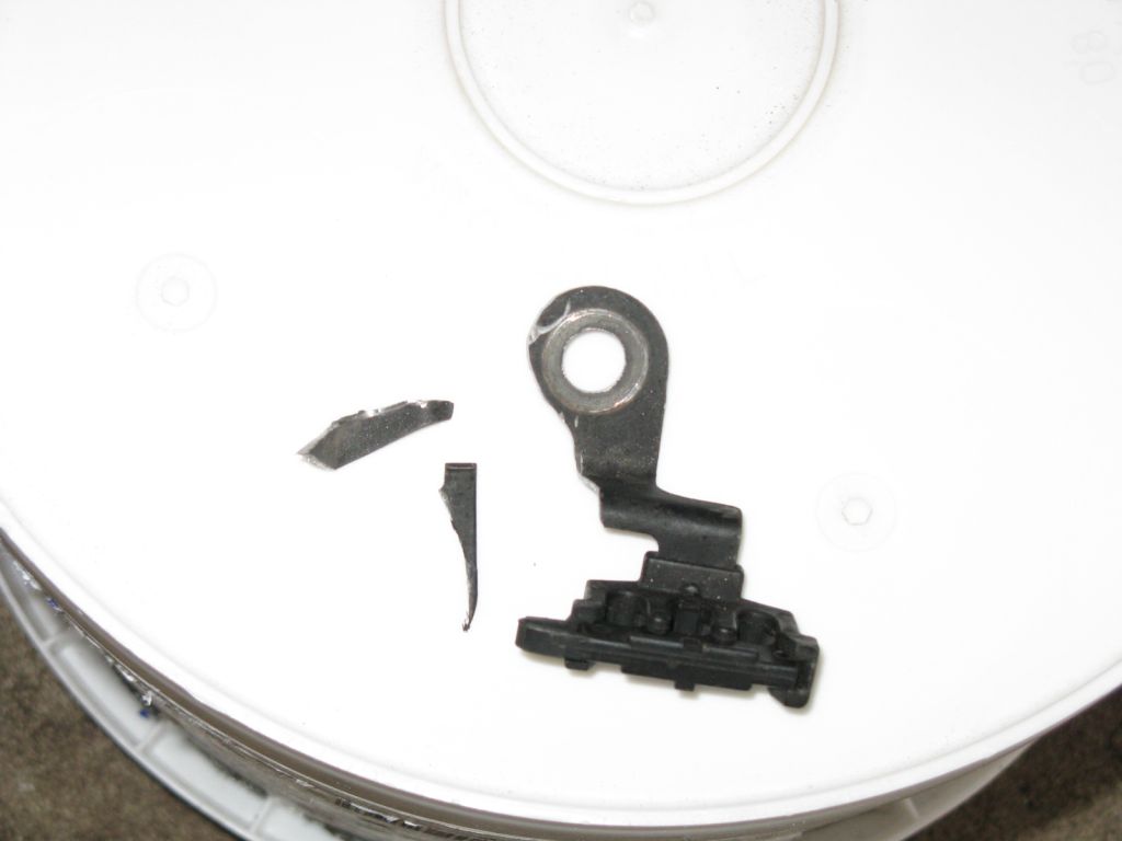

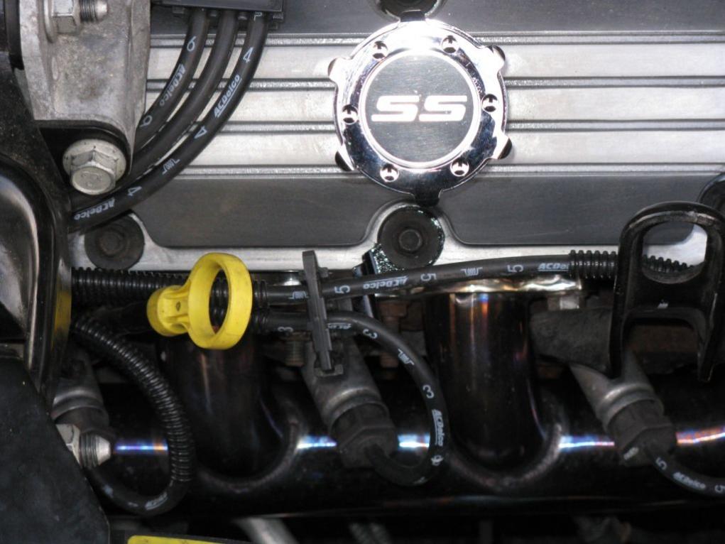

I finally pulled pics off my digital camera.... Since I switched from the plastic/fiberglass valve covers to aluminum ones from a late 4th gen F-Body, I lost the nice guides that would hold the plug wires. Now, these are the stock wires with 62K on them, they actually hold their shape pretty good, but that was NOT good enough for me.
I was going to by a cheap wire seperator kit (only for like two pieces), but before I was going to head to the parts store, I decided to check my spare Grand Am parts. As luck would have it, I found a 3100 v6 wire seperator that with a little work and a spray of paint was PERFECT!! I looked at it on the car, used the Dremel to remove a section of the original hanger then primed and painted.
One thing I did find.... When I put the valve covers on, I use all new gromets. With the wire seperator between the gromet and the washer built into the valve cover bolt would squish out when torqued properly. The rubber of a new gromet was really soft for this application. To avoid a "funny" look, I re-used an old gromet on this bolt (it did not appear to be dry rotting, but due to age and heat was not as soft and held it's form MUCH better when torqued down).
Bottom line, thanks to spare Grand Am parts from me helping part out a couple 3100's, I had a free fix to my plug wire issue!!
