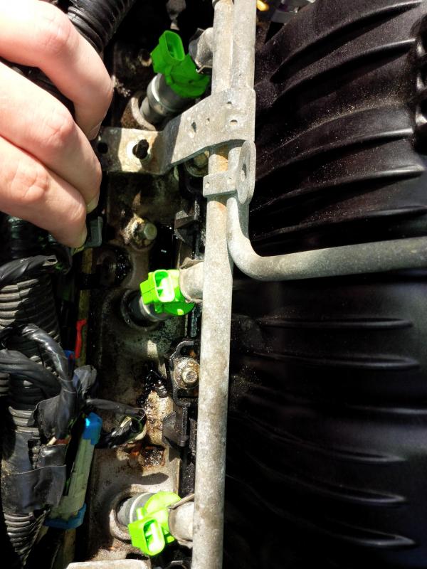

Long time since an update here.
Still working on getting this car 100%. I was able to pick up a set of LSJ injectors for nice and cheap. Went to put them on and they were too short.
Found out the hard way that the Grand Prix 98-99 fuel rail is different than mine, and Jason was able to find me a 98 Grand Prix fuel rail.
Just yesterday, I was finally able to get my new injectors on the car. So far so good, not part throttle KR like I was seeing previously. Still needs some work on the tune I'm sure, but this week is going to be quite rainy. Gotta get out there and get some good runs logged.

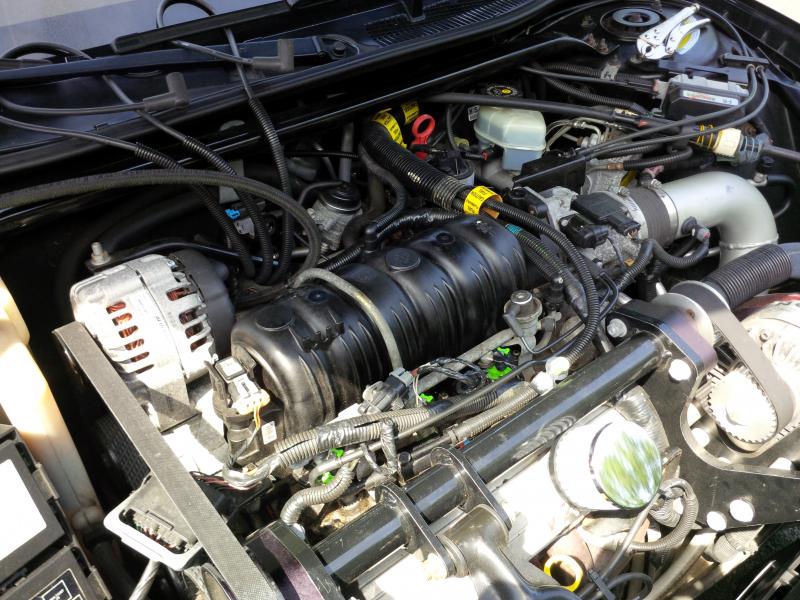

And here it is, all buttoned back up:
