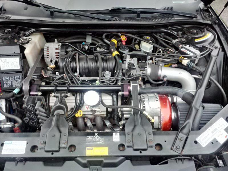

They want to hang on to it for one more day. Drive it around some more and check the air:fuel ratio just to make sure I am fully safe and not leaning the engine out too much.
I should have it back tomorrow, although if the rain is bad like they say it might be, I might have to wait until Thursday.

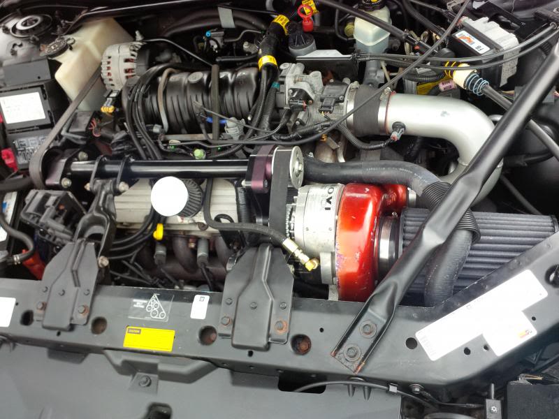

Here's a few initial pictures, and a quick video of the sound. I just still need to tinker with it I guess...

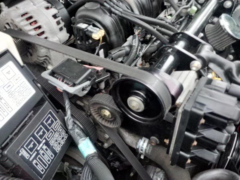

Talk about a big filter! lol

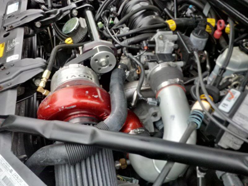

That bracket clearance wasn't as bad as I thought it was going to be, just needed to be bent down and turned a little. I thought it was going to hit where the idle pulley had to go, but I was wrong. That was a good thing to be wrong about haha.

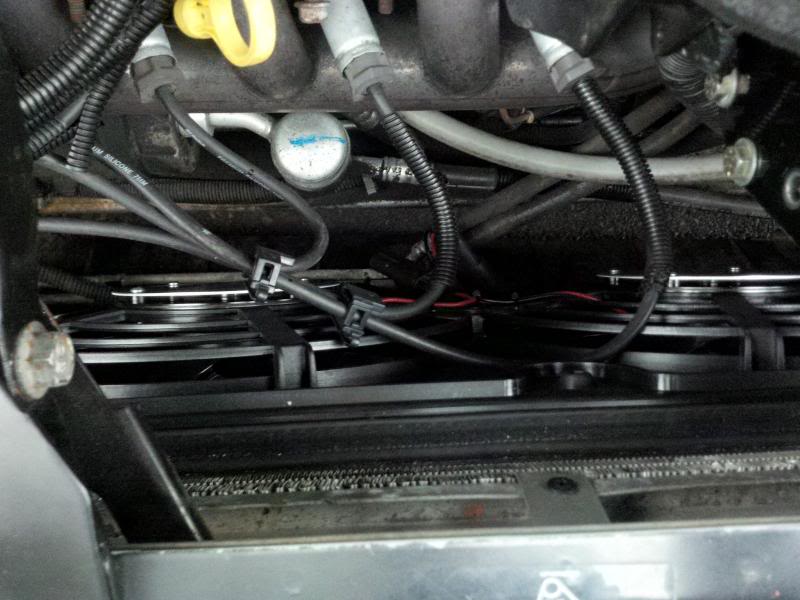

My new EXTREMELY thin fan system. I got plenty of clearance now! (I did ziptie that plug wire off the fans, just after I took the picture)
