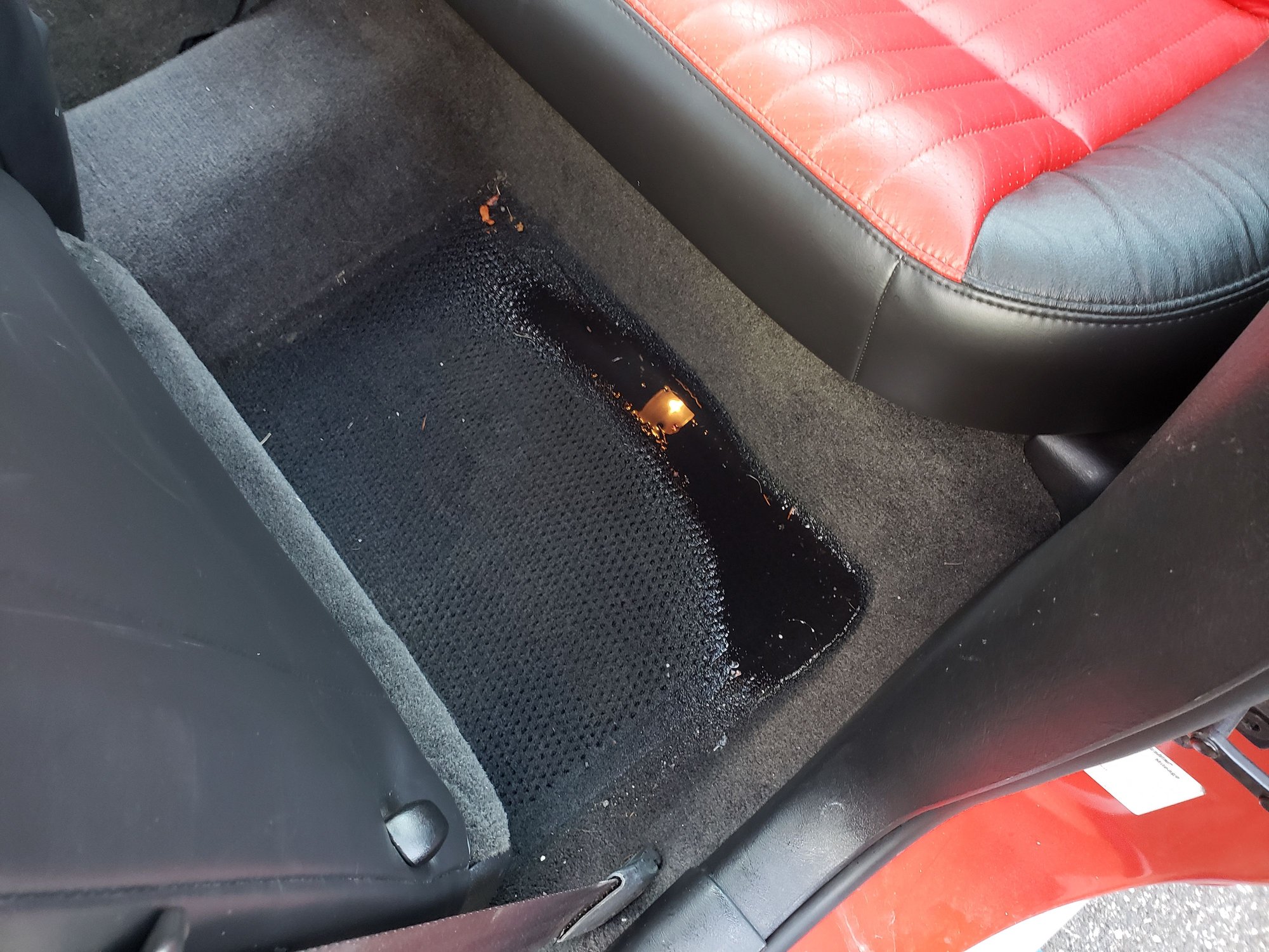

So it seems the problem comes and goes, but I have now vacuumed the back drivers side carpet 4 times because it has been getting wet...only that side. I can confirm that the door drains were clogged so I cleaned them. I have noticed that there will be water on top of the bottom weather stripping. But I have also noticed that there is water dripping from the bottom plastic of the door. This almost looks like the water is running down to the bottom of the door where it drips off onto the the carpet and or weather seal, and run under the plastic floor trim. The result is what seems to be water filling in the chassis and soaking thru the bottom of the carpet. Ive added some photos because it is really hard to describe what I'm seeing.
water usually sits on top of this weather seal between it and the plastic. Under the plastic the water can run straight under the carpet.
