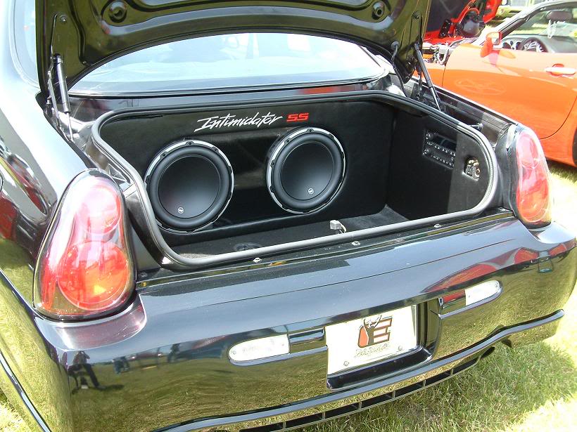

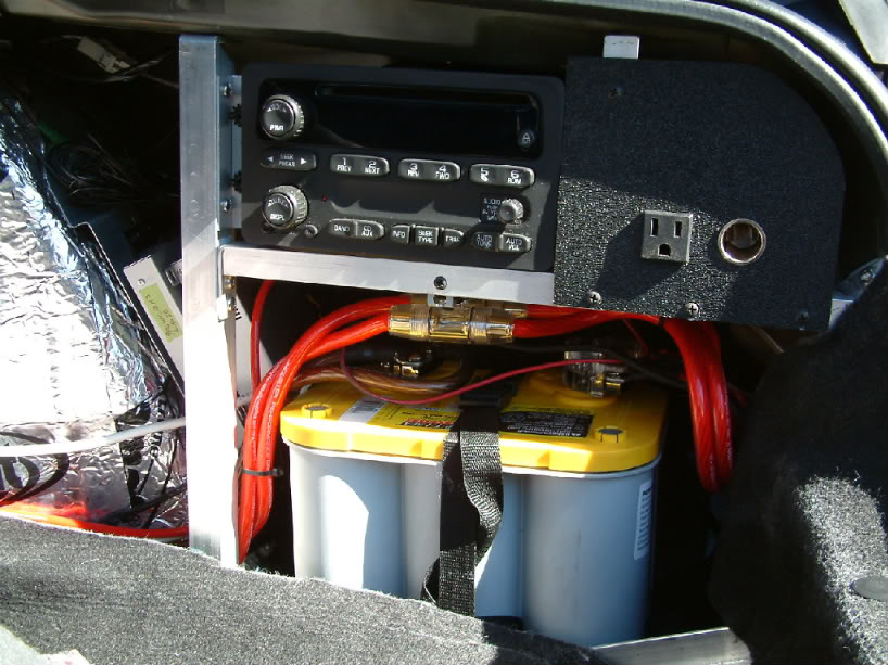

Here's my remote battery install:
It's actually a 2nd battery. I'm not a believer in capacitors. And the 2nd pic is old, but close.

Originally Posted by RocknSS04
Just curious, what's keeping the battery from moving around in the box?
The box is barely bigger than the battery. Its got no where to move to.
Should get an updated pic of this since its all wired in! Still need to fasten the box to the trunk though.
