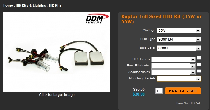

so if i just go to ddm tuning and put in the bulb 8000k and i should get the whole kit...147.99 ....that 9006 for daytime running light and the headlight low right......what is d1r and d1s what does this mean?????

Here your order should look like the picture below, for high beams you should change the 9006 to 9005, I wouldn't recommend getting your high beams done tho, they take too long to warm up and your new low beams will be crazy bright anyways
Low Beam Headlight Bulb Size: 9006
High Beam Headlamp Light Bulb Size: 9005
The DRLs are the high beam, this will also have to be eliminated if you get HIDs, usually done by just pulling the fuse
