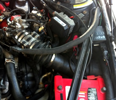

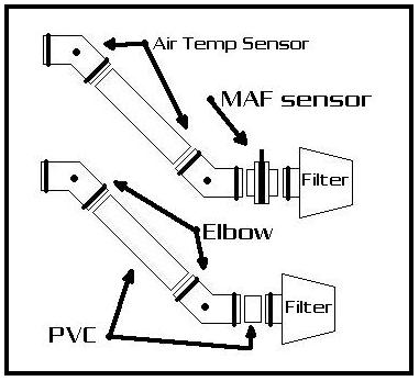

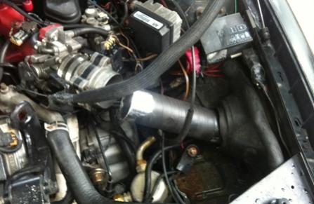

here is my setup... well the setup i had when i had the DOHC
Attached Thumbnails Fenderwell Intake-air-intake2.jpg   Fenderwell Intake-cimg2940.jpg   Fenderwell Intake-img_0890.jpg   Fenderwell Intake-img_0914.jpg

Old May 17, 2013 | 07:02 AM
03SSLE's Avatar
Posts: 6,074
From: Seattle
The only suggestion I have is when you install the IAT sensor you want it in the same location as it was in the stock duct hose. Otherwise it will alter the air/fuel mixture with the possibility of negative results.
Old May 17, 2013 | 07:36 AM
z34phoenix's Avatar
Joined: Oct 2005
Posts: 1,100
From: Daytona Beach, Fl
not entirely true. the only thing the IAT directly affects is timing. as iat increases timing is pulled and as temp goes down it adds timing. there is a large window where no changes are made. so the bottom line is as long as the iat is in the air stream the effects will be minimal if any at all. considering that the metal tubing will conduct heat faster then the stock rubber i would install the iat closer to the filter and further from the hot engine bay.
Old May 17, 2013 | 07:54 AM
03SSLE's Avatar
Posts: 6,074
From: Seattle
Everyone is entitled to their own opinion, but I must respectfully disagree with you. Air temp is one of the variables that the PCM uses to adjust injector pulse. Placing the IAT closer to the filter would be counter-productive. The air passing through it would be colder than the air that is actually entering the engine. The PCM would increase injector pulse duration to richen up the mixture. Since the air entering the engine isn't as dense this would create a rich condition. The result would be reduced performance, a decrease in mpg, oil dilution and promote carbon build up.
Old May 17, 2013 | 09:38 AM
z34phoenix's Avatar
Joined: Oct 2005
Posts: 1,100
...Air temp is one of the variables that the PCM uses to adjust injector pulse. Placing the IAT closer to the filter would be counter-productive. The air passing through it would be colder than the air that is actually entering the engine. The PCM would increase injector pulse duration to enrichen the mixture. Since the air entering the engine isn't as dense this would create a rich condition. The result would be reduced performance, a decrease in mpg, oil dilution and promote carbon build up.
this has nothing to do with opinions. I am talking about facts. Show me a table the pcm uses that relates IAT to AF. to calculate IPW the pcm uses maf and map in addition to the narrow band O2. the IAT helps to add or remove timing. if the IAT had a direct effect on AF people would have used the happy **** mod more for AF corrections.
as from the actual tables there is about a 80 degree window where IAT temp change does absolutely nothing. at high temp or low temps it will add or remove timing. if you were to try and keep the IAT in a stock location with a metal tube vs the rubber the sensor will show a higher temp reading. so moving the iat closer to the filter will help to restore closer to normal IAT readings. but light said the variation is negligible.
