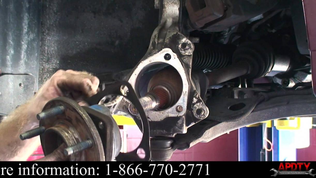

I had just replaced my lower control arm and the hub. All I need is a pic of how the wire set up is. Some reAson the wire for hub is sorter I think and before it was zip tie. theres a bracket that clip that holds the connections

I did a google image search. I can't find a pic showing what I want. But I found this. You can clearly see the metal piece I'm talking about that is sandwiched between the hub and the knuckle. What you don't see is the part of it that holds the connector
