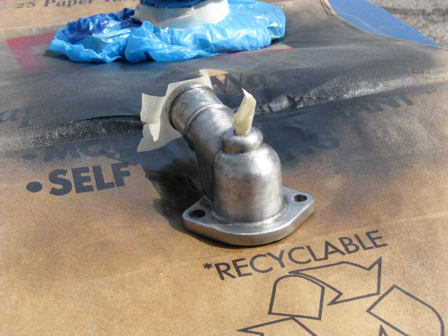

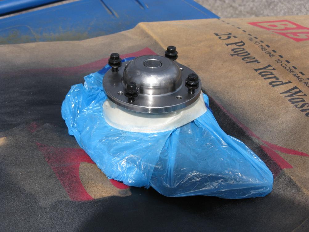

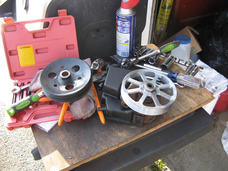

So this weekend I did the following:
- Change the power steering pulley to a nice/new light weight aluminum one (I posted a separate thread about getting these pulleys a while ago). This went easy, but I did have to pull the pump out of the car ($1 store turkey baster helps drain the reservoir so you don't make a crazy mess after pulling the lines).
- During this time, I was painting my new pump housing high temp black.
- Following day, prepped and clear coated the hub of the pump (as it will be exposed with the new aluminum pulley I have).
- Clear coated a spare t-stat housing (I did it in a brushed aluminum look, matched my L26 UIM and L67 throttle body).
- Changed my failed A/C Condenser.
I was not busting my hump on the Monte (so I probably spent more time then I had to doing these tasks, but they all went well, not a busted knuckle or curse word, best car projects).

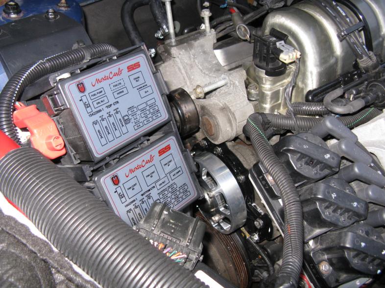

I've only had little bits of time to work on the Monte (some of it has been due to weather). She has new rad and heater hoses
Piece of advice, it's good to pressure test your cooling system. With no coolant in it, all this new stuff, I put the tester to it and she was NOT holding pressure. Since I had no coolant to leak out, I mixed a small amount of dish soap with water in a spray bottle and squirted it around, first location I tried was my problem. Hose clamp not tight enough! Easy fix and find! No more issues!

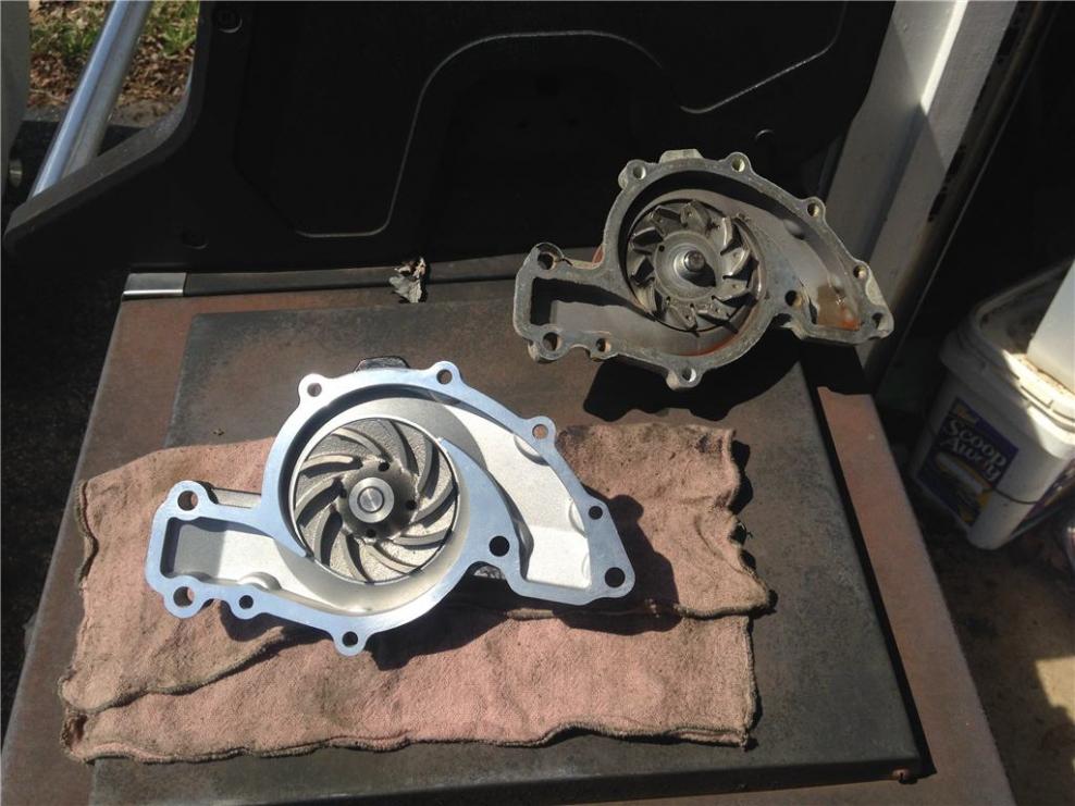

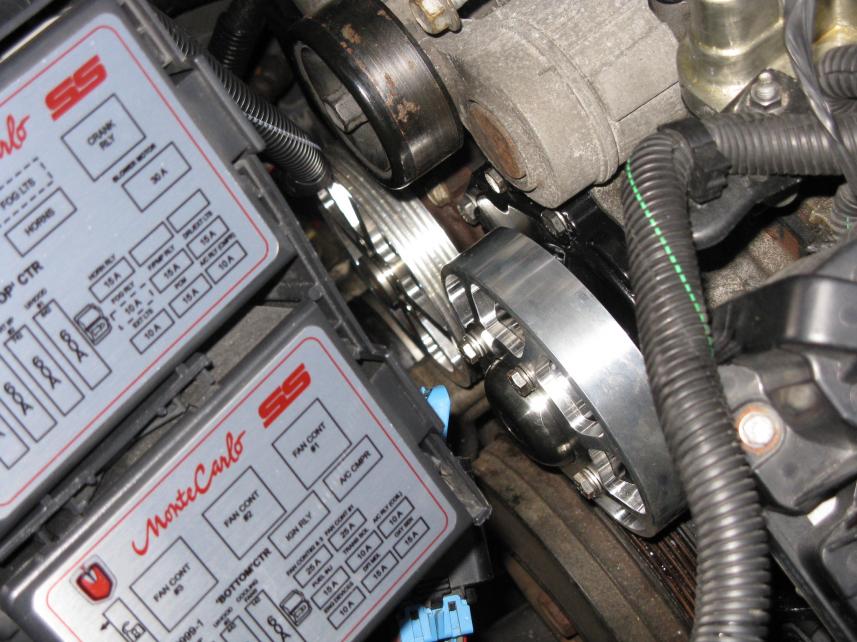

I finally put the water pump pulley on. Now, just waiting on a couple small items and I can put it all back together again! Not too far off from being ready to roll!!
Attached is a pick comparing the actual water pump that came off my Monte (upper right) and the new one I put on. Nice difference in the impeller design!!
And a couple pics of the new pump installed and now the 2nd of 4 new aluminum pulleys with new stainless steel hardware.
