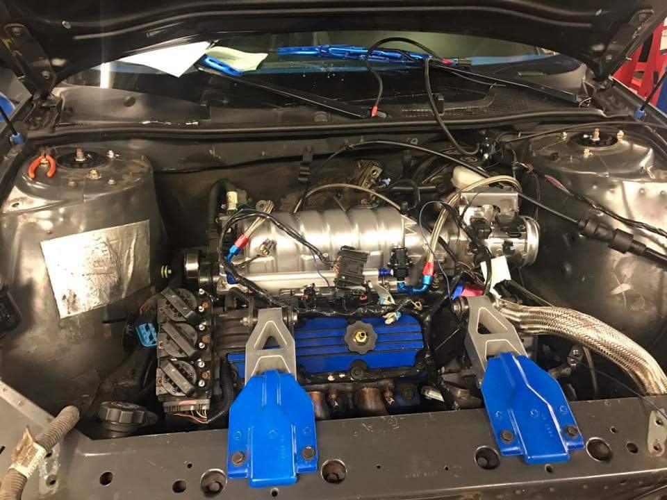

**UPDATE**
Battery, fuse box, pcm all removed and being relocated. Once wiring is done then we will be working on the intake manifold and possibly relocating the alternator to where the ac compressor used to be. Then fabing up the exhaust and charge pipes after that.
Current pic as of 3/30/17
