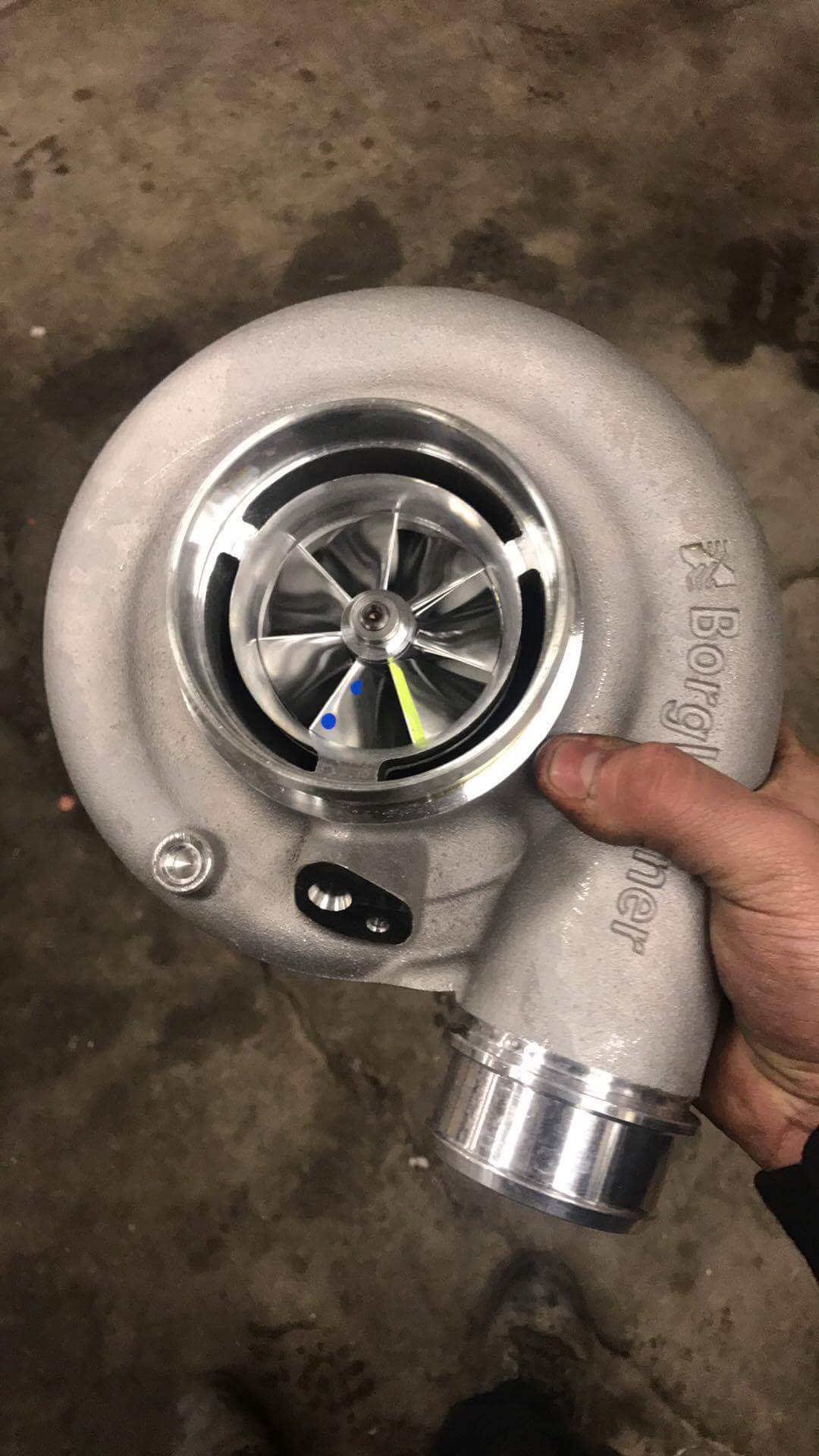

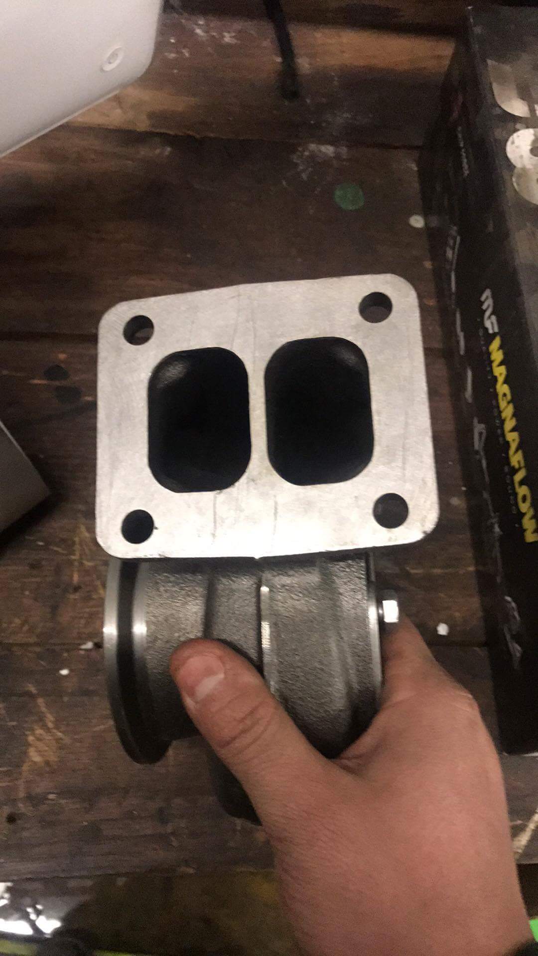

Well here she is everyone! The new Borg Warner s369 turbo with divided t4 .91 housing. It's physically so much bigger, gonna be a hard fit but we will get her in there.

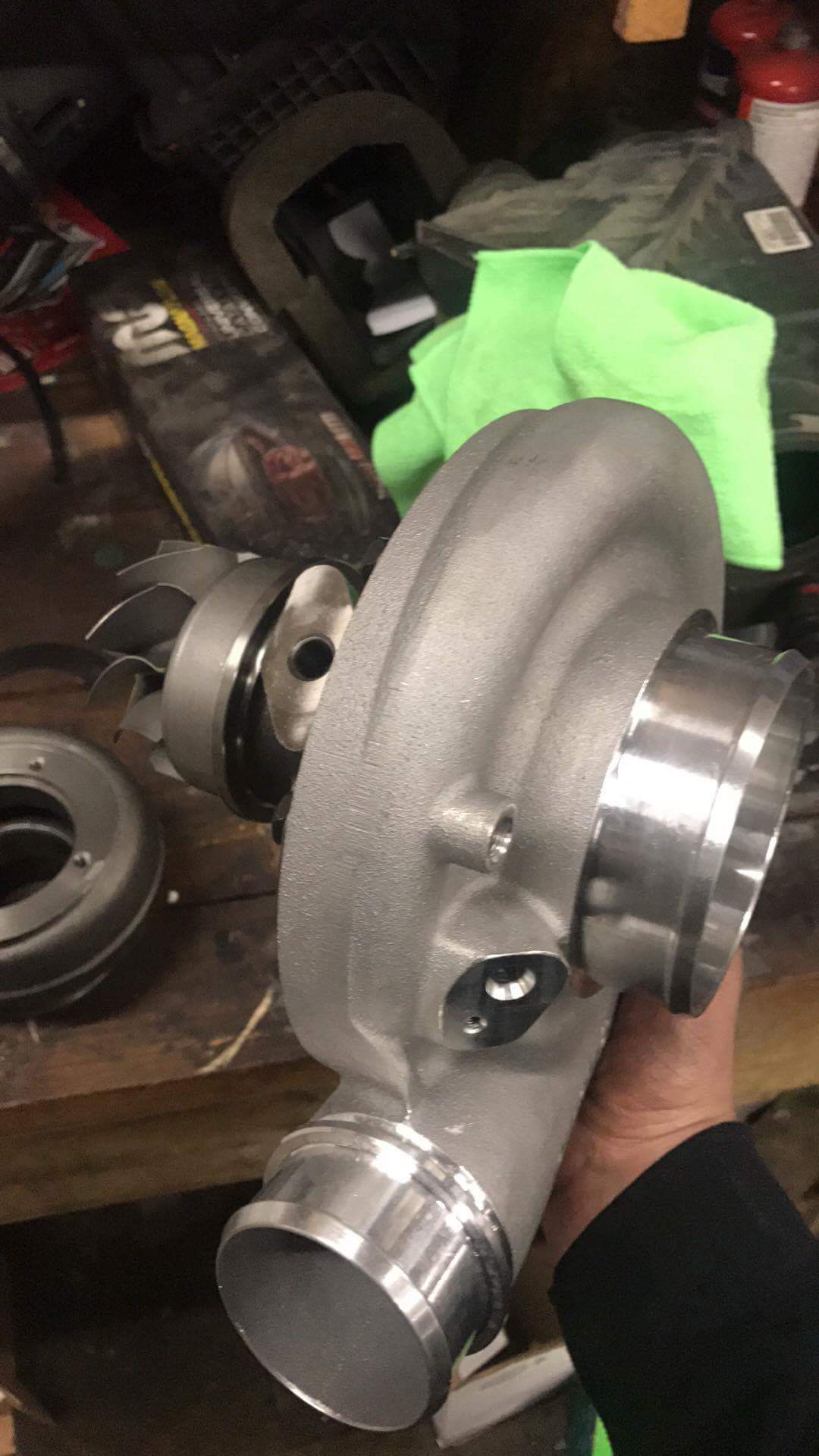

Here is the Borg Warner 8374 I have installed...Has it's own integrated wastegate and BOV
