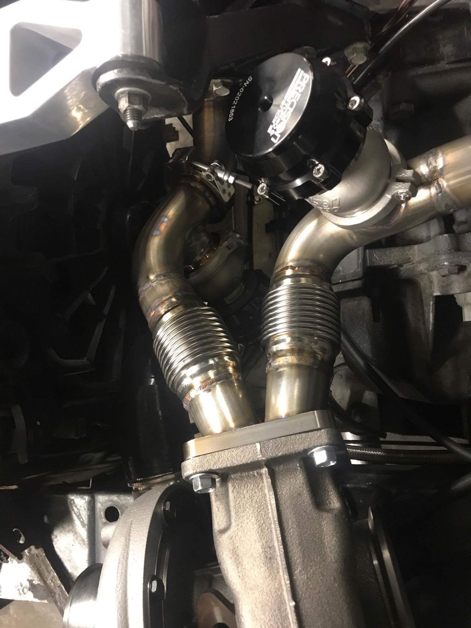

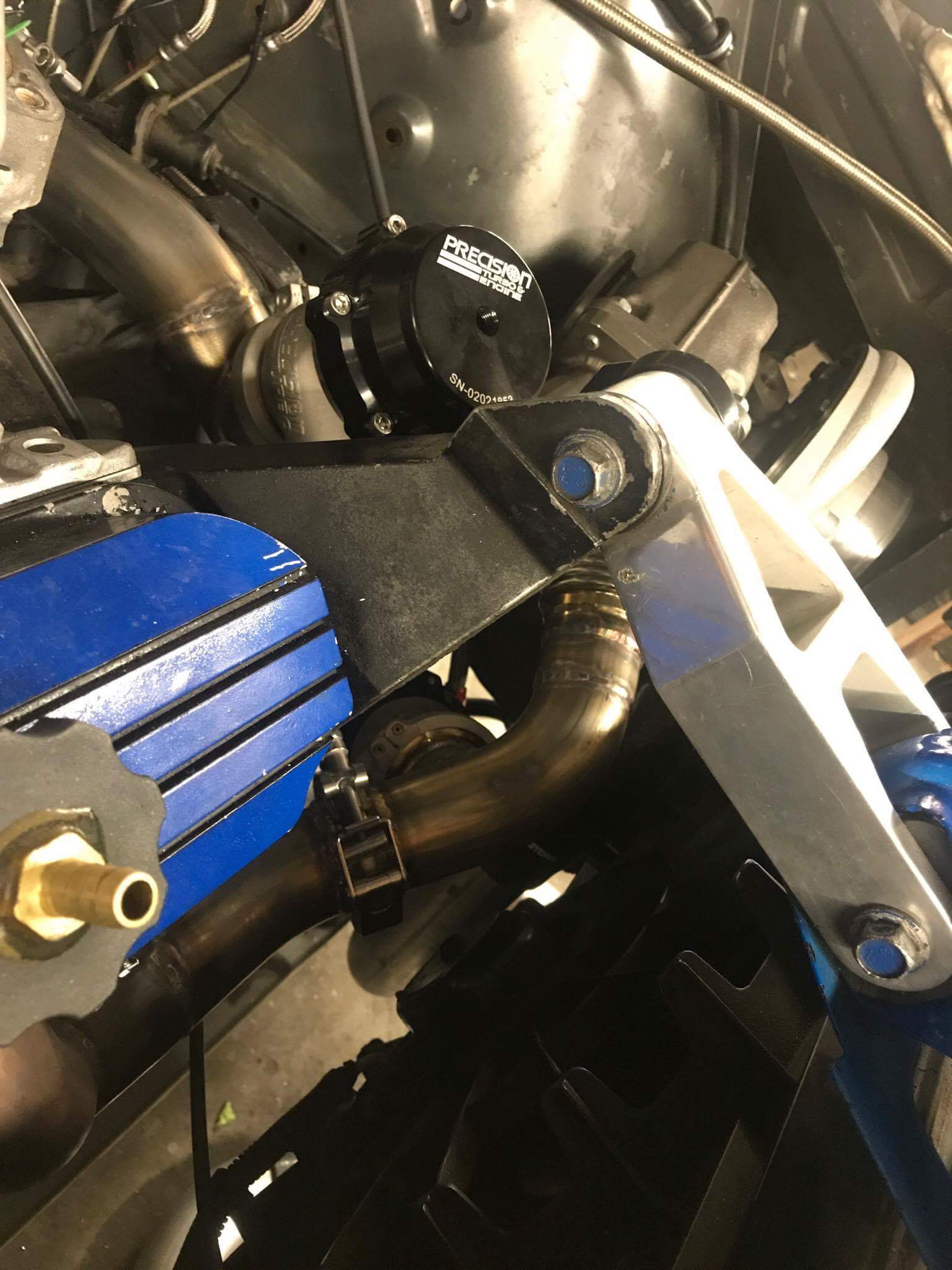

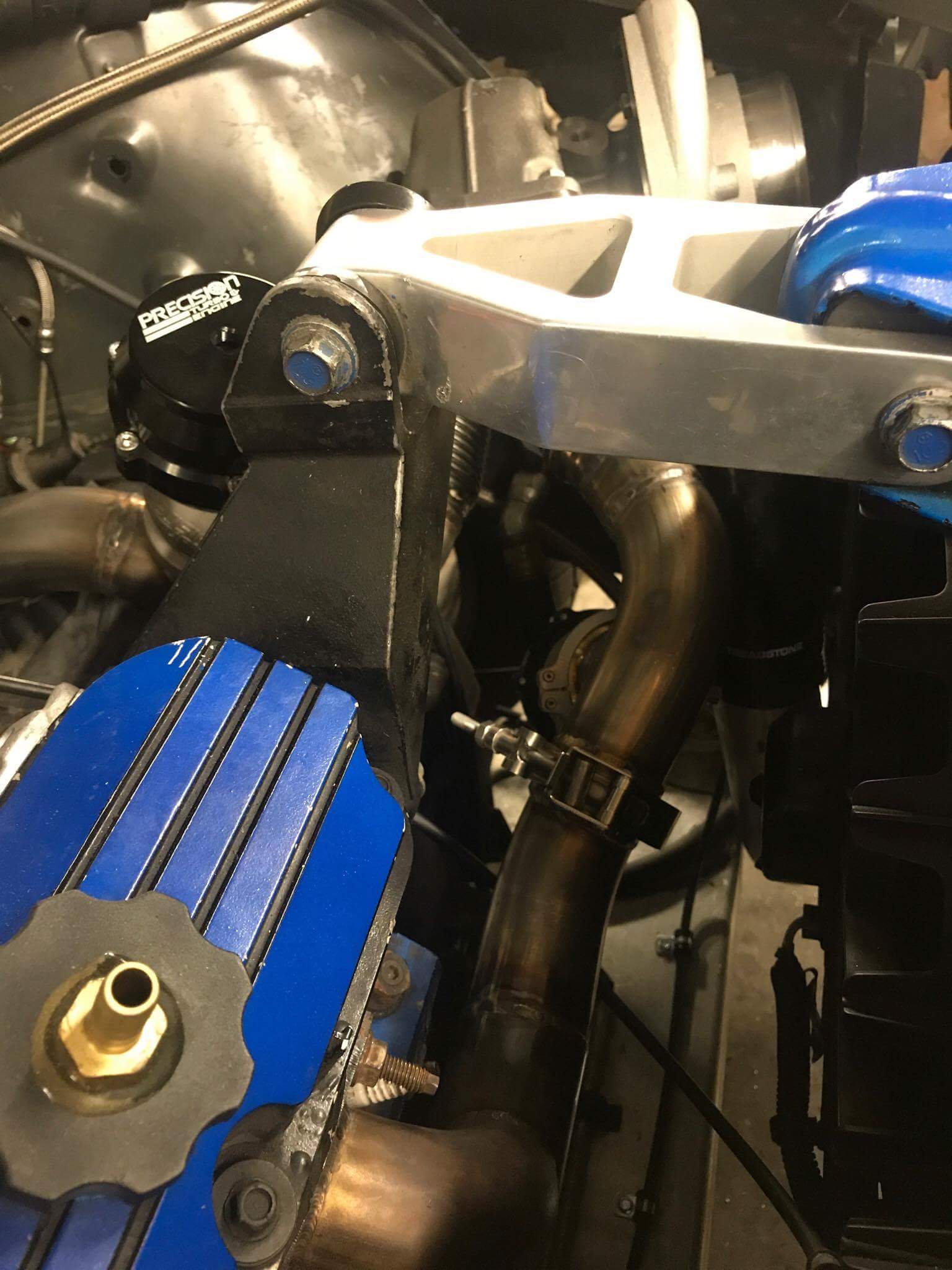

The yellow pipes are flexible stryofoam to get bends exact etc before cutting and welding pipe.
Anyway.... Got a update today as they came in on a Saturday and also worked until 8:30pm on it. Guess me getting mouthy is finally sinking in. I hope so anyway. The current plan is having the rest of the piping done Monday and having everything to the powdercoater by Tuesday.
The turbo looks massive sitting there haha I love it!

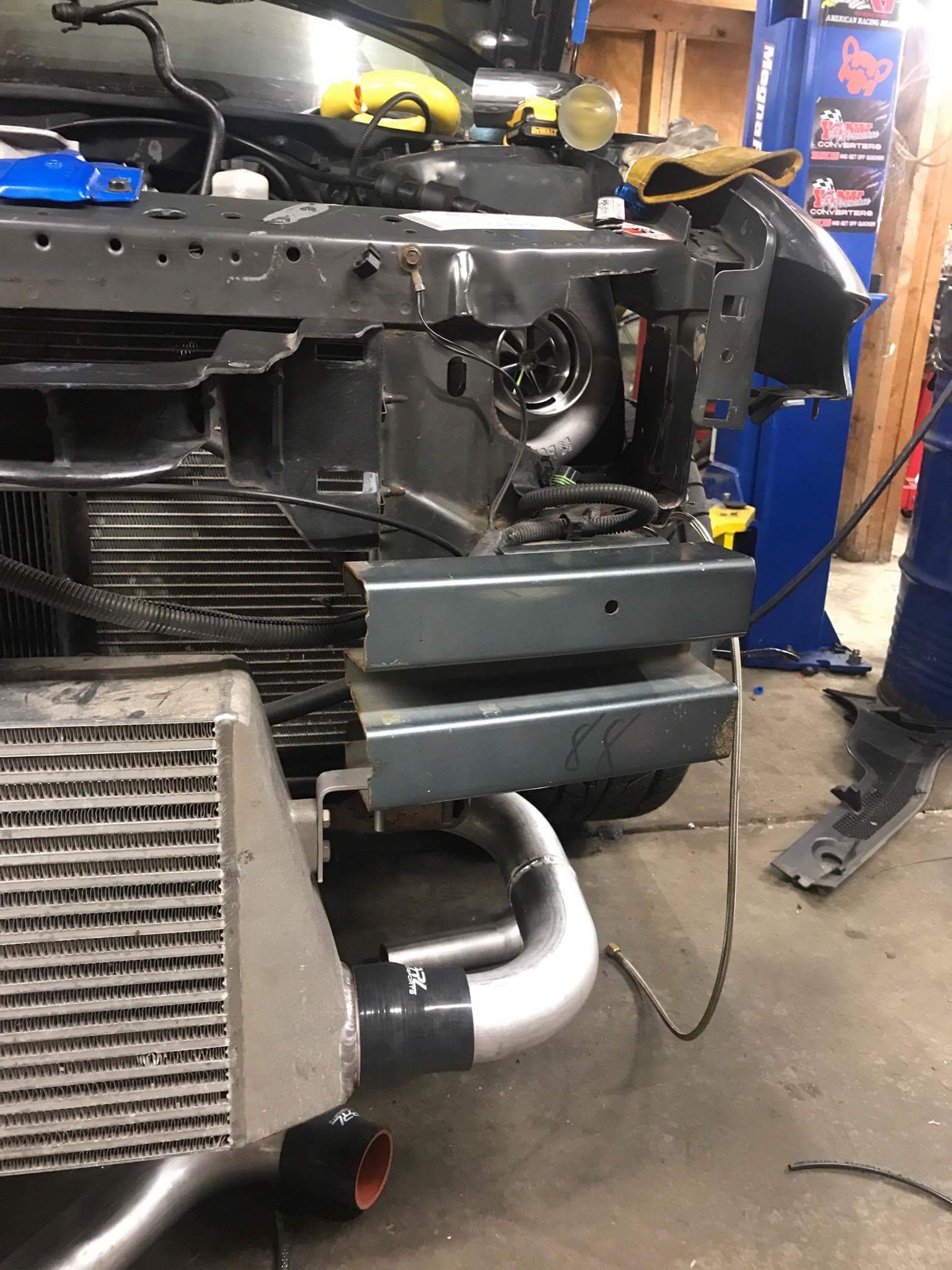

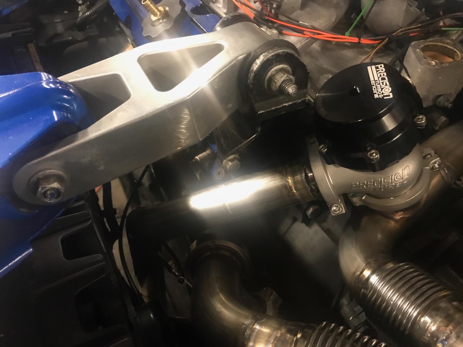

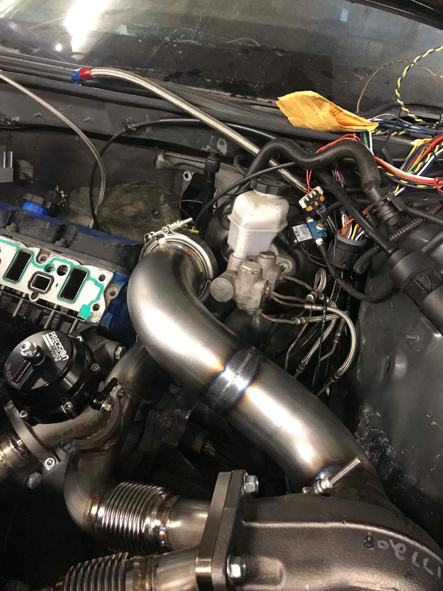

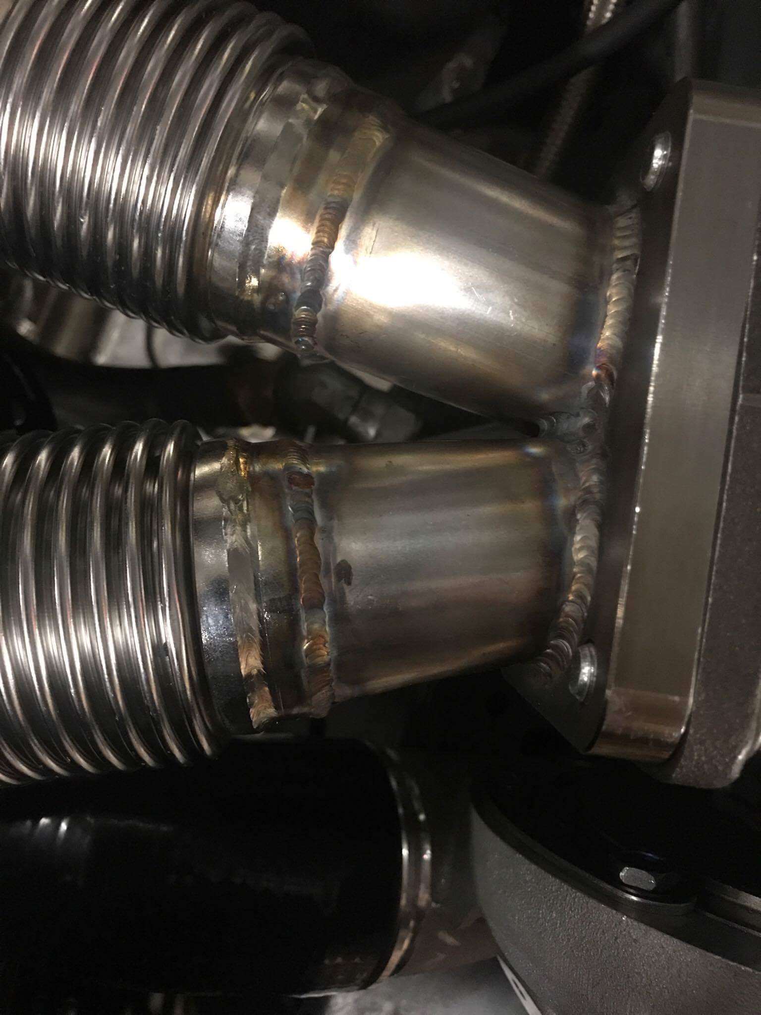

Dump tubes we're finished today. They had to order a transition piece for the cold side charge pipe and it showed up today so most of that is not done too.
They tried to get 4" downpipe in and claim it's impossible so they have to use 3.5" really upsetting. Was really looking forward to a 4" open dump especially after they assured me it would fit originally

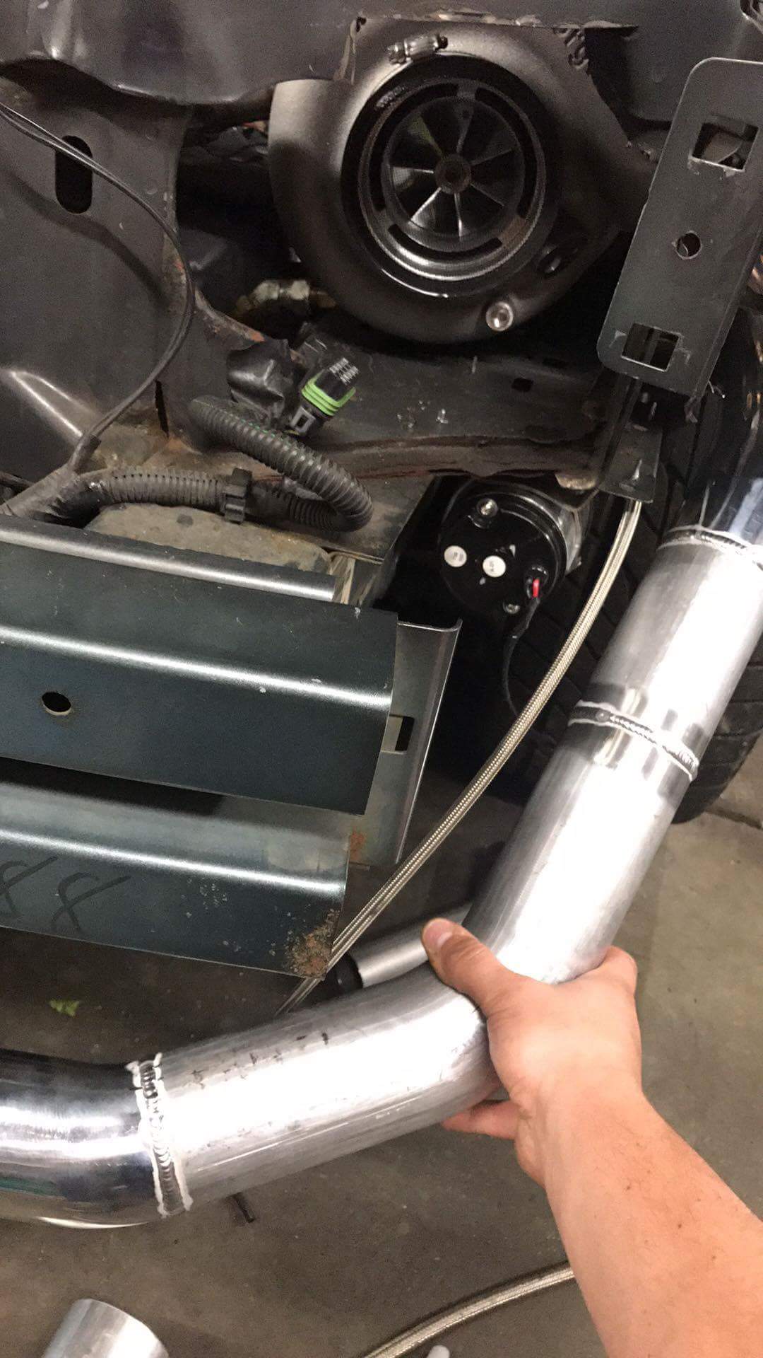

Im waiting for a update hopefully today but the pipe off the turbo is now done and all 3"
Last I was told on Wednesday was the downpipe and other charge pipe was getting fabricated. After that they still have to install interior, finish wiring, etc.

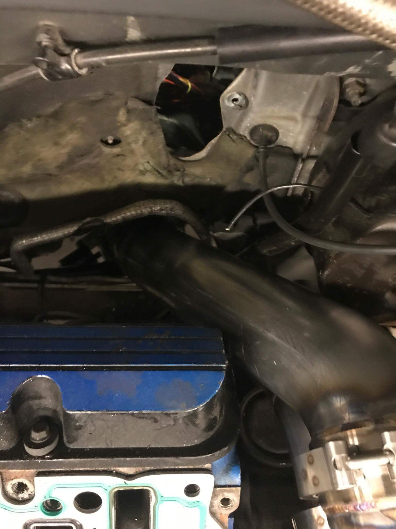

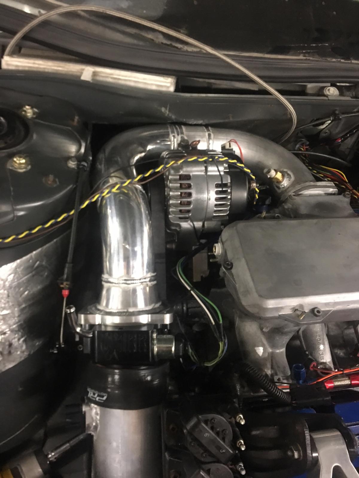

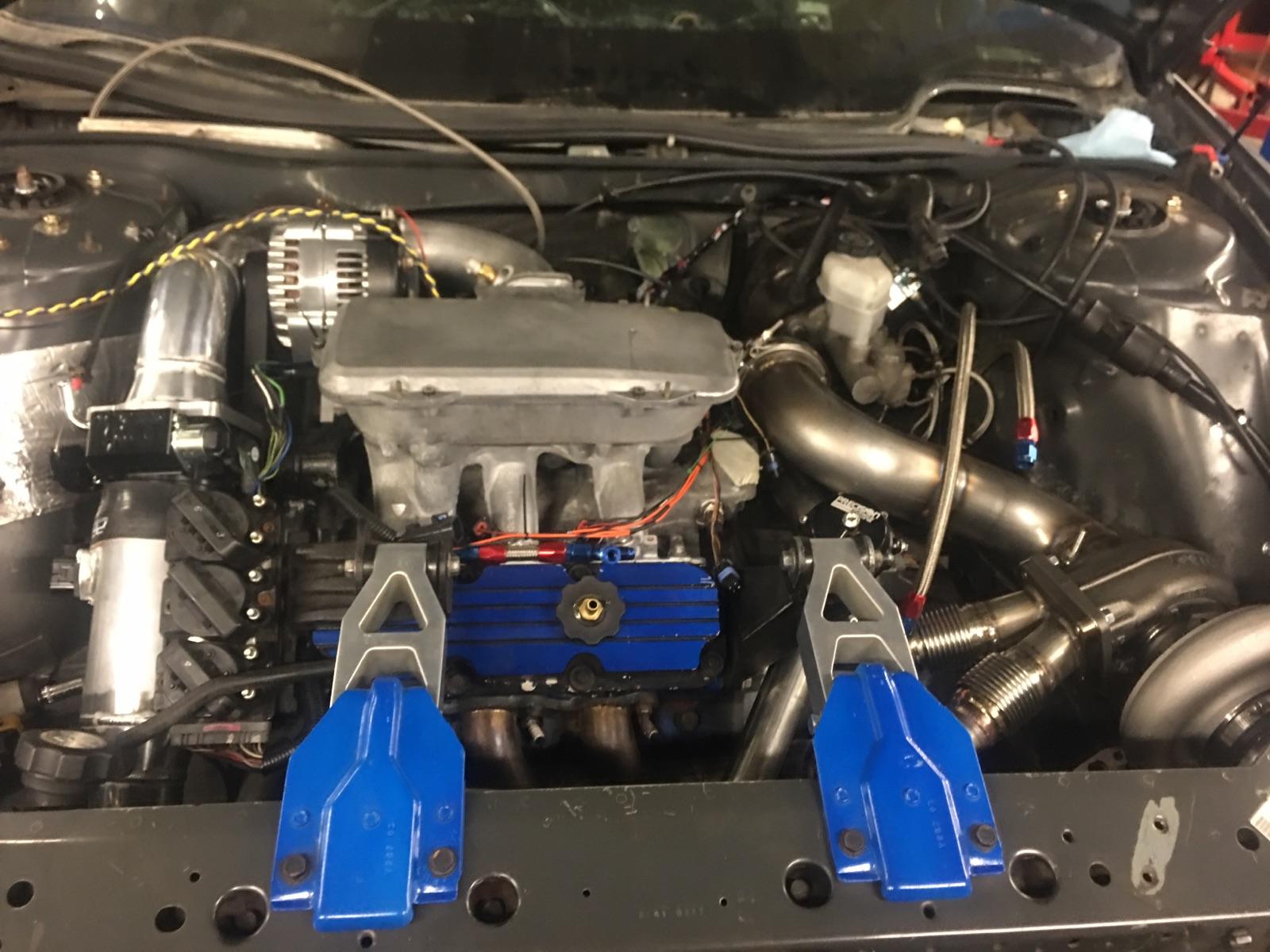

As promised, Friday updates!!

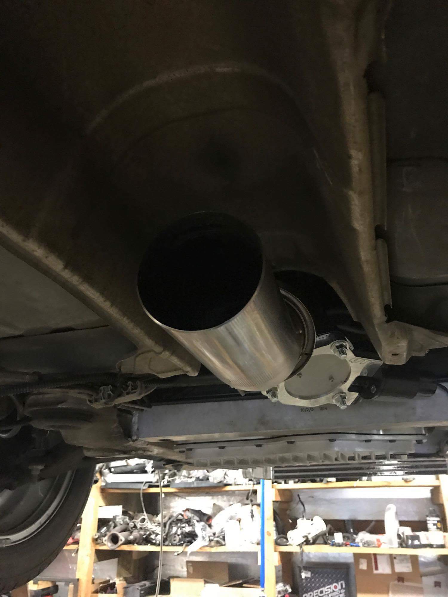

3.5" downpipe has been fabricated and snuck around the engine and out the exhaust tunnel. She is a big one that's for sure! Pics attached
The charge pipe coming off the ic running to the Holden manifold will start being fabricated late tomorrow or Monday. They are waiting on a transition piece for it and it should arrive tomorrow. That pipe will be routed from ic around and up through the fender and through where the battery used to be with 3" pipe. Right where the battery used to be it will flare to 4" to mount the ls7 card style maf and mount to the 92mm throttle body that is gonna sit where the fuse box used to be. After the throttle body is will neck back to 3" to route around the alternator and into the Holden manifold. Pics of that charge pipe hopefully by Tuesday at the latest!
