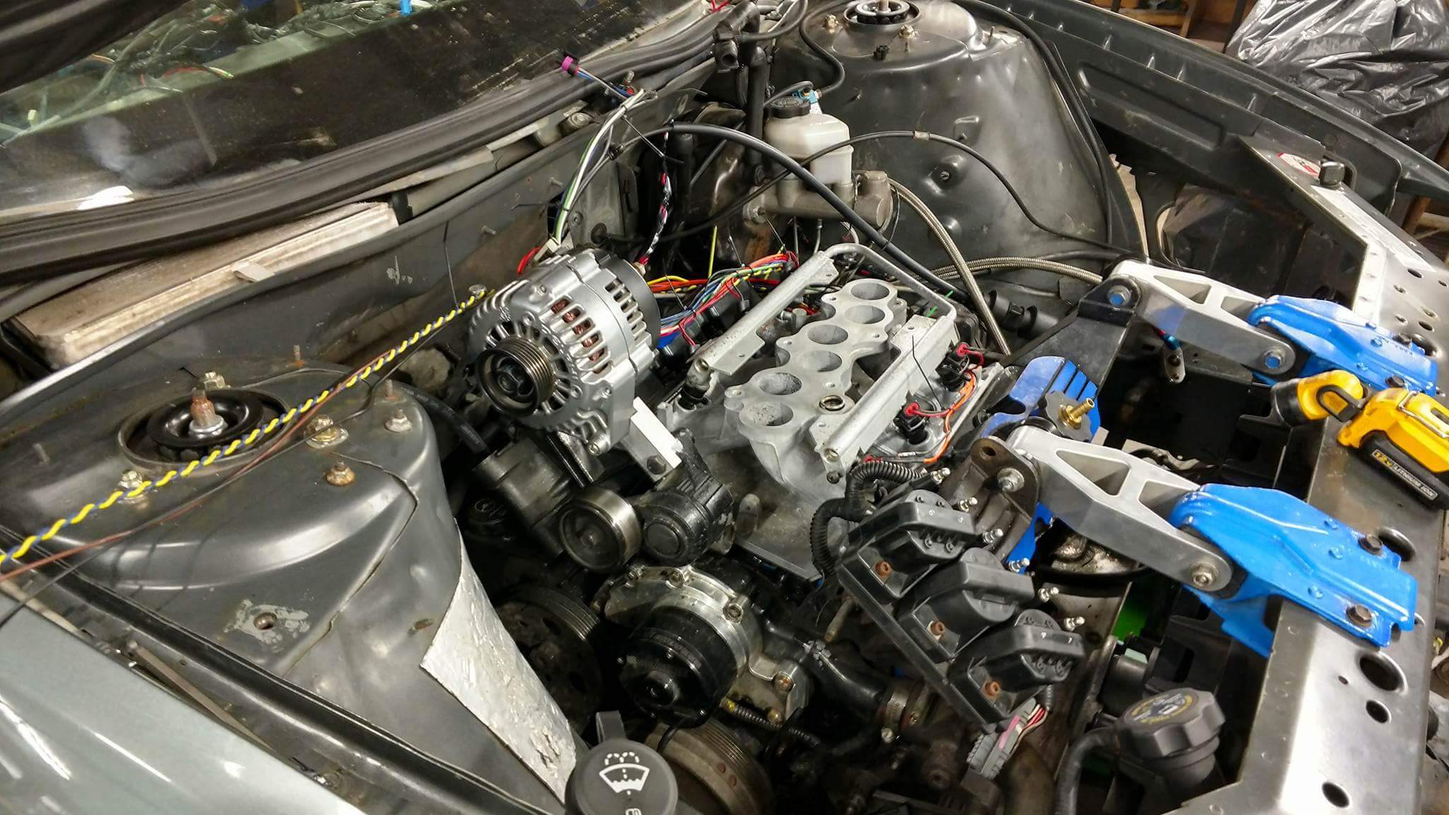

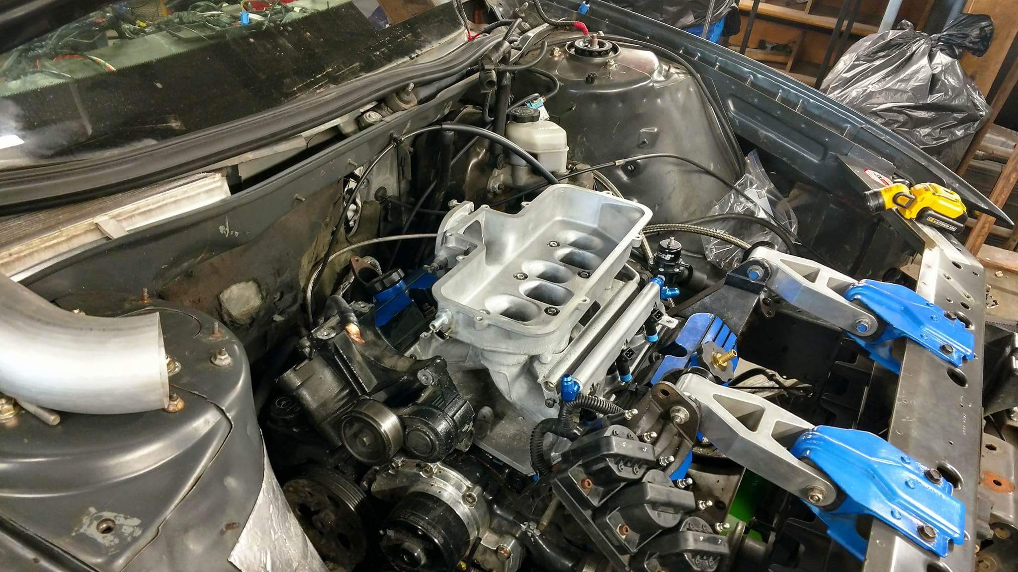

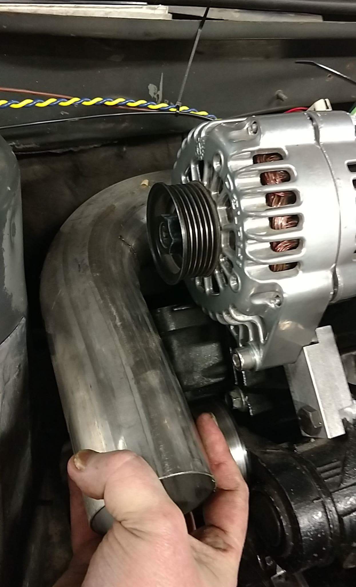

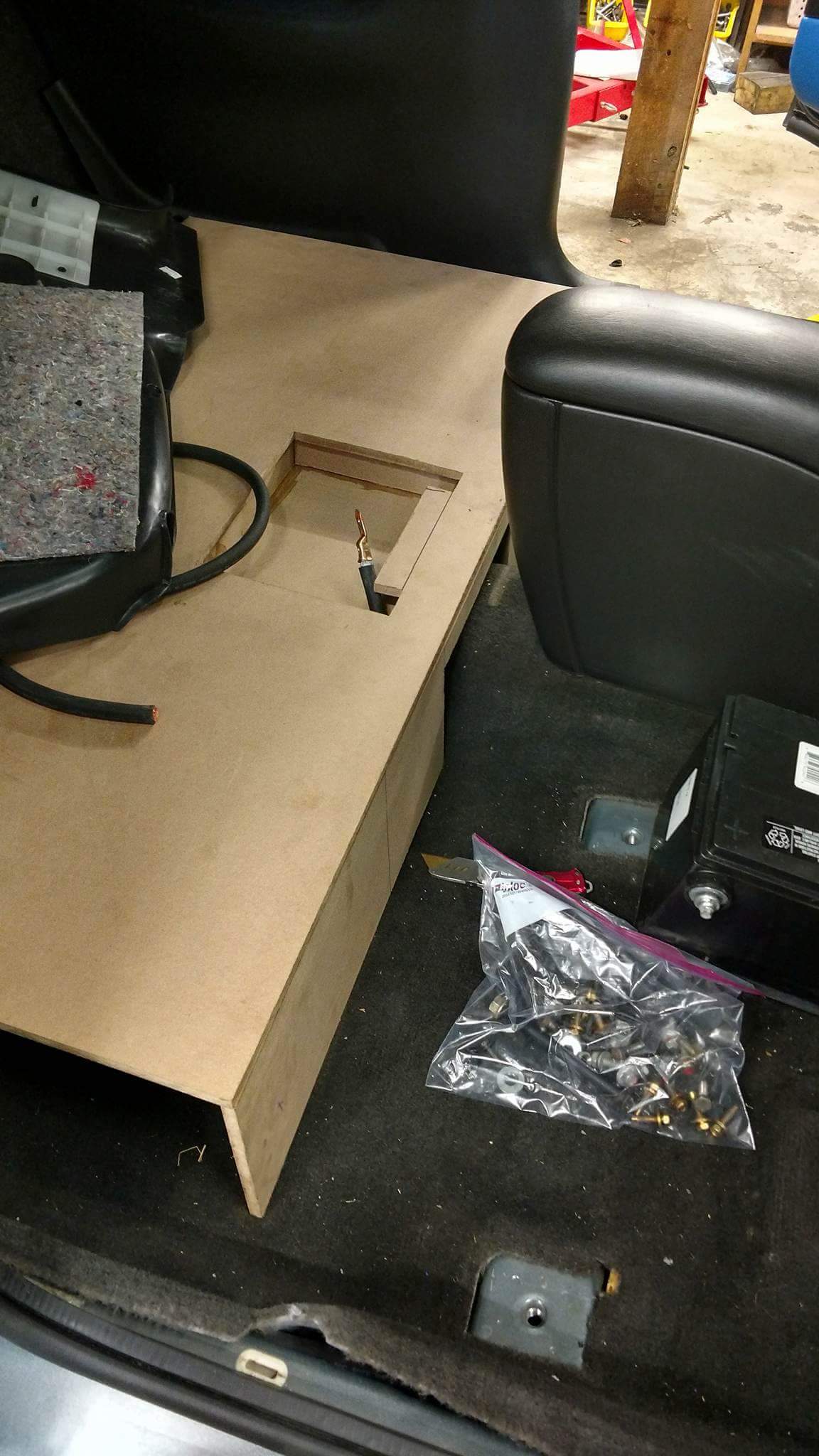

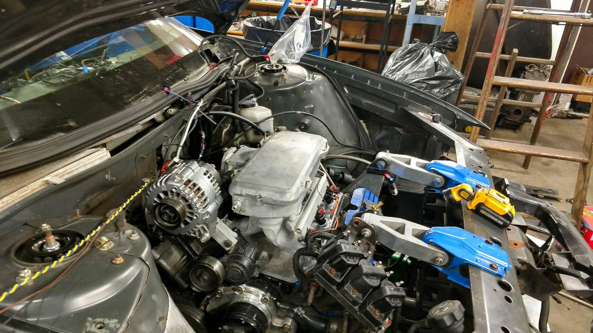

Updated pics

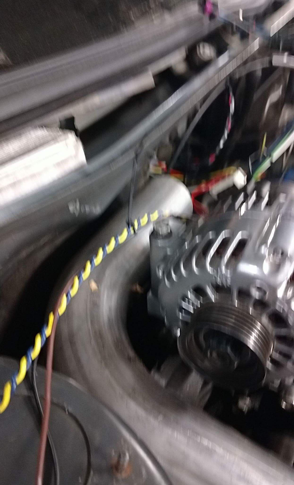

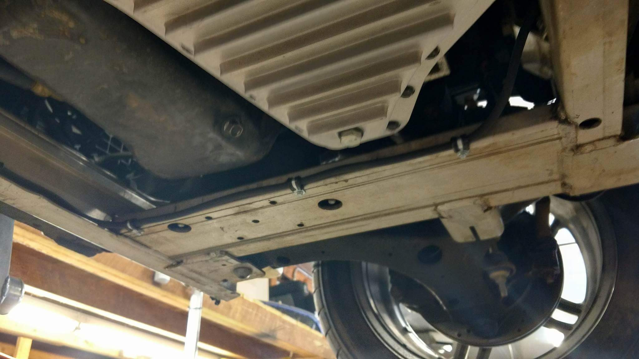

The wood in the back is the new sub floor that will house the battery and and ride stuff. The 3" charge pipe is a close fit past the alternator but it fits the pic from under the car is showing the new 4 gauge starter wire is all.

I watch everyday hoping youll update this... Sooo awesome how they got the Holden intake in there.

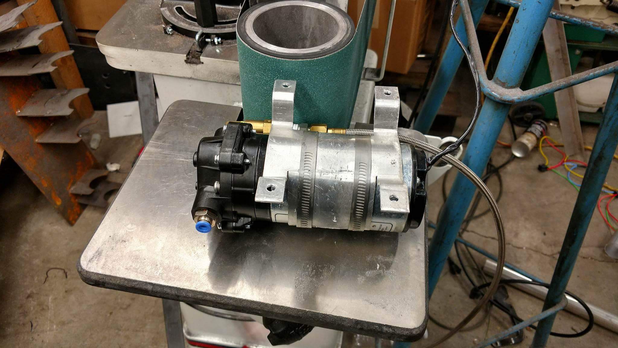

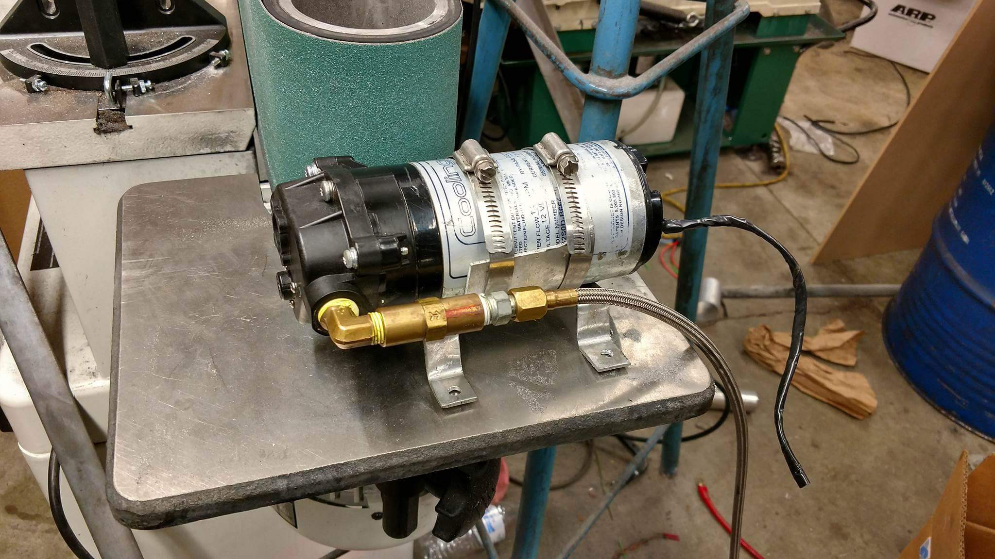

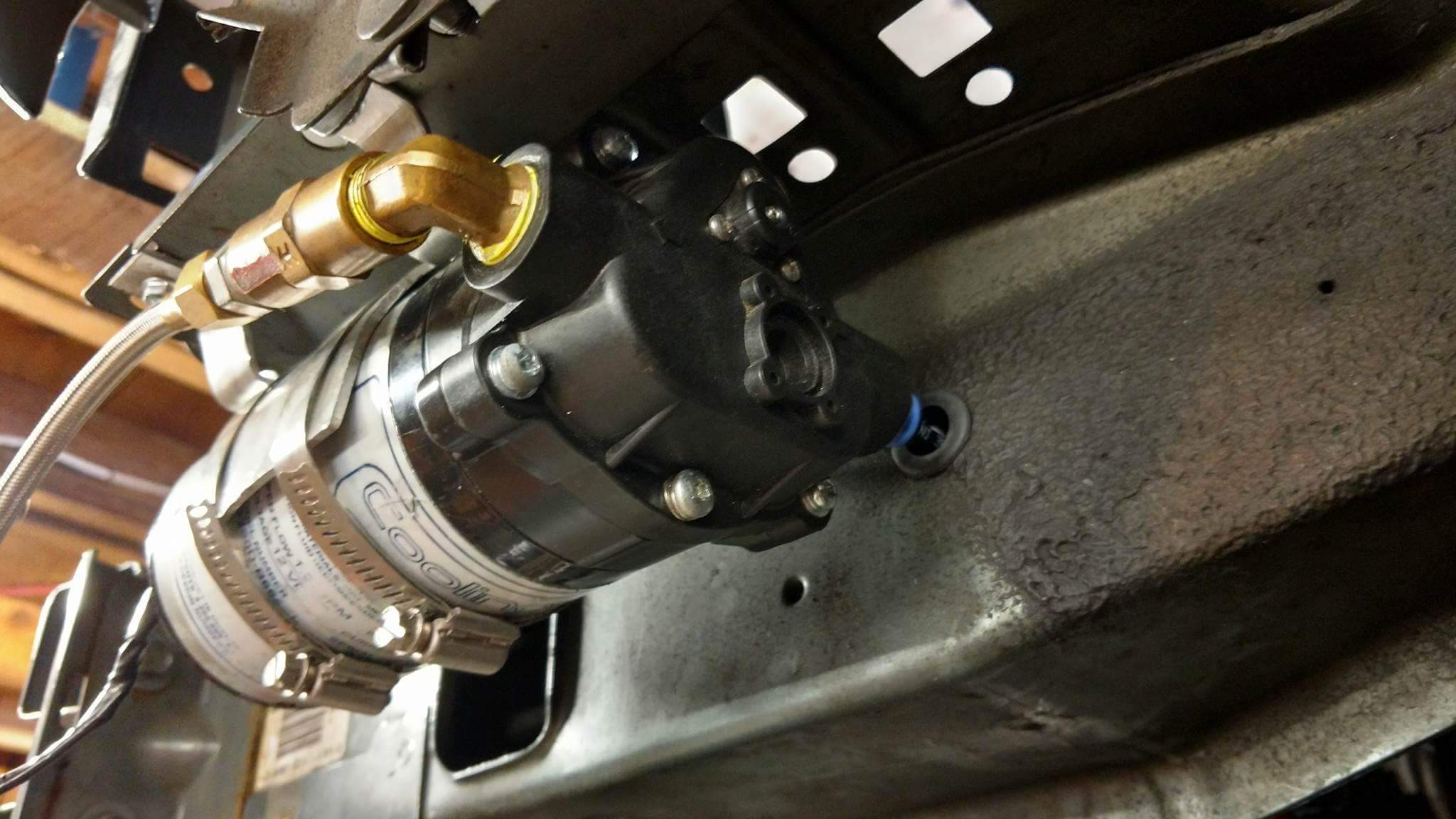

I try updating this as soon as the shop gives me one. They also just sent me pics of the new mounting bracket thetly made for the meth pump. Glad to hear I have your interest with this build
Very very nice John. Look at your one of a kind TurboMonte becoming even more special. That is so rad the direction you have chosen to take your build. Going to be one sic puppy. Smart use of the space at the backseat passengers area.
Where will your W/M pump be mounted? Sweet custom bracket for it. I will have a Cooling Mist pump if you should want it as a spare.
Why the 4 gauge starter wire?
LOL, they did just barely clear your alternator. That had to be sketchy shaping it to such a tight clearance. NICE!!

Not sure on mounting location of the w/m pump yet. How much you want for yours for a spare for me? They wanted 4 gauge to make sure all wiring was above and beyond what would be needed. Yea it's VERY close. Im sure all this piping is gonna be very close though with how big the diameter of all the piping is.

The Cooling Mist pump is yours. When I get it back with the car I will mail it to you, you can PM me the mailing address. It has never had a problem, I think I have only went through about 2 gallons of meth the whole time I have had it, so it is a pretty low hour pump, not garbage by any means. Trying to mount the Holley W/M pump in the cubby of the Cooling Mist trunk mounted reservoir tank, looks like it will fit.

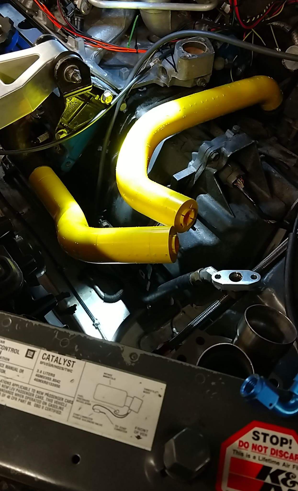

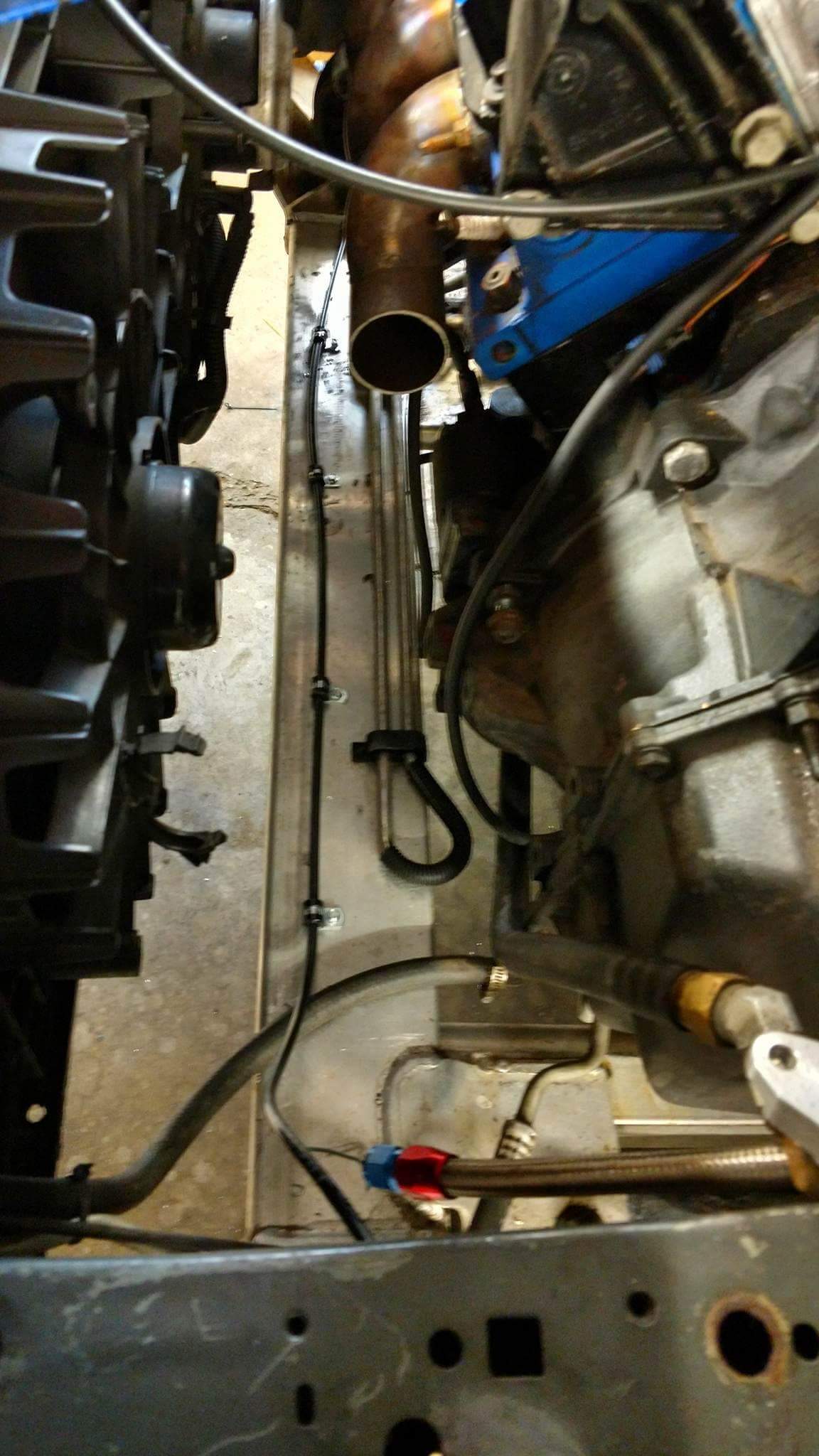

Awesome, I'll send you a pm with address. Thanks sir! Glad to know yours is about complete. Im still far from close and getting very frustrated. I kinda got mouthy with them Wednesday so we will see what happens now. Anyway.... This is the meth pump location and start of crossover fabrication.

What are the yellow tube items pictured?
Those manifold pipes are huge, 3"?
