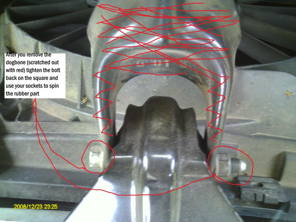

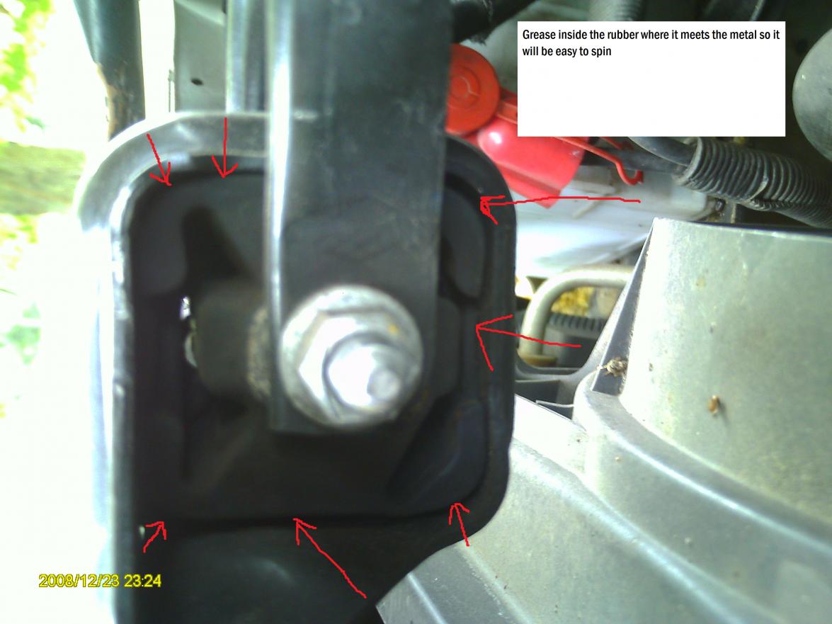

I cant find it, but I asked about this a long time ago and somone gave me GREAT instructions. If you look around you might find it. but you should be able to do it wiithout any trouble, just study the dogbone and you shouldnt run into any problems, just grease it up pretty good, tighten the bold onto the rubber square (without the dogbone attatched) there is metal inside the rubber square to tighten the bolt onto, (do one at a time so your engine doesnt rock) and take two socket wrenches and flip that sumbich. BTW flip it so the thing inside the rubber is horzontile and not vertical. Like I said, once you get a good look at it, you will know what to do.
Another BTW, you only grease the outside of the rubber square where it meets the metal surronding, again, you'll look at it and know where to grease. Dont grease the bolt though, then you wont get any grip and the tightend bolt will spin inside the square and wont spin the square itself.
If you want I can dig through my computer and see if I got some pics of what I did, let me know..
Just remember one at a time
