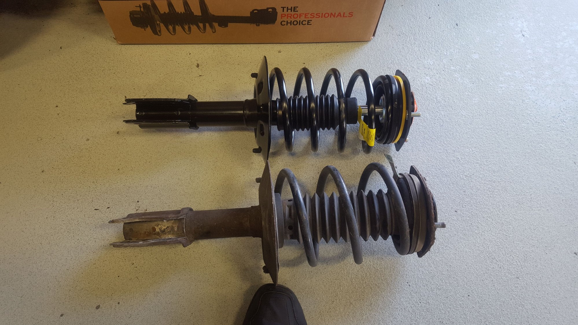

Default Gave the 171661 Monroe's a try
Tried the 171661 Monroe's they are tighter but they work. Got them on Rockauto.
