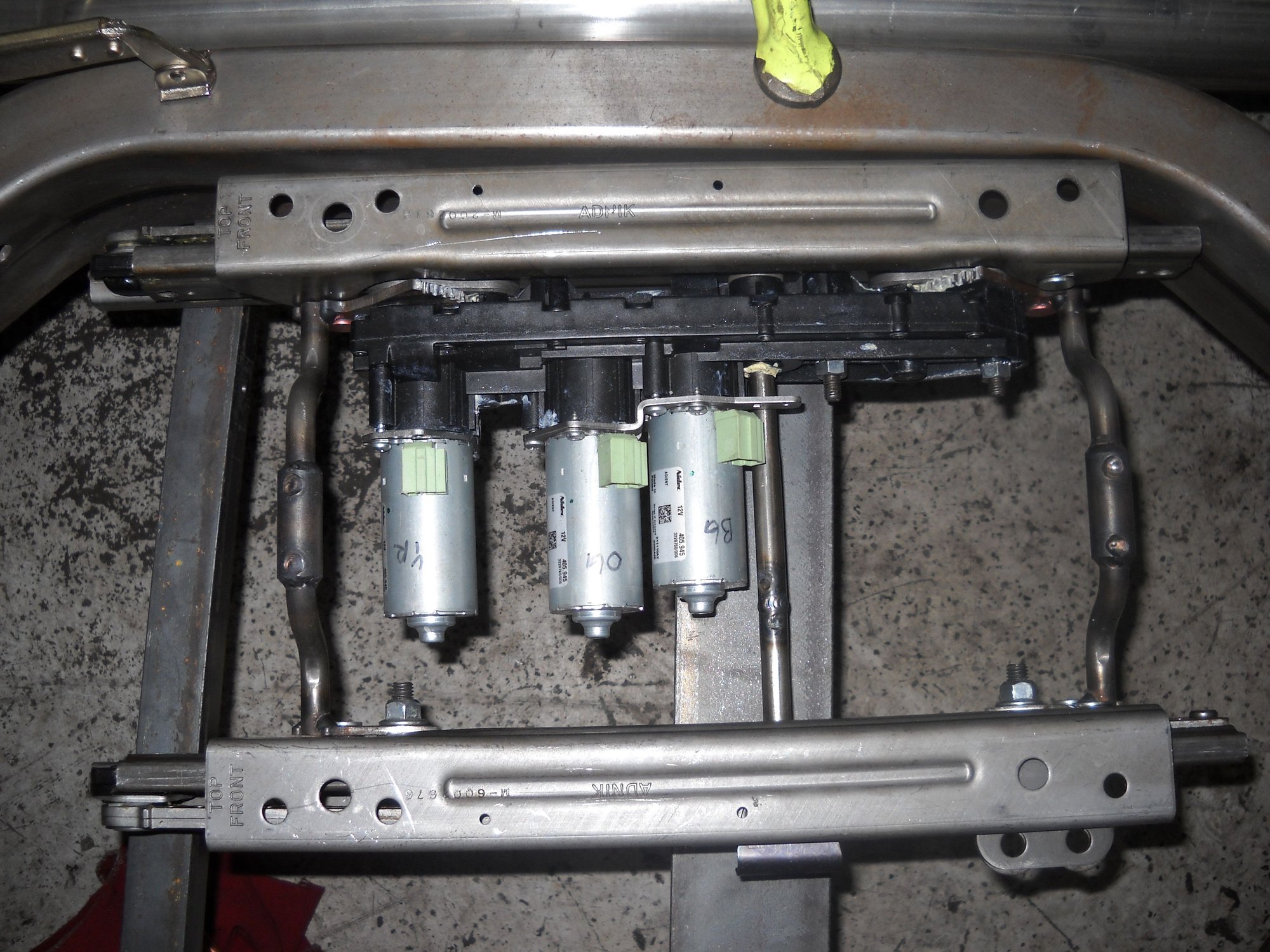

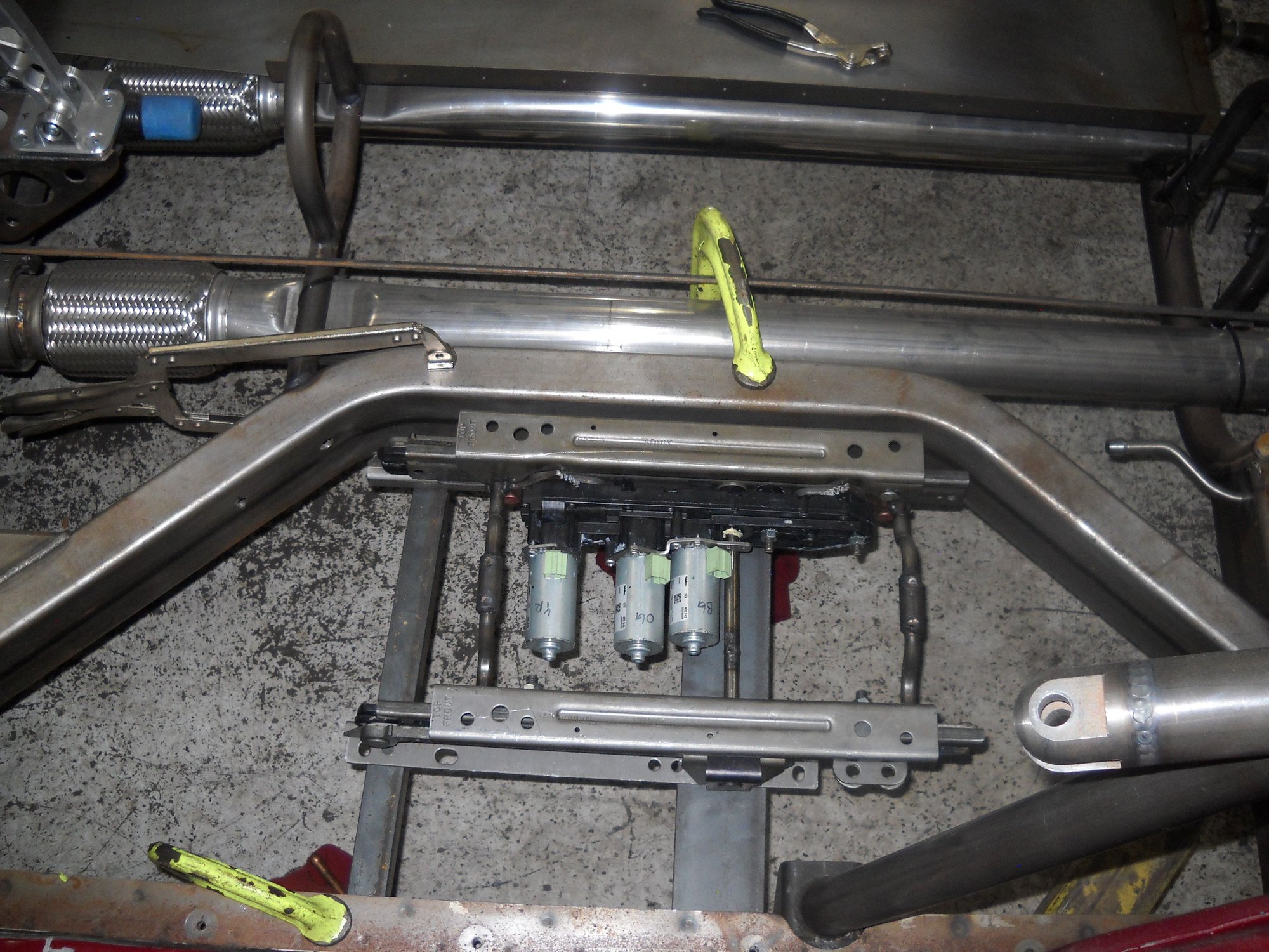

Default Power seat base

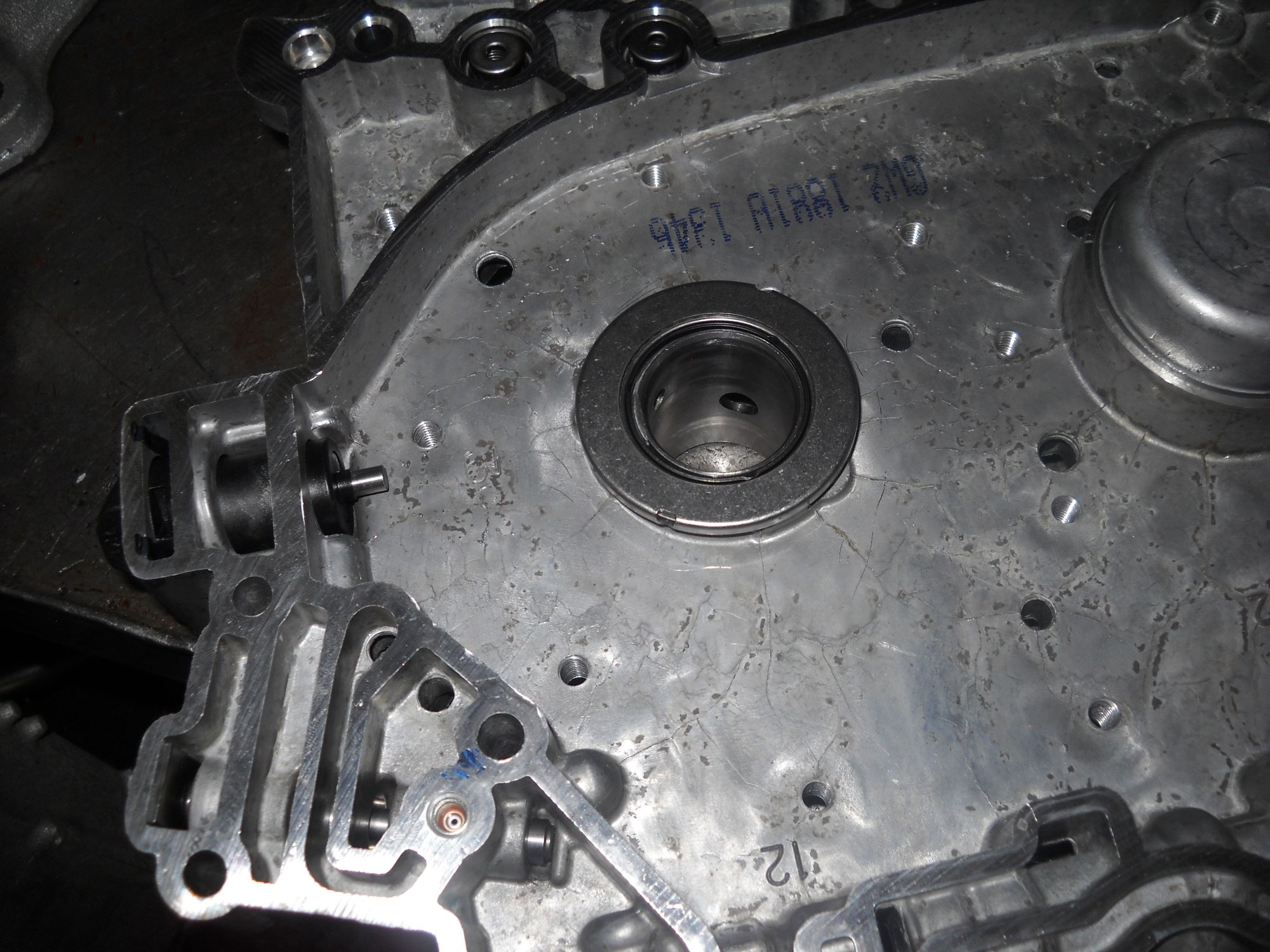

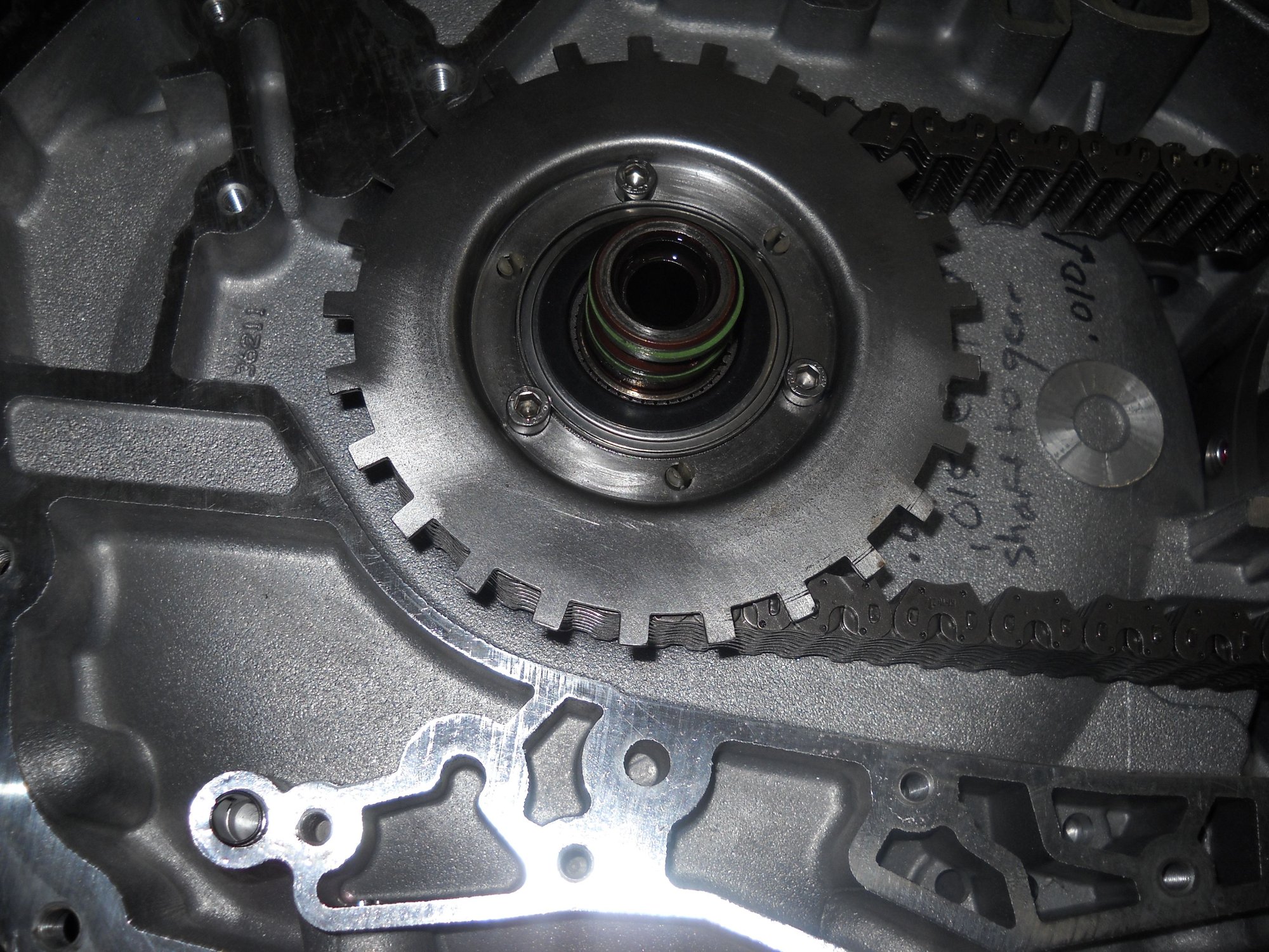

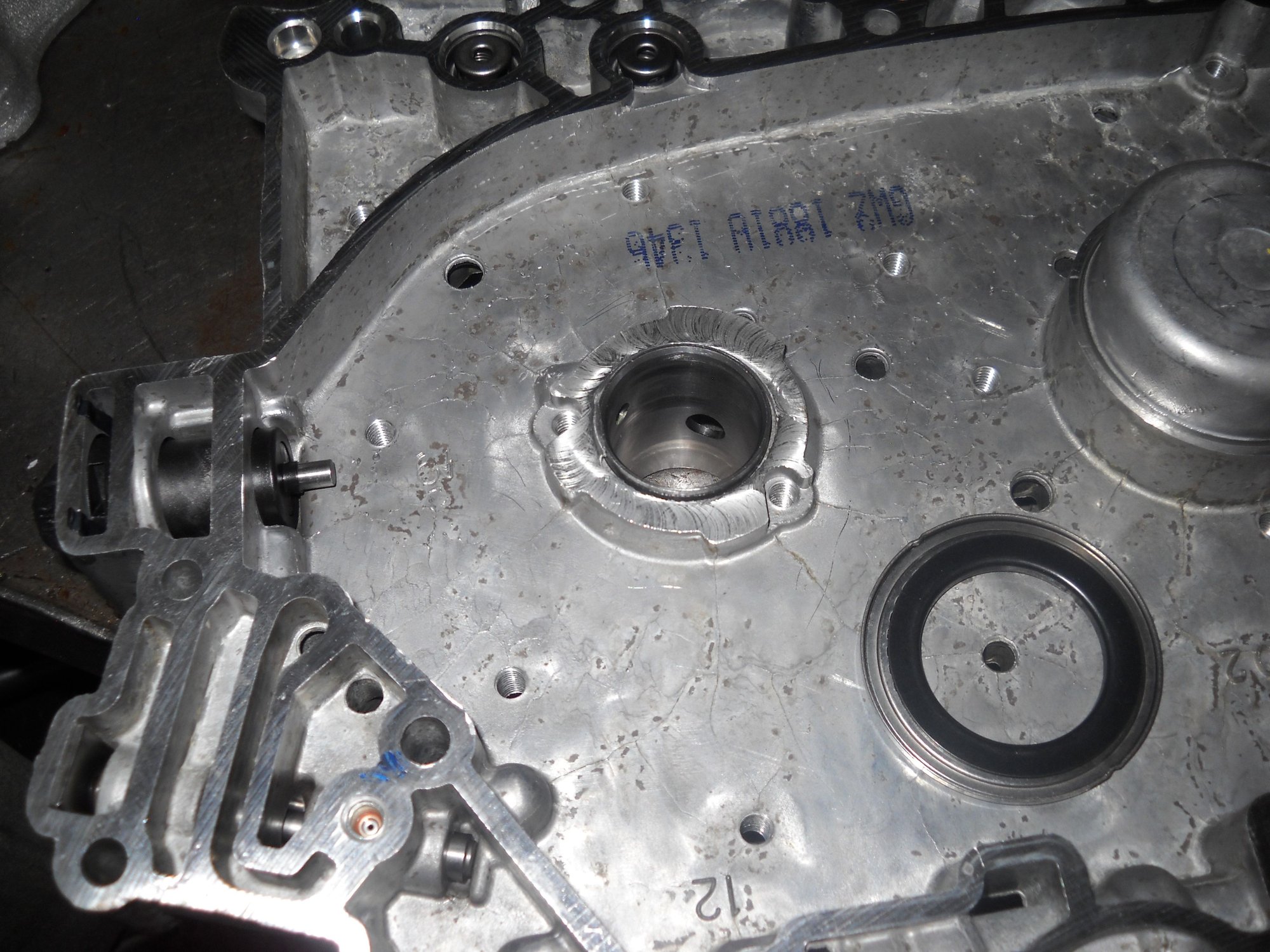

Default Tranny machine work and thrust bearing install
This is work done on my first car SSV FED

You put that car on the scales yet or not far enough along? I am thinking it is going to be way heavy.
