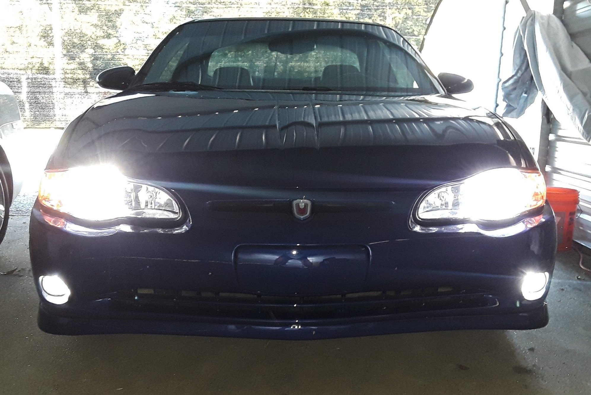

Full LED lights and no Hyper Flash

Default LED Headlights and Fog lights
Plug and play
