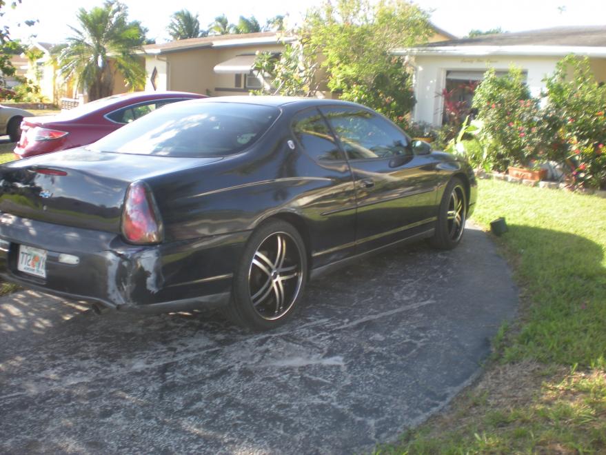

I installed led tail lights now my indicators don't work how do a fix this and where do a get that updated flasher cops keep chasing me and I dont want to spill my fire water

Have you tried removing the bulb, flipping it over and reinstalling? Unlike an incandescent bulb, LED bulbs require correct polarity in order to operate. I'm not sure if a replacement flasher for LED bulbs is available for the Monte or not. Everyone I know that has LED bulbs uses a load resistor to prevent hyperflash.
