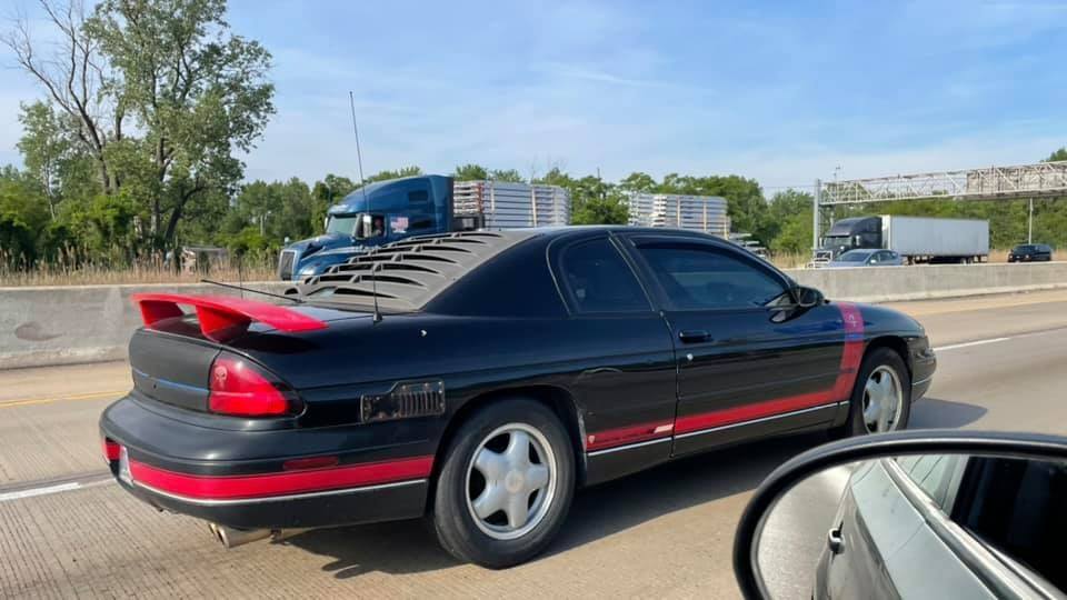

I really like the Louvers you have on your Monte Carlo they were done so well I always wanted something like that on mine.
However someone posted some pictures of a Gen 5 with a louver and now I don't want them any longer Lol. Here are some shots of what that looked like they had to be ABS plastic.
then on the rear quarter what is the louver looking patch thing? Maybe venting the rear wheel well? Reflection maybe?
I am thinking that all MC should be equipped with those Big Spot lights, helps when you go Big footin (lol)
I think the Red is too much
