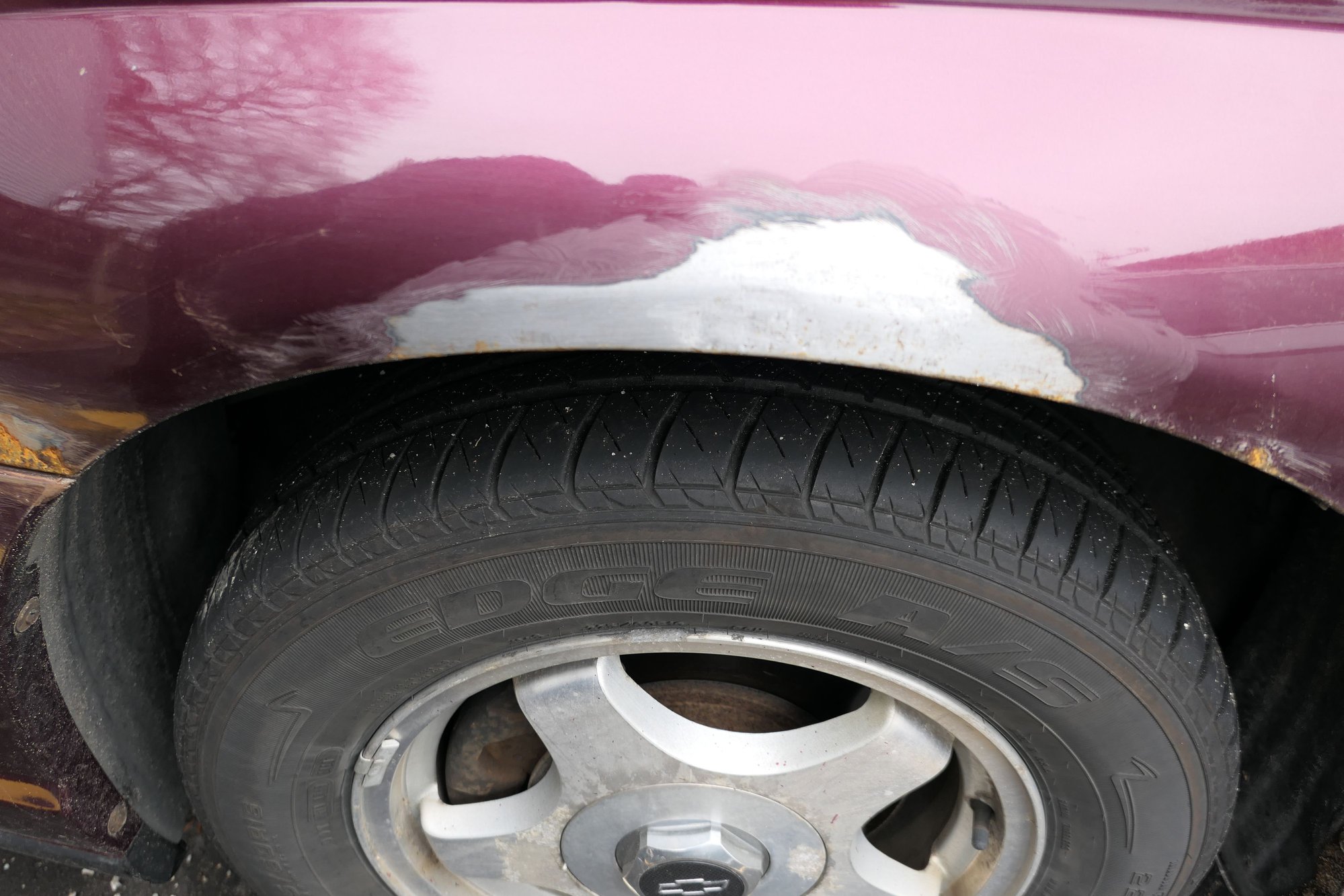

I am going to be bondoing some spots i scraped rust from and there are bumps in the steel, can i just bondo over these tiny spots? do I need to do anything special to the area? I had to gouge some spots with the dremel so there's pits where i did that.
as you can see, theres just tiny spots in it, its not a hole or huge dent, will bondo stick to this?

No there's pits in the bare steel where i gouged out the rust damage, doesn't go all the way through and they arent very deep, but if you run your fingers over that spot in the picture i posted, its bumpy and it will definitely show through the paint. I'm just wondering if bondo will even stick to that. I do have some bondo brand glazing and spot putty, the exact same thing as in that link to fill in the pinholes and minor imperfections. I could get some filler primer as well just as added coverage.

It's completely fine to bondo over the pits. Bondo wants a very rough surface to adhere to, so if anything they'll help with adhesion.
Are you 100% sure none went through? That would be my biggest fear as most normal body fillers like regular Bondo will soak up moisture if they have a path to get it. As long as they're just tiny dents, you're good to go.

Yeah I got all the rust out, it's just tiny specs I need to get, I just wanted to get the majority of it. I can go over the whole surface with 80 grit a few times just to make sure the surface is rough enough and give the Bondo the best chance possible. I will most likely replace both driver and passenger side fenders so I'm not too concerned with how it looks, but I wanted to do them just to practice bondoing.
