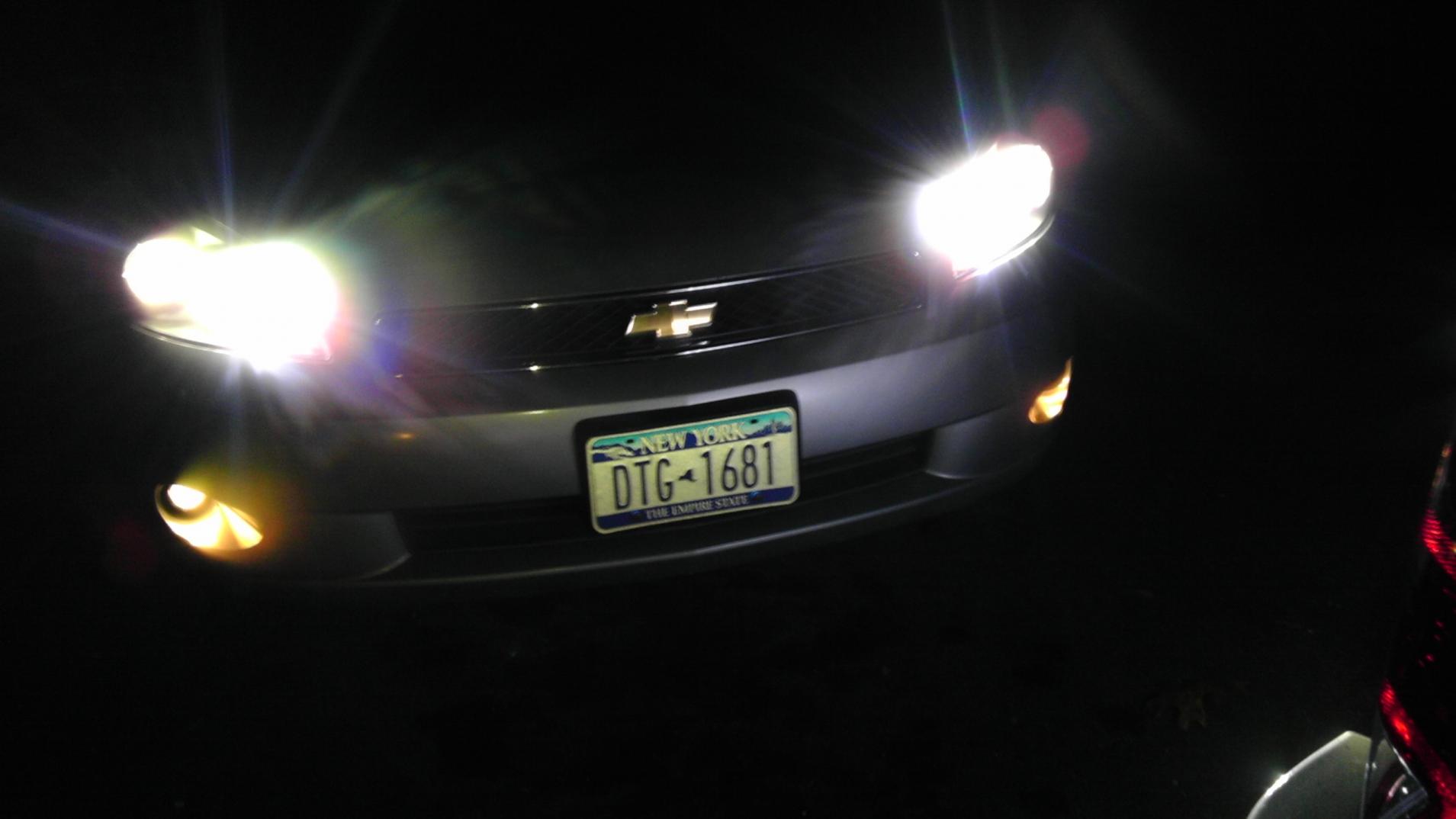

Here are the foglights installed and running. They are Depo brand foglights that i bought from Rockauto.com, every part was purchased from rockauto.com.
Its basically 2 foglight assemblies and 2 foglight connectors part # AC DELCO PT120. Be careful when you purchase the pigtails, PT120 is also a part # for another brand of pigtails that do not work for these fogs.
I simply soldered the connections from the foglights to the black and purple lines in the headlight harness that can be seen in pictures from previous posts.
Thank you everyone for your help and i do hope this helps others looking to install the fogs on their 7th gens!
Good luck!
