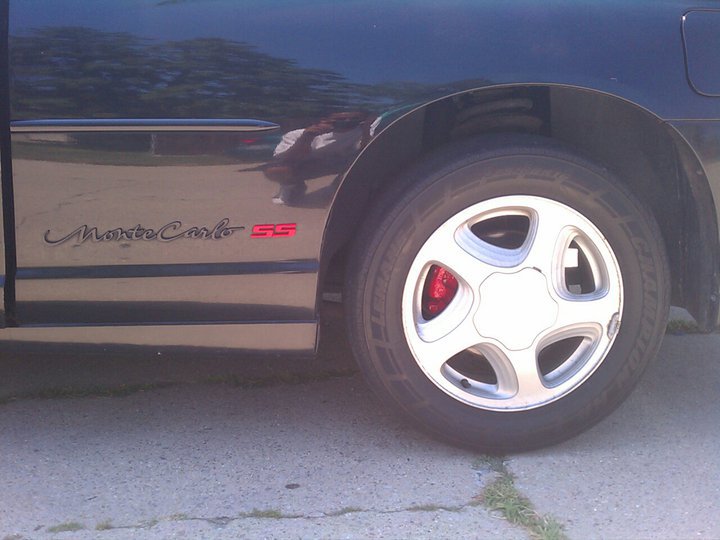

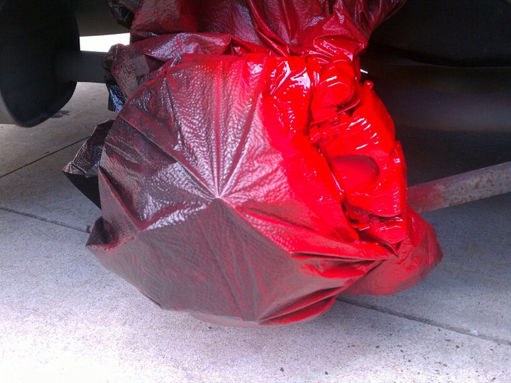

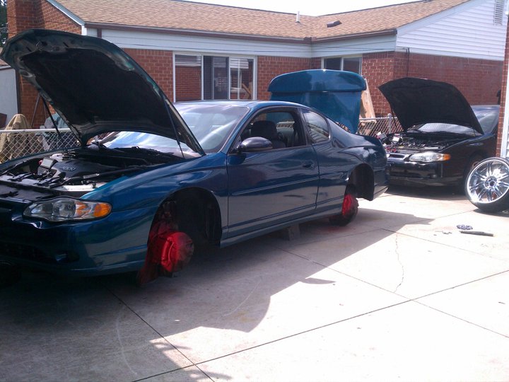

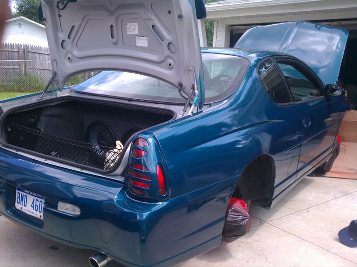

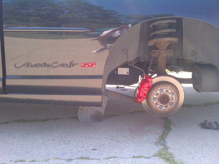

I just went to autozone and bought a can of red caliber paint, brake cleaner, and a wire brush.
I did mine and my cuzin. Just be sure to clean them good..
Attached Thumbnails Caliper-281799_10150255080541379_555736378_7703495_2783552_n.jpg   Caliper-253386_10150255092546379_555736378_7703675_4207097_n.jpg   Caliper-267277_10150255092681379_555736378_7703682_1064190_n.jpg   Caliper-215155_10150255092946379_555736378_7703692_6129997_n.jpg   Caliper-215188_10150255089671379_555736378_7703589_6490160_n.jpg
