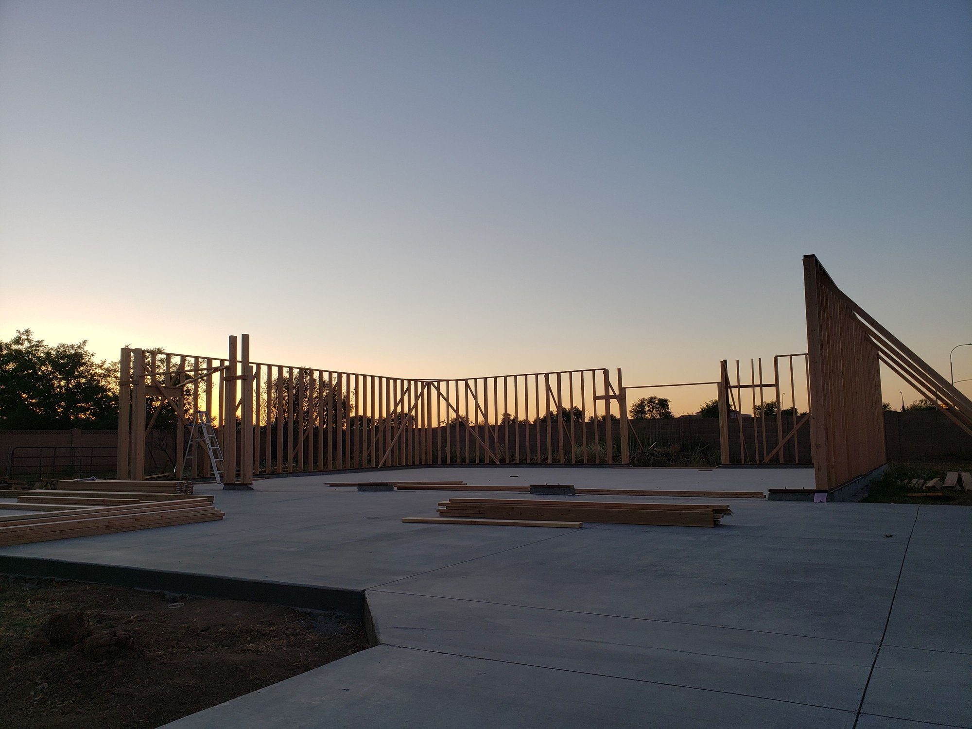

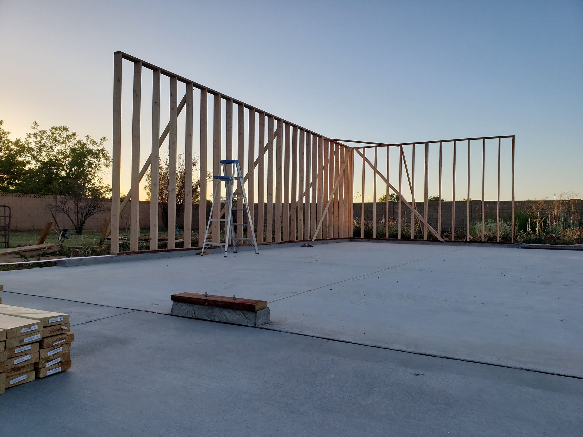

Making some progress again. Got the chalk lines snapped out for the perimeter to square up the building relative to the curbs. Fitted all of the sill plates.
Then finally got started on building some wall sections. Got 2 of them up before we ran out of daylight.
Old May 26, 2024 | 10:21 PM
  #53
Posts: 6,471
Making a bit more progress...
Old May 27, 2024 | 09:59 PM
  #54
Posts: 6,471
Little bit further...

Old May 29, 2024 | 11:39 PM
  #58
Posts: 6,471
Baby steps
Left and right walls are done (minus top plates all around). Rear wall is done minus the frame work over the garage door. Starting on the front wall - got the first garage door frame up.
I've got a material lift rental coming Friday. Job 1 for it will be getting the LVLs up over the garage doors so we can finish the framing above them.
Also coming Friday is all of the wall sheathing and the 2x4 framing for the parapet walls on top. The hope is to get the final plumb/level measurements locked in, add the top plates, and get the shear walls sheathed so we can get these trusses up with the rental machine.
