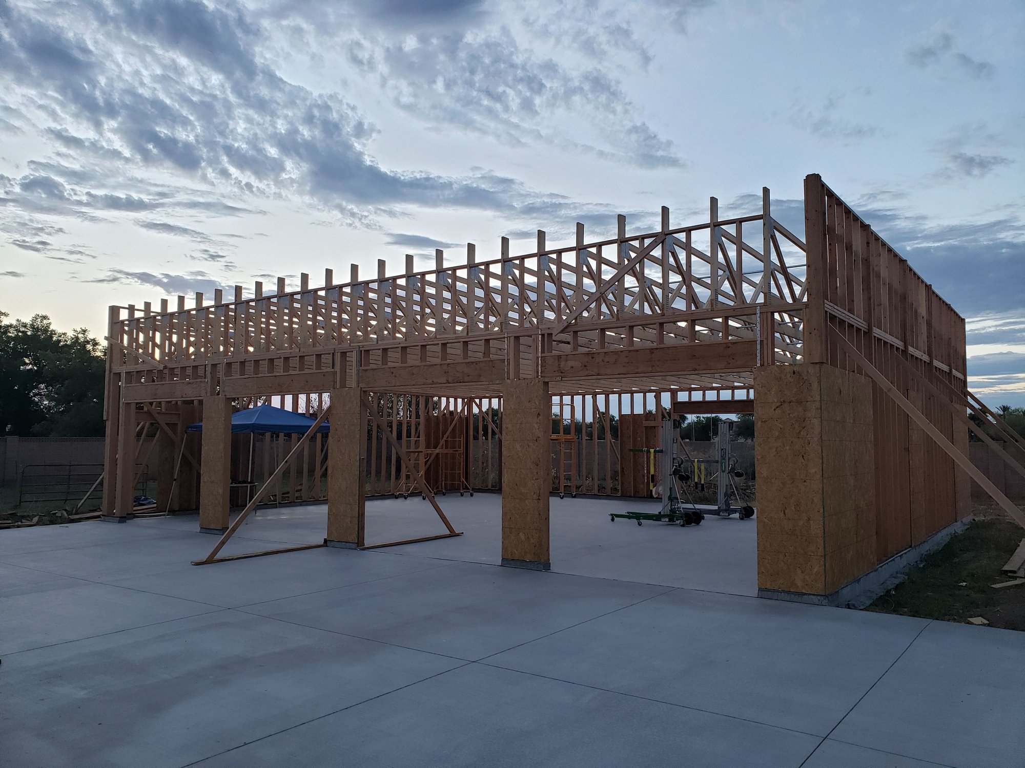

Trusses are all up. Need to put in the blocking in the last bay on the right (its the only one that's sub 24", so I can't use the pre made braces), but its getting close.

No new pics recently. Blocking / bracing is up in the last bay, but it doesn't look much different externally.
Moved on to adding hurricane ties (the new style screws aren't readily available locally) and fully nailing in the blocking. I will say its changed my opinion on the scaffolding. I broke it back down into 2x 6 foot kits. Loaded my tools / supplies onto it, and then wheeled myself from truss to truss installing the added bracing. I'll admit its a lot nicer than going up and down a ladder 100 times. Starting to think I'll get a good bit more use out of them for insulation / electrical / lighting/ drywall.
My big issue is the amount of play in a double stacked kit. I'm already a bit iffy standing on anything at 10'+, but the play in the connections of 2 kits was unnerving for me - especially leaning over the edge. These kits cap out at 3x tall (18' max platform height), I'd never be able to climb on top...

More baby steps. Been fairly busy with other stuff lately so I haven't had as much time to work on this project.
Got the last truss braced up. Got most of the bottom layer of OSB up. Started working the top layer of OSB in the back.
Starting to feel like a real garage inside no with actual walls up.
Also took some scraps to build some side walls for the trailer. Going to start getting some of this old wood to the dump. Lots and lots of form wood from the concrete phase that's junk and needs to go.

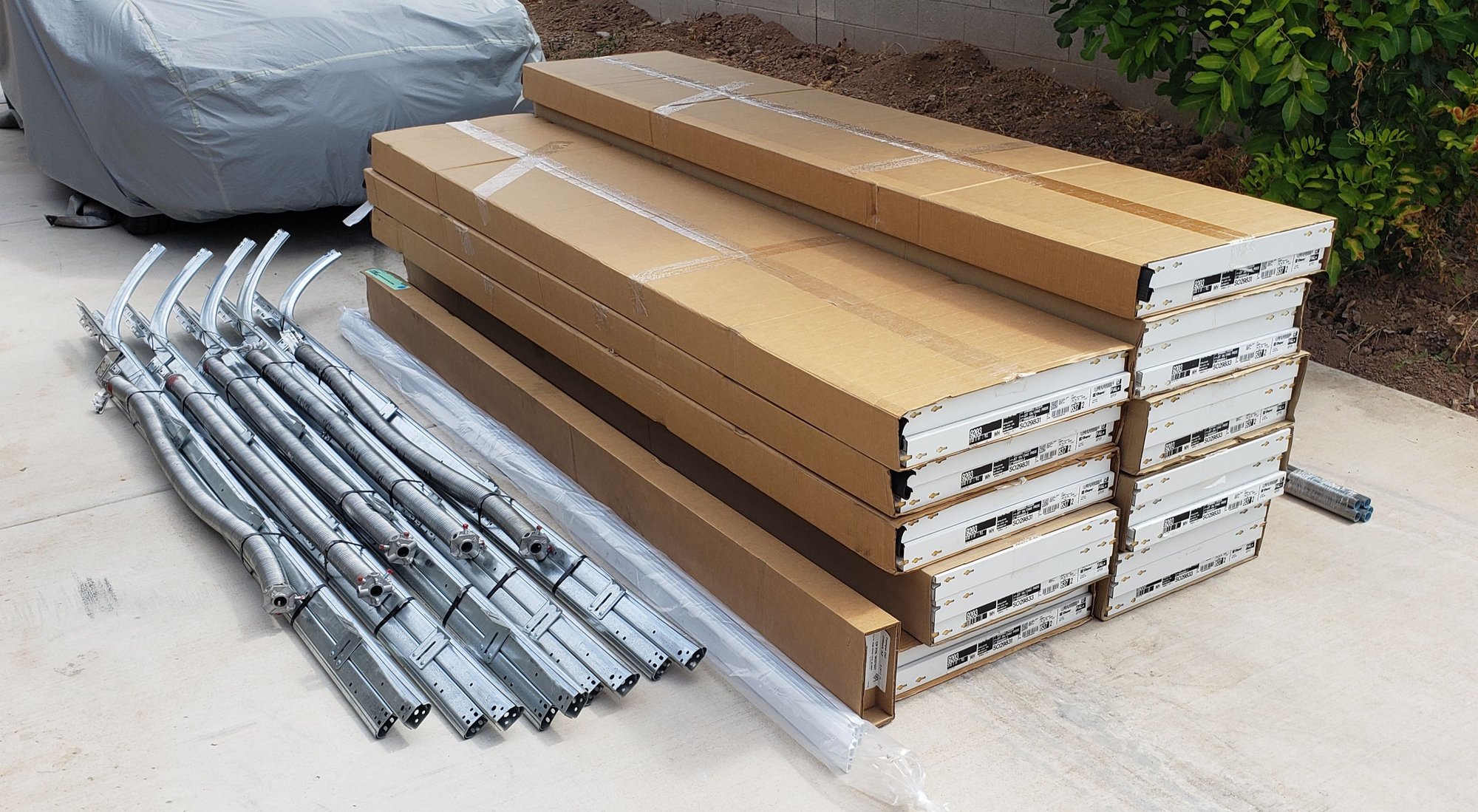

Garage doors are here finally. I was getting nervous...
Last week was excuse after excuse. Won't answer the phone at all, text responses were hit and miss, but usually with a BS response about why things were slipping out again.
Read reviews of this place online and noticed numerous complaints for this exact same thing (apparently they're the Home Depot go to in the metro for installs + delivery of the DIY doors). One from a year ago said they took 4 months to finally deliver (remember this isn't building them, this is just the place that takes them from the local distribution center to your door). Final straw was a review from 3 days ago, they'd held this guys doors for 3 weeks - employees on the phone cussed at him (I'm sure not totally unprompted, but still - they're holding thousands of your merchandise hostage), so he asked to speak to the owner. No dice - owner recently got booked into jail...
So today I called back Home Depot to escalate things on their end. I'm getting frustrated having to push for release of my own product- the place I bought them from should be doing the legwork.
Magically at 9am they arrived. No warning, just showed up. Not sure what finally prompted it, but I'm glad to have them.
Only minor issue was one install parts box was demolished / had a giant hole. Did inventory vs a good box and all is fine except 1 bracket is mangled. I could probably save it, but I'll call for a replacement - shouldn't have to do more work for that kind of money.
