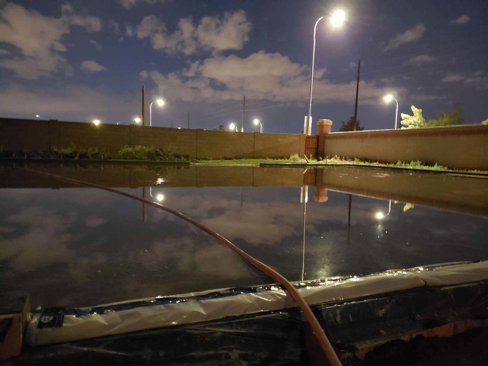

Concrete is done! They were good using my forms as is and they held up fine. Got the whole process done in one day - 5 trucks of concrete pumped to the site, power floating, and saw cuts (they had a cool new blade that lets you cut as soon as it'll hold your foot weight- they made very nice cuts without the plumes of dust you normally get cutting dry).
Doesn't look quite as pretty post saw cut due to sweeping up the dust, but all of that washes right off.
Managed to make some impromptu sandbags to block off the door openings. Filled it with an inch or so of water to help the curing process.
I'm midway through refinishing the pool (repaint and plaster cracks repair), so I can't really start on building this yet anyways. Maybe in a couple weeks I can start actually building something.

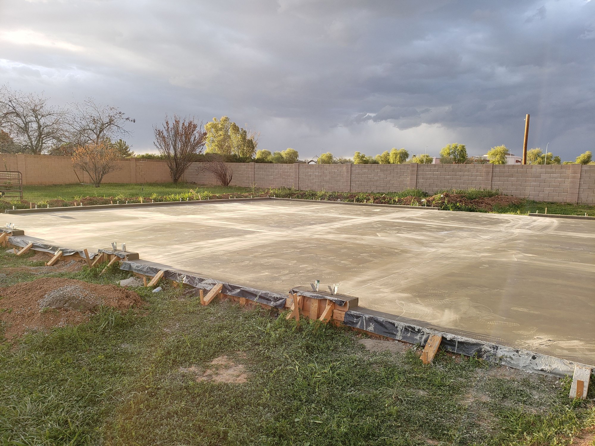

And a daytime pic:
Put the sprinkler on a timer to keep it topped up.

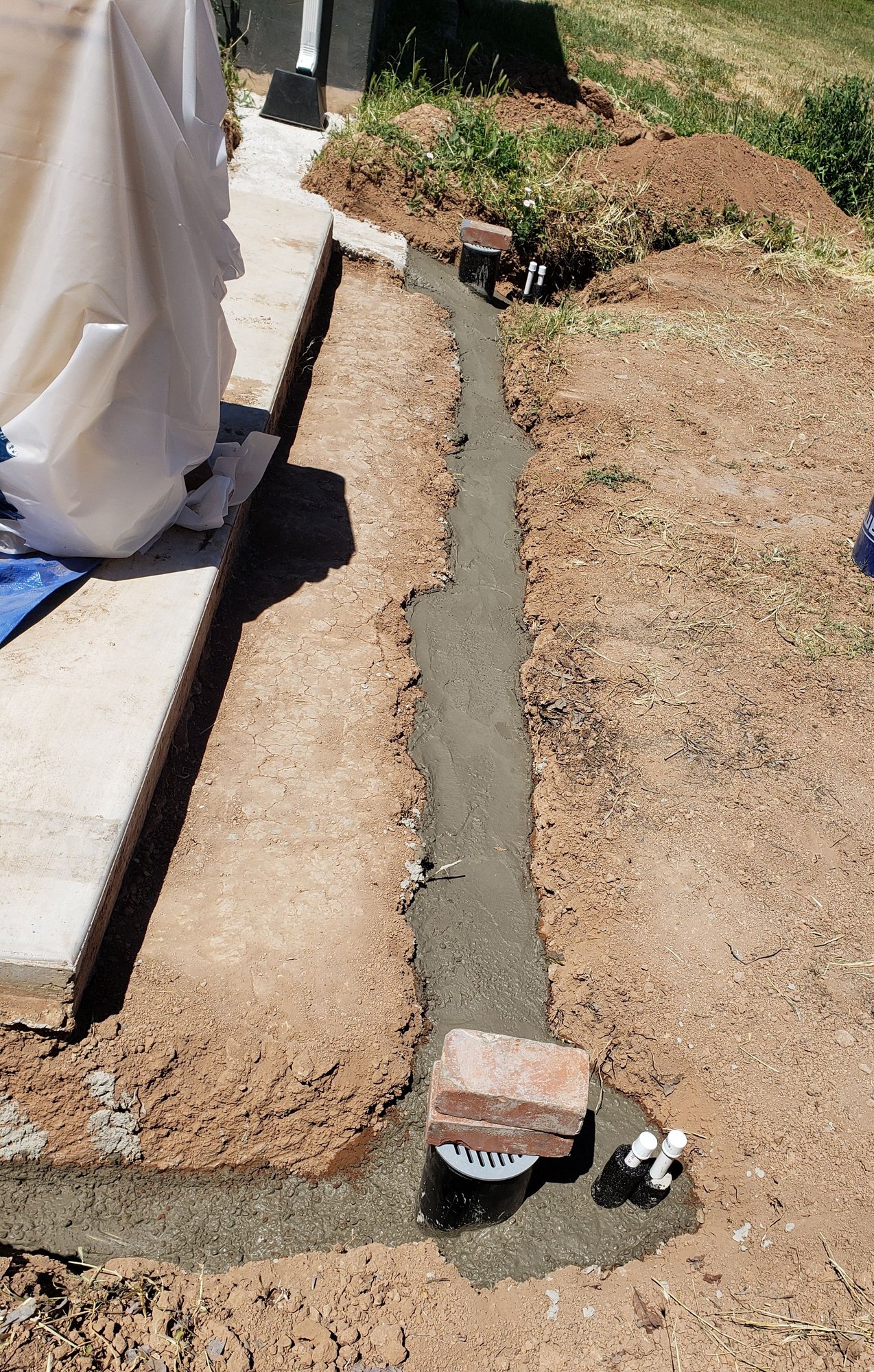

Ended up pushing forward on the rest of the driveway project to connect the RV driveway we added all the way back to the garage. Itll be a lot easier to get materials transported back there if we've got solid surface from the street to the garage. I bought a used pallet jack a year or so ago so that would be a real back saver for material transport.
Unfortunately I ran into issues proceeding as we were already halfway through a drainage project on the existing 70 feet of RV driveway. When we put that in, I didn't realize how much water that chunk of dirt was being forced to absorb. We also made matters worse with the covered patio project.
So the house roof is a single slope to the rear. A large portion of that now drains on to our new covered patio which is single sloped to this RV driveway. So there's probably 2kish SF of roof feeding into this one area.
To make things worse, the driveway to the street is sloped down towards the house/ attached garage. So half of the rain from the street and all of the rain from the front driveway (as I put up sand bags to keep the water from going into the attached garage) is also forced into RV driveway area. It isn't uncommon during our rainy season for that driveway to go partially underwater.
So our fix was to dig trenches down both sides and install regular drains to catch water - all dumped into a double dry well out in the back yard. Problem is it has to cross over under the driveway - so we had dug a trench where the 'new' driveway will go. I needed to get the rest of the piping in and concreted over to allow us to proceed with the rest of the driveway.
As of this weekend, the piping is run up to where it diverges from the driveway to head to the dry wells, and we've fill concrete up to the top of the trench (6" below the height of the current driveway).
The concrete place is tentatively scheduled to come out next week to start prepping for the driveway pour.
The other 2 pipes are for irrigation. We eventually plan to add trees along the fence line to cut down on road noise, so we wanted a way to plumb automatic irrigation to them while we had the trench dug. Will cut and run them underground, but left them way over tall for now to easily locate them when we're ready.
