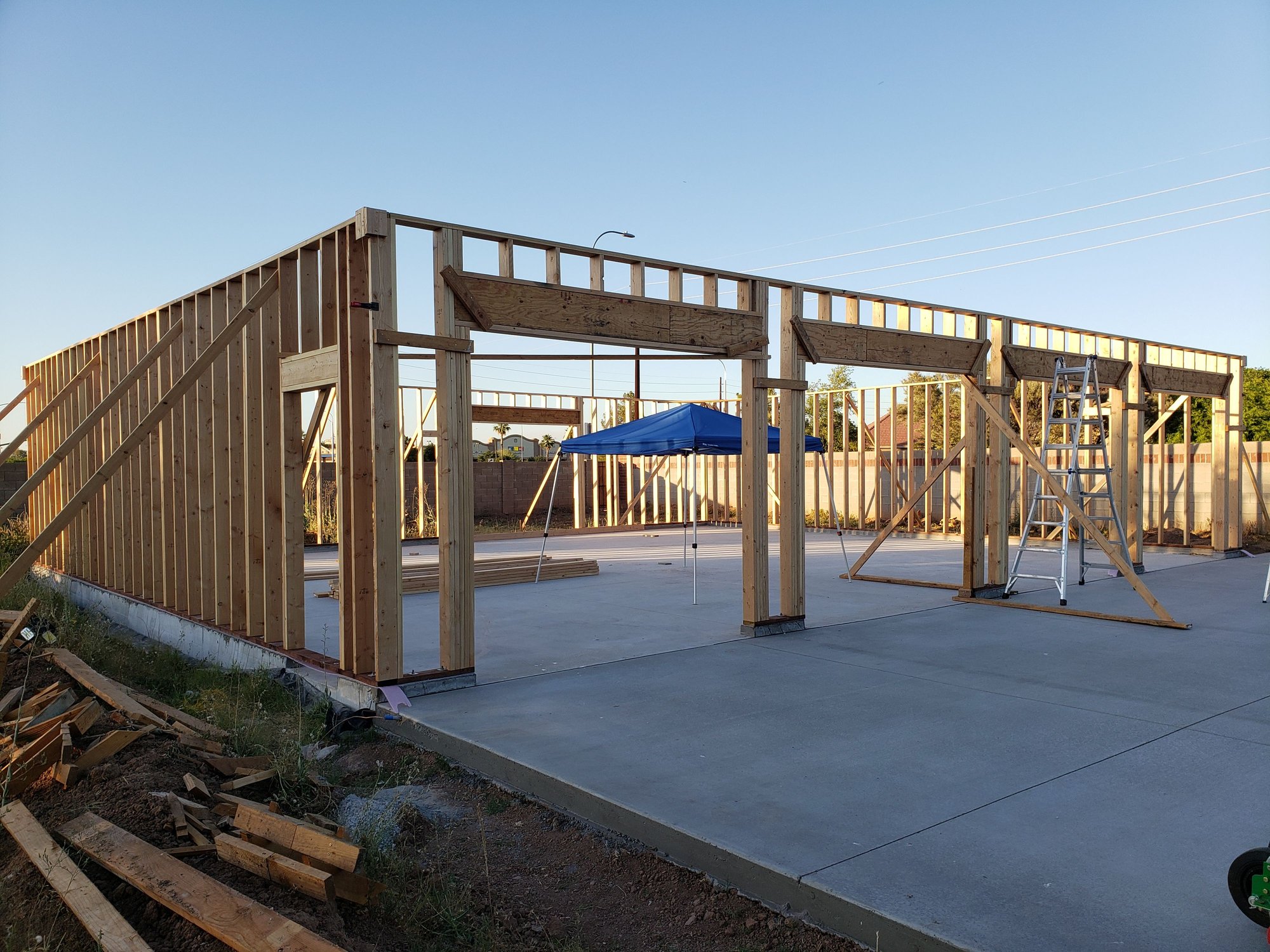

Well, now I at least have all 4 walls connected around. Lots of temp bracing to keep things in place. Still need to add a couple along that front wall to lock in the position forward + back 100%.
Material lift is due in first thing tomorrow so we can get the LVLs up and the framing above them completed, then I can slap on the double top plate.
Unfortunately the next lumber delivery got delayed to Saturday, so no OSB to start sheathing until whenever they show up. Without having good shear bracing installed, that also means we likely aren't even attempting trusses until next weekend.

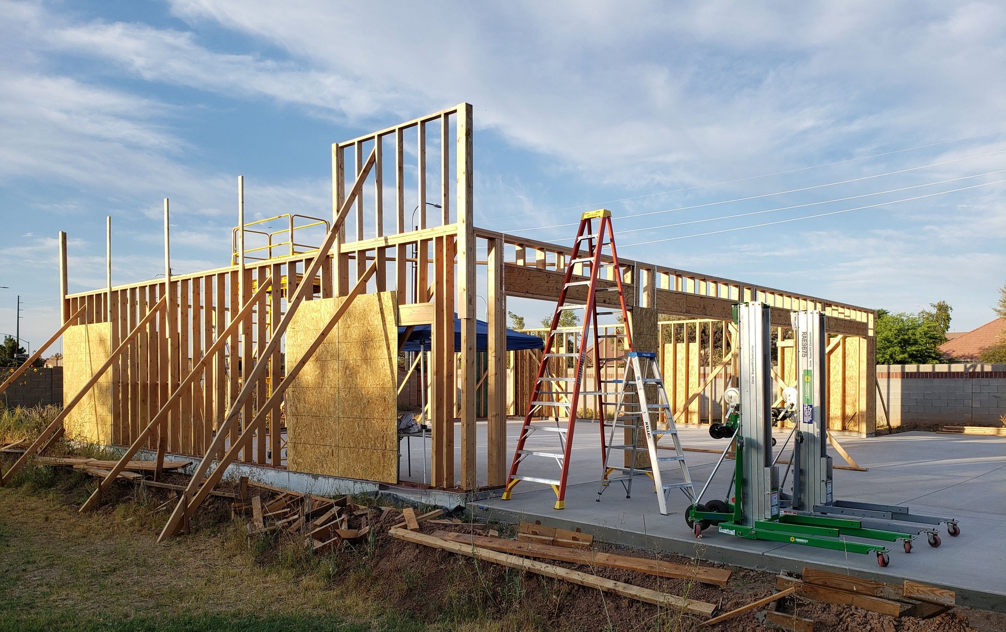

Wall framing complete besides the double top plate and blocking.
Today's fun is plumb and line to get her ready for sheathing and locking everything together.

Back to work after a week off, so progress has slowed substantially.
Still knocking out quite a bit on nights and weekends:
-removed the temp bracing on the headers, replaced with Simpson straps
-put up most of the braced wall sheathing OSB
-built supports for the starting parapet wall (first truss ties to it, which then sets the position for the rest of the trusses)
-built the sections of the side parapet wall, installed the first section
-built the front parapet wall sections (between the trusses - acts as both blocking and intermediate studs) and rear truss spacers. Hopefully this will help speed truss install by having drop in blocking on the ends.
My hope is to get the rest of that parapet wall up, plumbed, and secured this week. Crossing my fingers for truss install next weekend. The material lifts in front are what I plan to pick them up with - one at each end. Ive already got all of the straps and rigging.

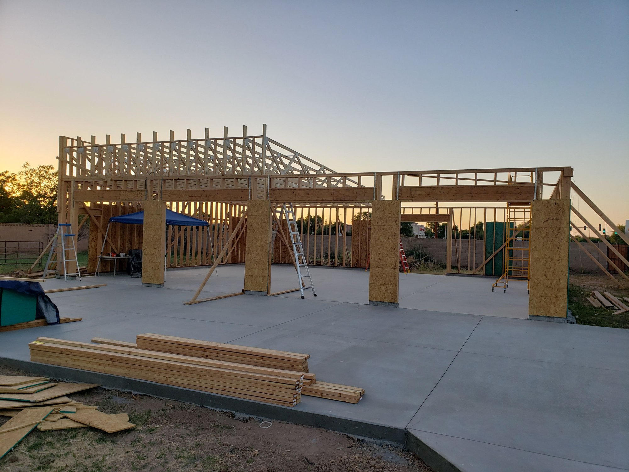

Got the side parapet wall in place and braced up. Also got the first 4 trusses installed.
Ended up using two manual material lifts one at each end of the truss. Working great so far.

Halfway there. Plan is to finish the rest of the trusses this weekend.
