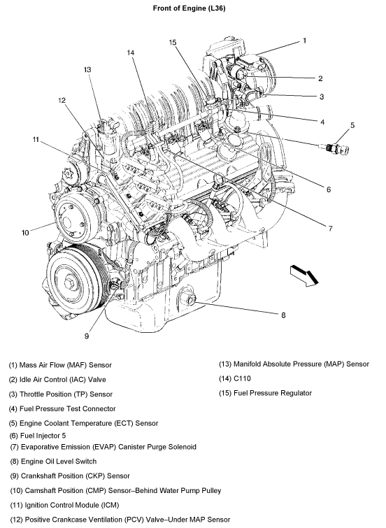

Try unplugging the coolant temperature sensor. Unfortunately you already checked the relays and the refrigerant level which are the easiest quick diagnosis.

Unplug it & try running without it? We did just replace that a couple days ago, but I didn't try turning it on disconnected....
