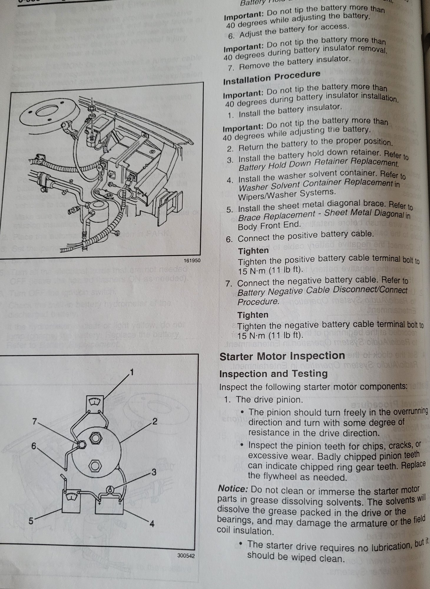

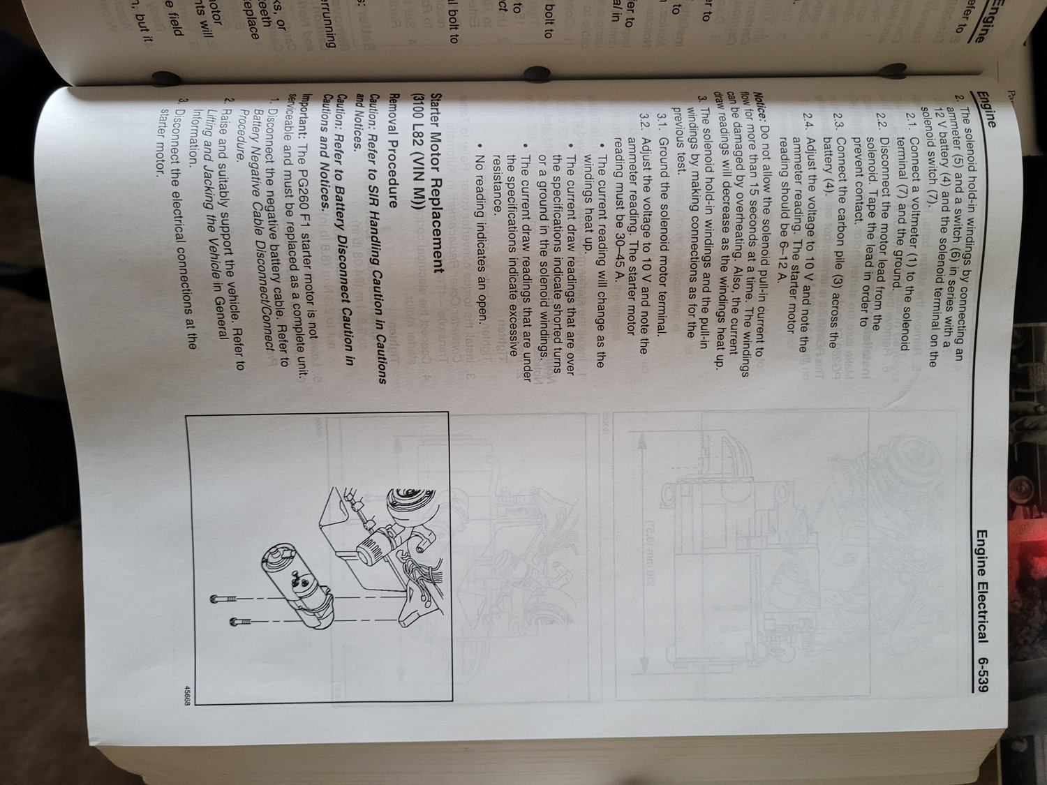

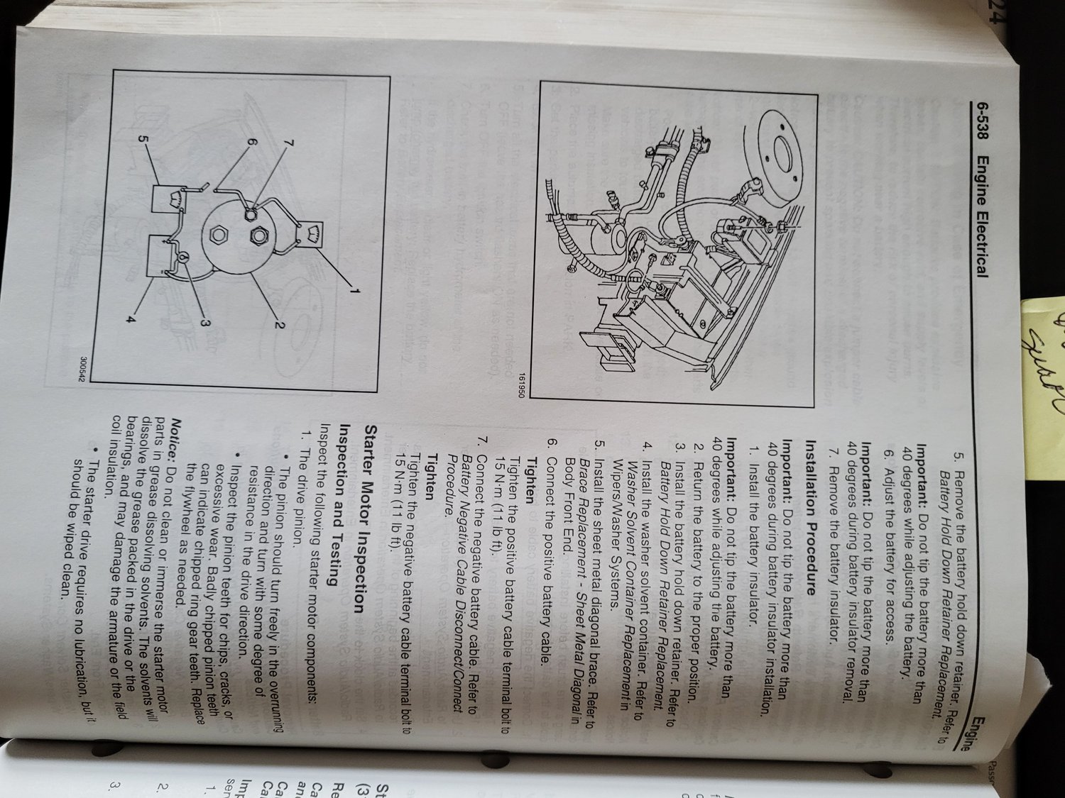

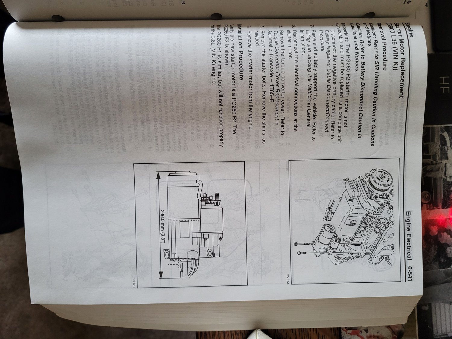

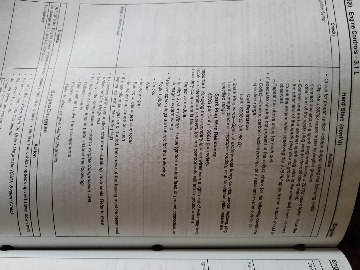

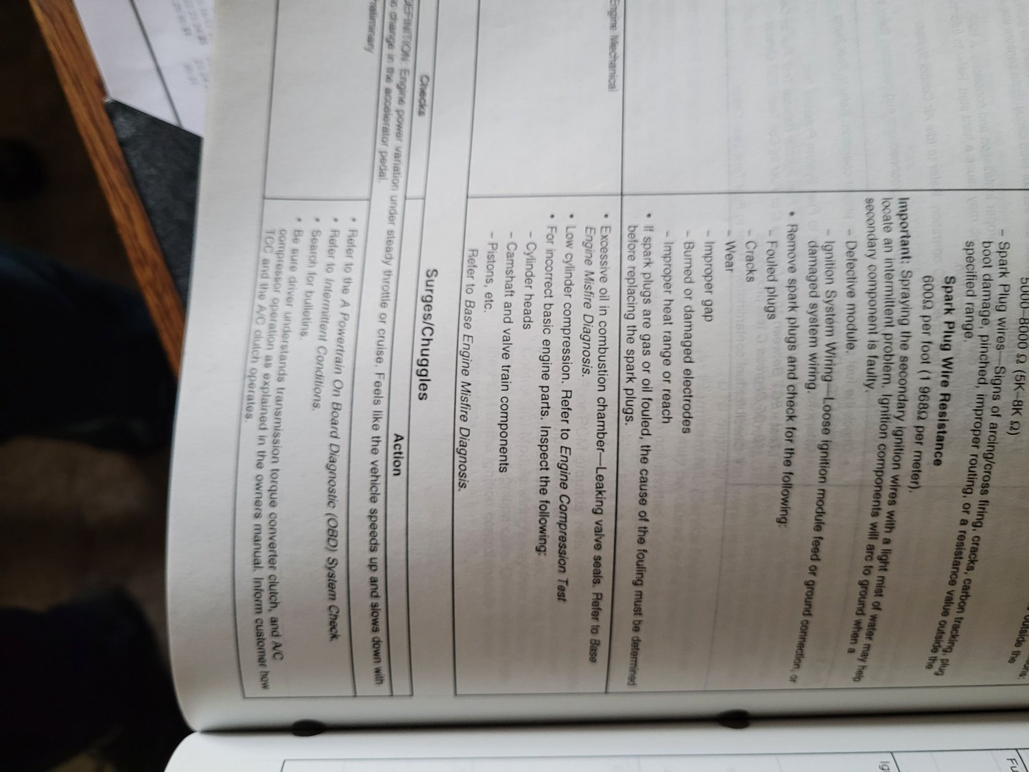

I found my service manual and copied some of the pages that you might want to review.
You might want to pick something like this up I got mine on ebay. that way you can get an idea what the factory repairs are . I took multiple shots here because sometimes they come out blurry so this was you have a few to choose from so if you encounter the same page it was intentional. There is some starter info on here how to stuff. Also some hard start issues and repairs.
When I do a repair I usually try to review as much info as I can prior to doing the work. I take a photo of how it looked before I take it apart also.
