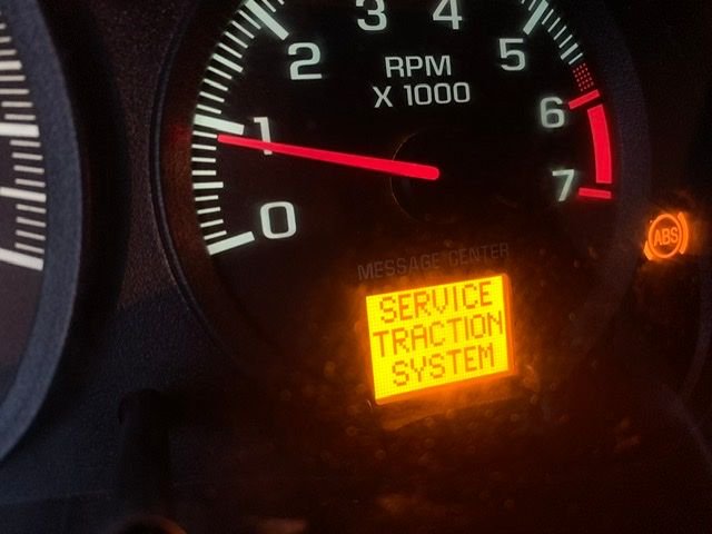

Around Thanksgiving California got a lot of rain. It was at this time the service Traction System light showed up on the message center.
As it showed up my gauges would reset without warning, at the same time my brake pedal would modulate strangely. This went on for about 3 days

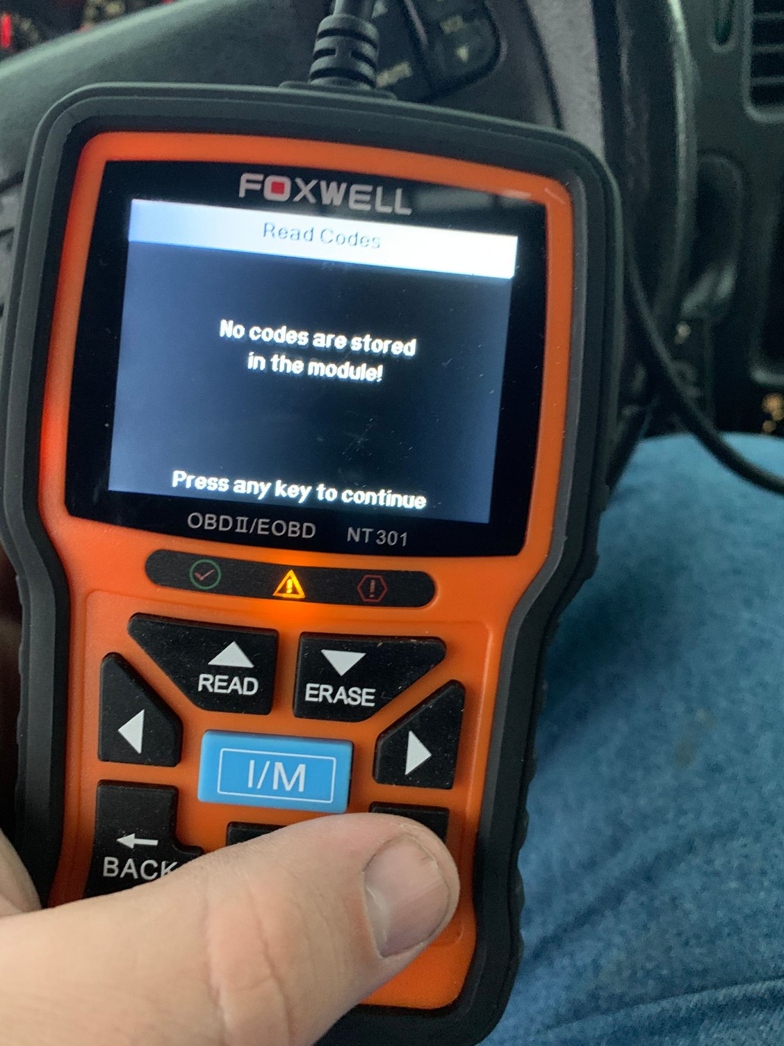

I plugged in my code reader and (no surprise) no codes were in the ECU

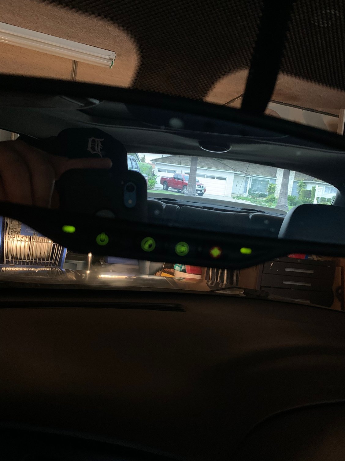

and the OnStar light on my rearview mirror will shine red

When this happens my OnStar light will return to being green
