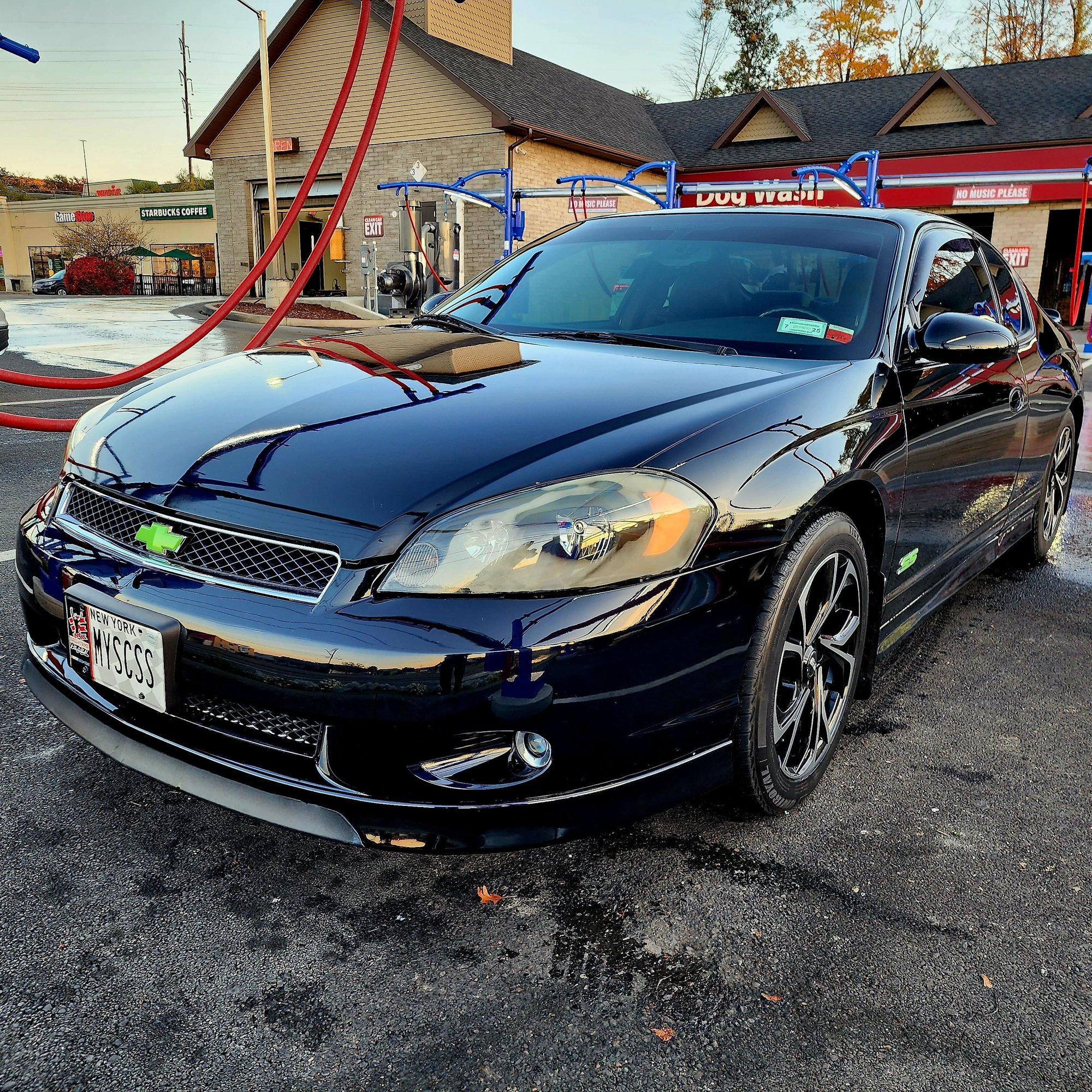

Well... here she is... I named her Lucy!

Beautiful car!!!
