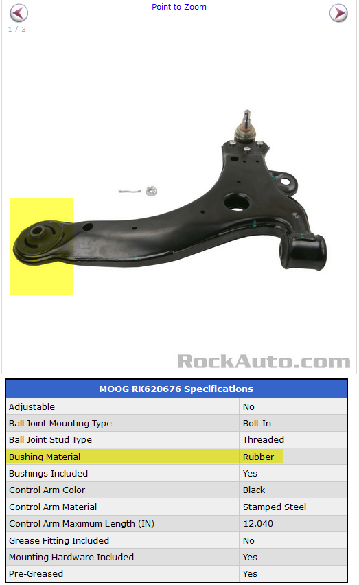

If that is true that Moog RK620675 and RK620676 have the updated vertical bushing, then RockAuto needs to update there catalog. The pics still show the old rubber bushing and the description makes no reference to the use of the spherical bushing. The term "Problem Solver" is what Moog advertises all their products as (that is not exclusive to the spherical bushing). Even looking at Moog's link, no mention of the spherical bushing. I am wondering if the rep at Moog did not understand the question. If you are wanting my recommendation on the bushing, you need this (K200787):
https://www.rockauto.com/en/moreinfo...t=7532&jsn=956
This link goes more indepth about it:
https://www.moogparts.com/technical/...g-failure.html
Listings for the control arm:
https://www.rockauto.com/en/moreinfo...=10401&jsn=958
https://www.moog-suspension-parts.com/moog-rk620675
If you receive the control amrs and they DON'T have what looks like a rubber dust boot over the highlighted bushing and has the two slots, it is a regular rubber bushing.

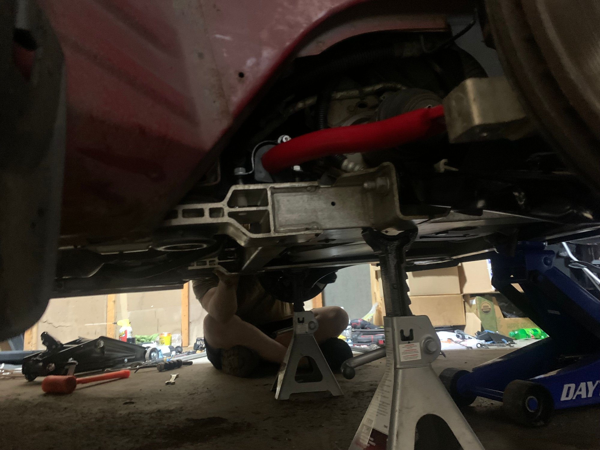

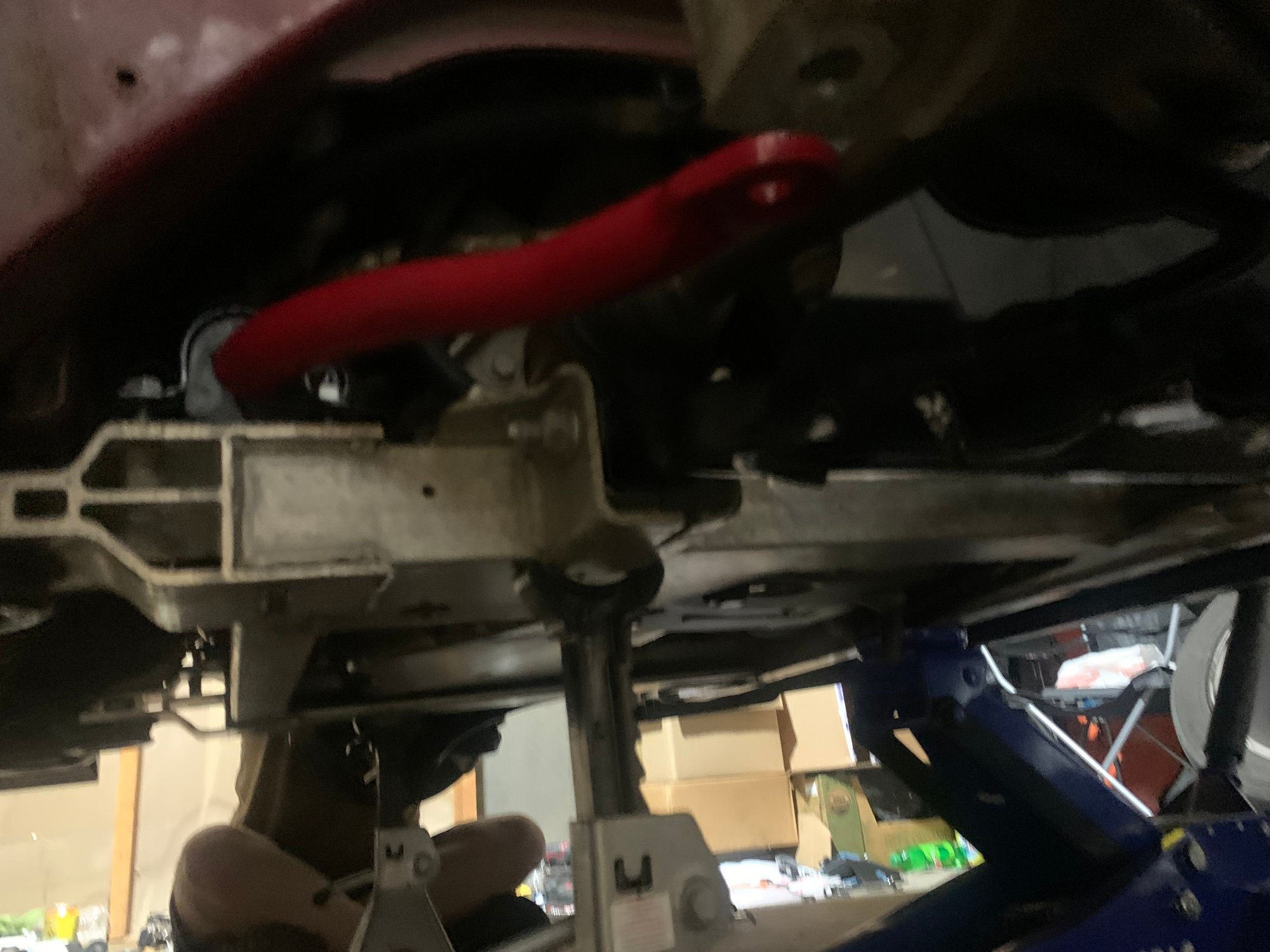

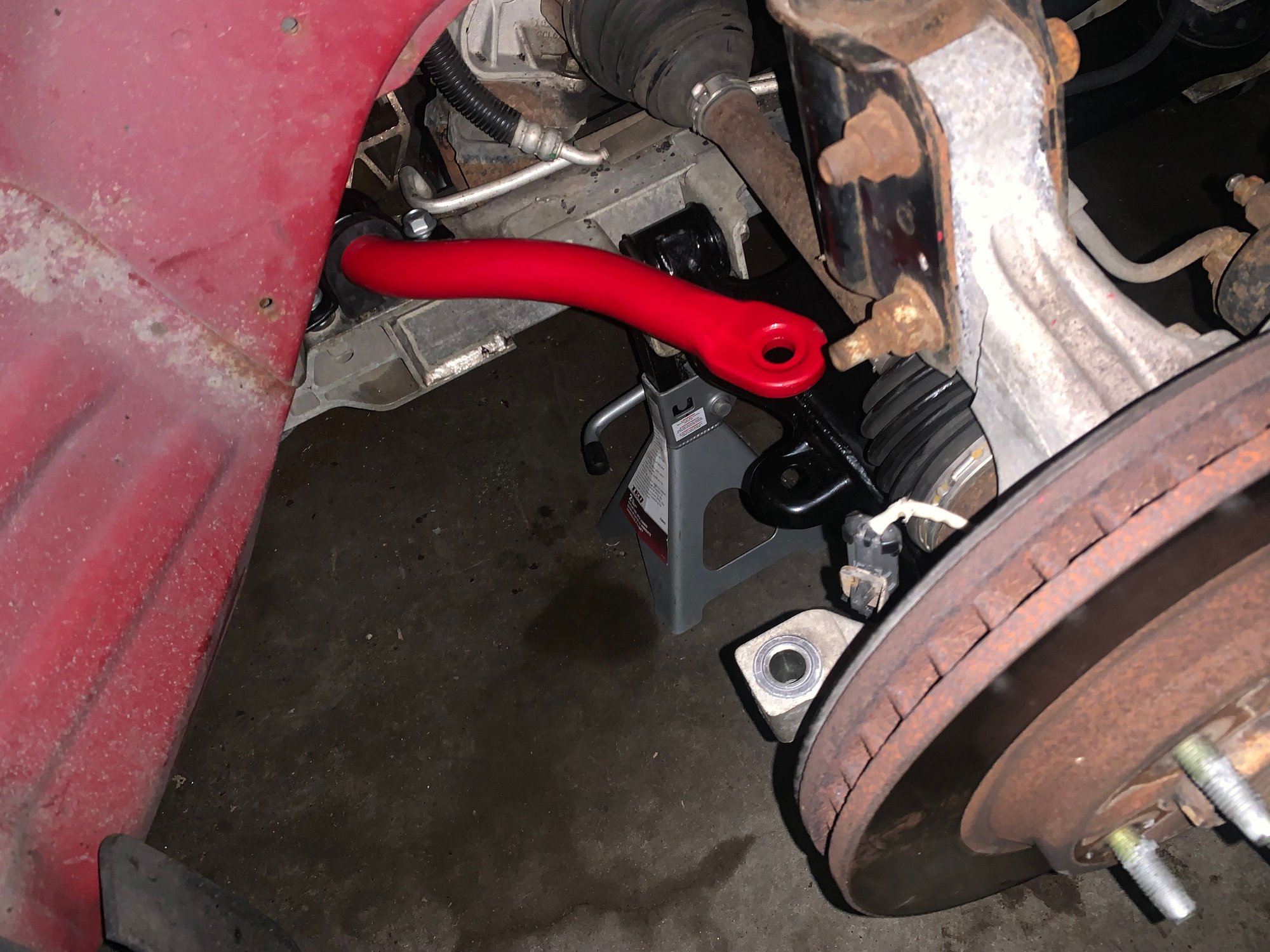

Hello everyone! I was able to get my driver side control arm installed finally! I also was able to get the stabilizer bar shimmied in to its home - I didn’t touch the subframe bolts because I just didn’t want to deal with that; I know my limits for now.
I need to pop my tie rods in, adjust/tighten the stabilizer bar, and finish it off with the stabilizer links. This has certainly been a painstaking process but I think it will be worth it when I’m finished completely.
here’s a few pics so far - the flash on my phone was acting up so I apologize for the poorly lit photo.

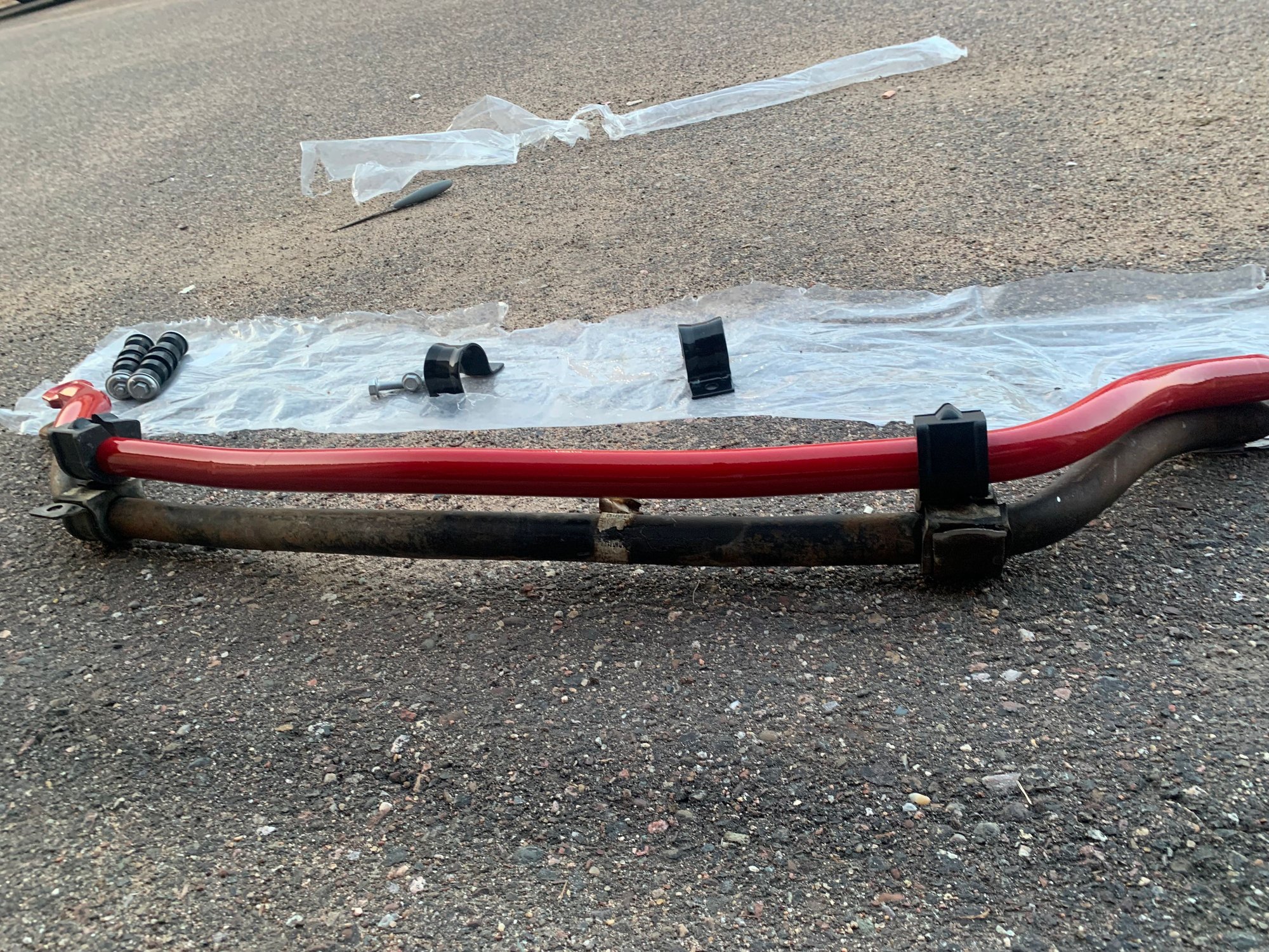

ZZP/Stock sway bar comparison
New Control Arm (I used Dorman electrical zip ties to hold the cables to the new control arm)

ZZP front sway bar w/Moog poly bushings. No fitment issues; original sway bar was broke at both ends (see pic)
