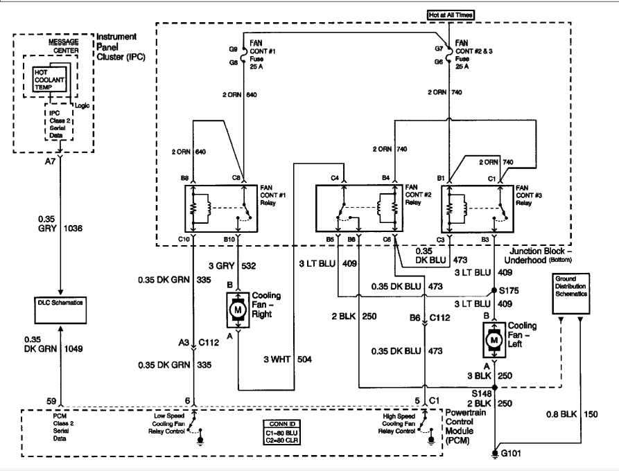

The fans operate in a series configuration and parallel configuration to obtain different fan speeds. In the low speed operation if the right fan circuity opens (electric motor burns up) up then neither fan will work, but it sounds like high speed doesn't work either. I attached a wiring diagram that may help you out. I would make sure your fuses you replaced are getting 12vdc. If they are then Remove the fan connector of the right fan. I would put a multi meter (volt meter) on Gray wire of the right fan and then the other wire of the multimeter on a good ground. See if you have 12vdc when the low speed fan is on, easiest to do that is turn the AC on. If you have voltage there then the relay is good as well as the PCM control. Then plug the right fan back in and check with your Multi meter from the left cooling fan blue wire of the fan connector to a known good ground. See if you have voltage when the AC is on. I suspect you will have voltage at the right fan connector but when you test the left fan connector blue wire to ground you won't have voltage. That would tell me your right fan is dead and since the left fan is not even coming on with high speed (both fans are in parallel circuit) then that fan is dead as well. Final step would be to remove the fan connectors and ohm the pins of each fan separately and see if you read a resistance to the electric fan windings. If your meter shows and open circuit then the fan is dead.

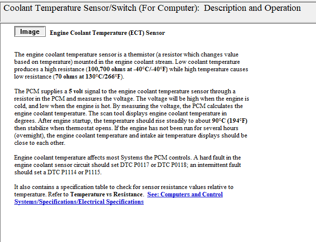

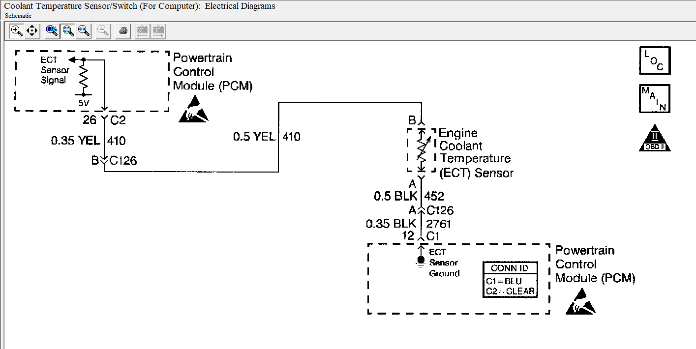

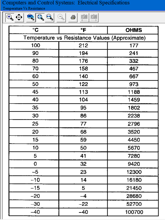

I am attaching some paperwork to check the resistance of the temperature sensor, since you don't know what the actual temp is I would start with a cold engine and look at the chart for ambient outside temperature or garage temperature if you park it inside. Unplug the connector while the engine is off and check resistance across the sensor. See if it lines up with closely with the matching temperature it should be reading.
As it states in some cases some codes in the PCM and temperature sensor faults will cause the PCM to run the fans all the time. You can also check the one side of the coolant temperature plug to see if 5volts is being sent to it from the PCM.

I understand that, however how do you think the gauge in the dash gets its signal from? The sensor you replaced, if the dash is not displaying the correct temperature or no temperature at all then it has to the be sensor input to the PCM not being read correctly by the PCM. I have bought parts before that fail either a short time out of the box or don't work at all. It also could be where the sensor gets hot and then the circuit opens up or shorts. All I am saying is use what I gave you and make sure you are receiving the correct voltage to the sensor with the key on and check to see if the resistance of that new sensor is within acceptable range.
