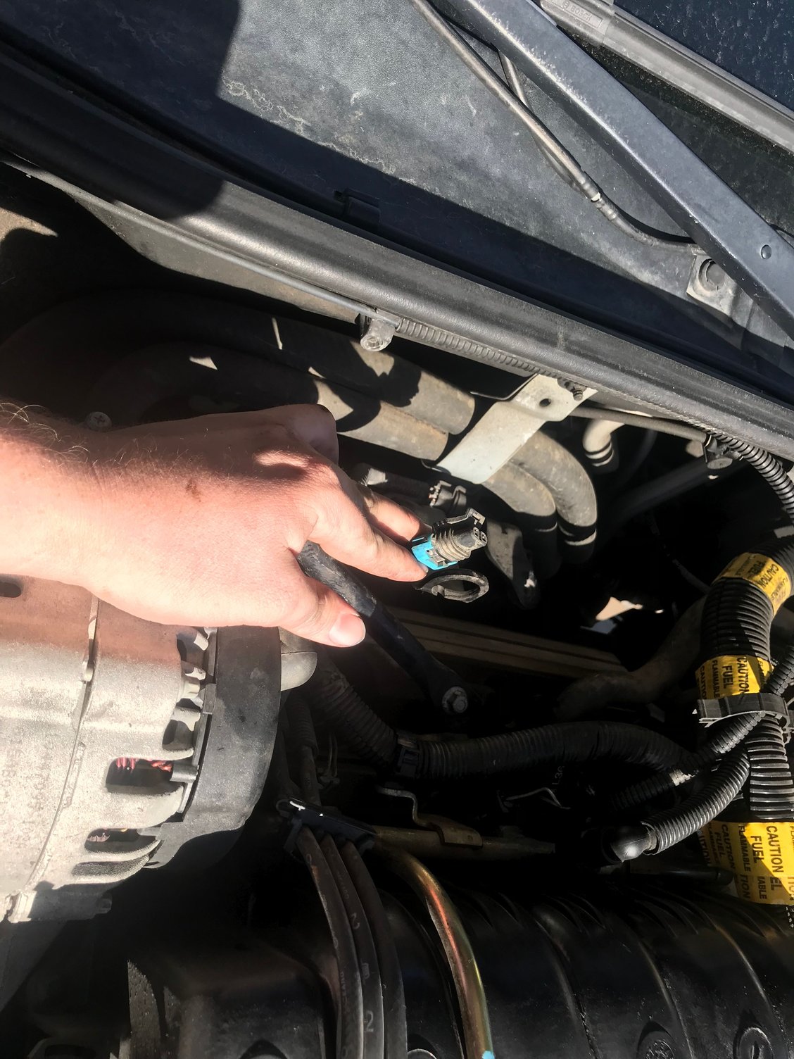

Any idea on we’re this plugs into my car is overheating and while trying to find the problem found this lil thing hanging by the alternator. Any ideas on what could be causing the overheating just replaced radiator and fuses not to long ago. Radiator fans not turning on

That's an extra harness plug,,, it goes nowhere and has nothing to do with your issue. whitch fuses? for the cooling fans? if they have blown in the past then you have a problem in that circuit. no fans running =overheating. you could check to see that both fans spin freely and aren't hitting anything to prevent them from spinning.

they are freely rotating checked code from engine said it was relay replaced all three relays 2 4 pin and 1 5 pin still having same issue
