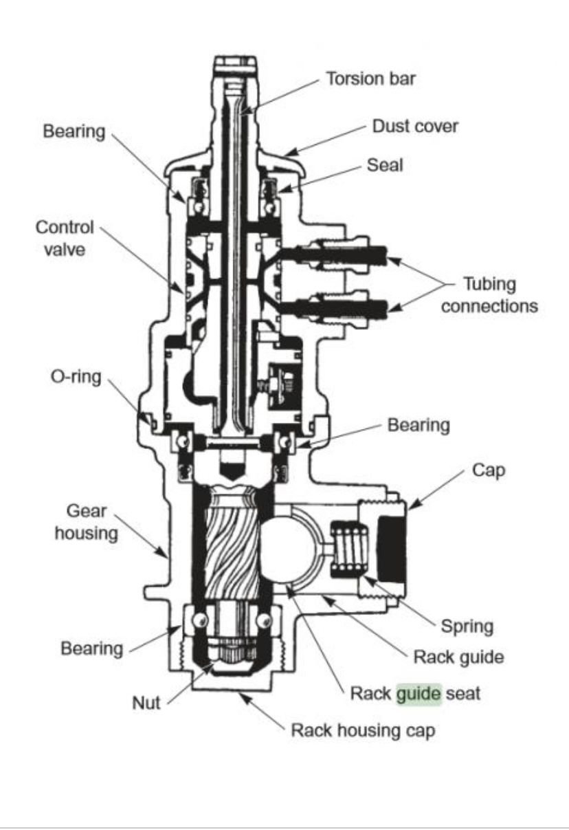

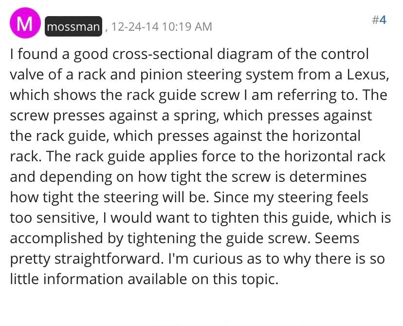

There’s a rack guide plug that increases or decreases steering wheel tension. This can be adjusted on any vehicle with rack and pinion.
Here are a few pics.
This is kinda what mine looks like.
Cut view, see where the guide pad presses against the rack.
General information on how it’s adjusted to create the proper tension.
