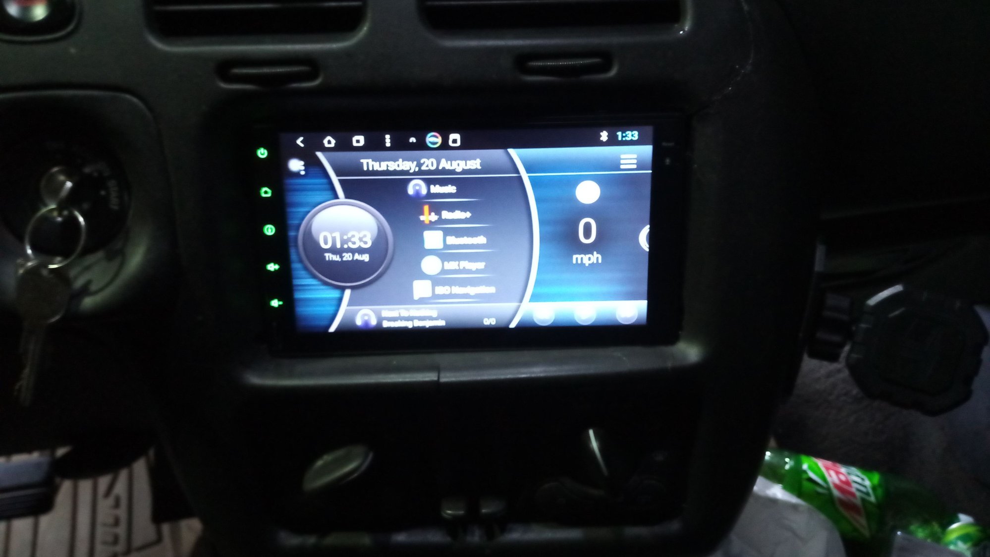

No idea on the OnStar issue as I've never owned anything with it.

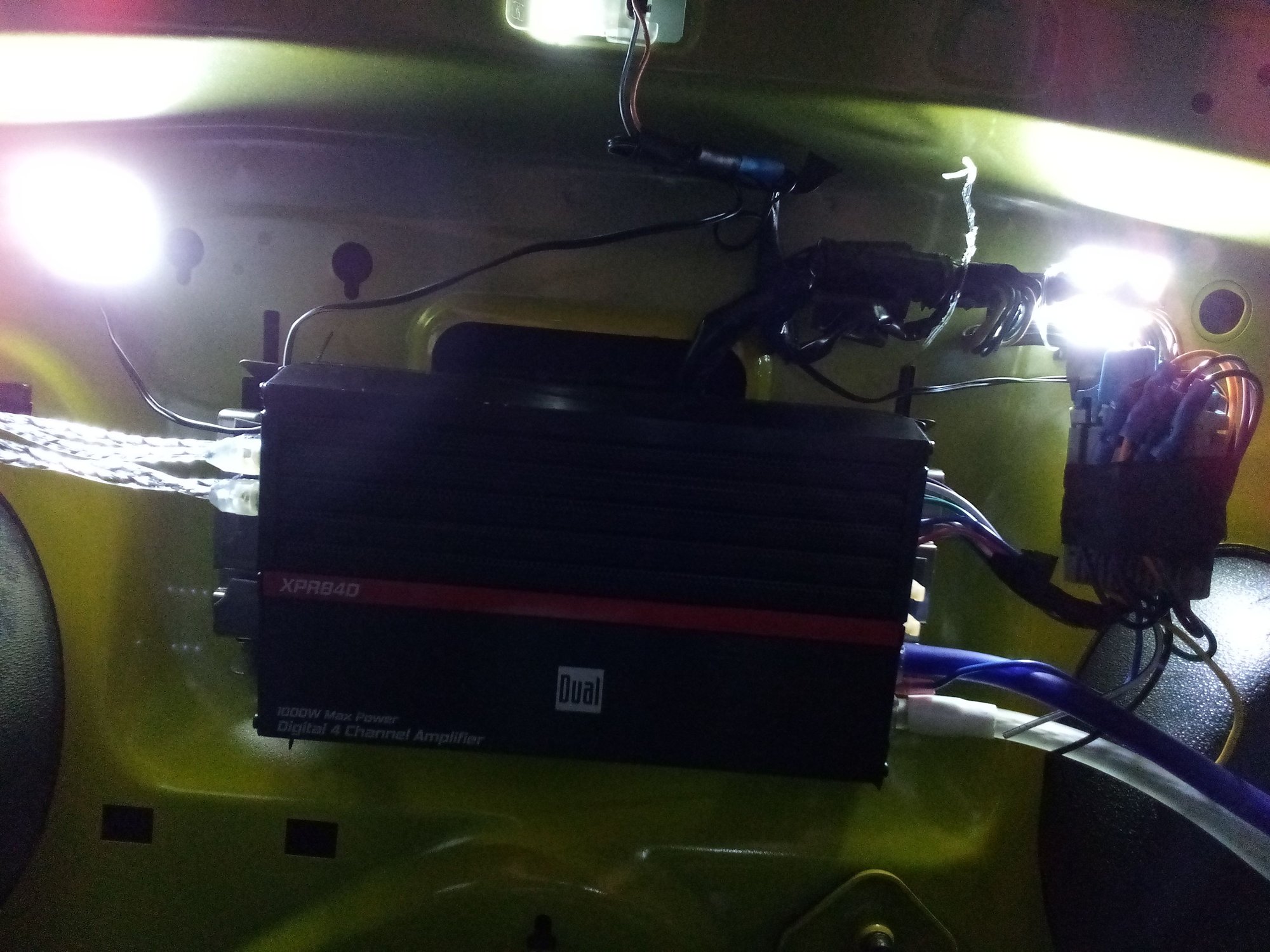

But did replace head unit and factory amp without cutting any factory harness. Repinned the head unit harness adaptor to accept the swc wire to keep those controls. As for amp, used 2 more cheap head unit adaptors and 2 sets of rca cables to wire in amp and place in factory amp tray.
ill try to get pictures tomorrow. Only thing you can see in trunk is 4ga power till I get rear fuse block mounted for sub amp at later date.
Since it sounds like you need a new head unit anyways, have you thought about just getting a model that can support a backup camera / has a decent sized display already?
Probably a bit more expensive route, but then you'd have a nice modern touchscreen deck and not have a nice sized built in screen for the backup.
